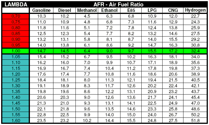

When you say 8.5:1 AF, is that is gas AFR or Ethanol AFR? If you use lambda, it would be easier.
type85
Posts: 155
Joined: Sat Oct 25, 2014 12:07 pm
Location: Los Angeles
Re: Injector sizing
Post by type85 »
ChrisAudi80 wrote:When you say 8.5:1 AF, is that is gas AFR or Ethanol AFR? If you use lambda, it would be easier.
This is A/F for E85
8.5:1 A/F is about .87-.88 lambda
