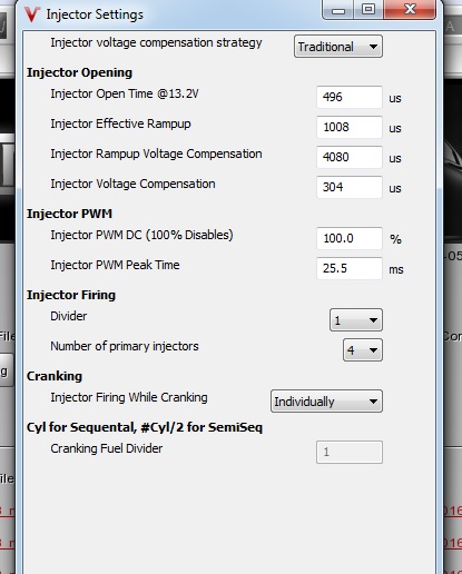

Hi all,
Been searching a lot about this and cannot find the information. I have two spec sheets for the Siemens Deka 630cc injectors, but cannot make out how to use the information. What do I put here as indicated in the picture? Is it correct already?

This is what mine are. They are working well, but might need some tweaks on your car. HTH.
Req_fuel is: 4.6ms.
Req_fuel is: 4.6ms.

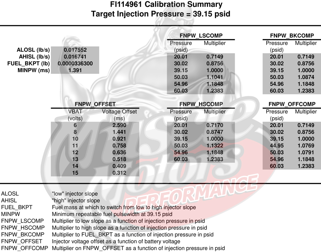

I run req_fuel 5.9 due to E85. How did you get to these numbers? I used the simplified table in VEMS with the numbers sheet from Siemens but the motor ran junk.
I used the attached values for offset, but I guess I needed to multiply by some factor.
- FI114961cs.jpg (349.99 KiB) Viewed 54999 times

Changed my injector effective rampup to 240us, from 1008us. Big difference. Much better injector response that required a complete retune of the VE table had to go 10-20% up almost everywhere.

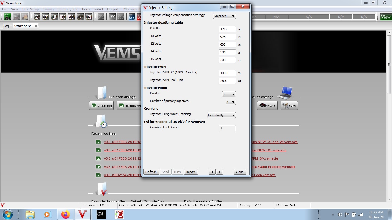

Nah, just go simplified. I have the settings for that.quattrobros wrote:anyone have a known working traditional settings for these injectors?
I'm about to get some but cant find any reliable information.
See attached.
- Deka 630cc latency data 3bar.jpg (182.28 KiB) Viewed 43231 times

Yea looks like simplified is the way to go in this case.
Thanks for the settings!
