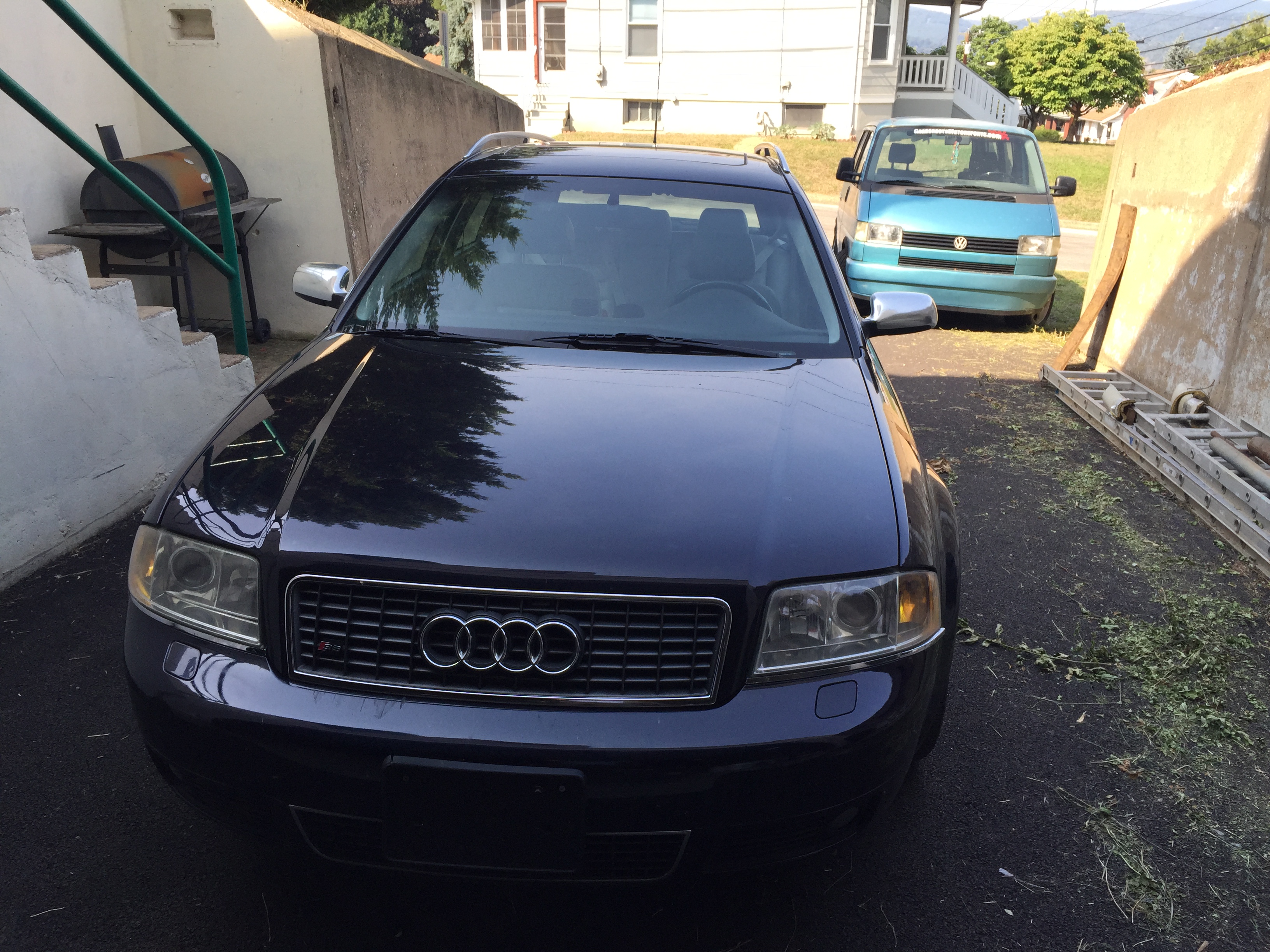

I got this a few weeks ago. It is nice but I need to plan a 6-speed swap ASAP.
Auto trans is doing some weird things randomly.... couple of big clunks like it missed a shift then slams into next gear.... always seems to be in the wrong gear, like every auto trans ever.
Any pointers to a detailed 6 speed swap thread?
