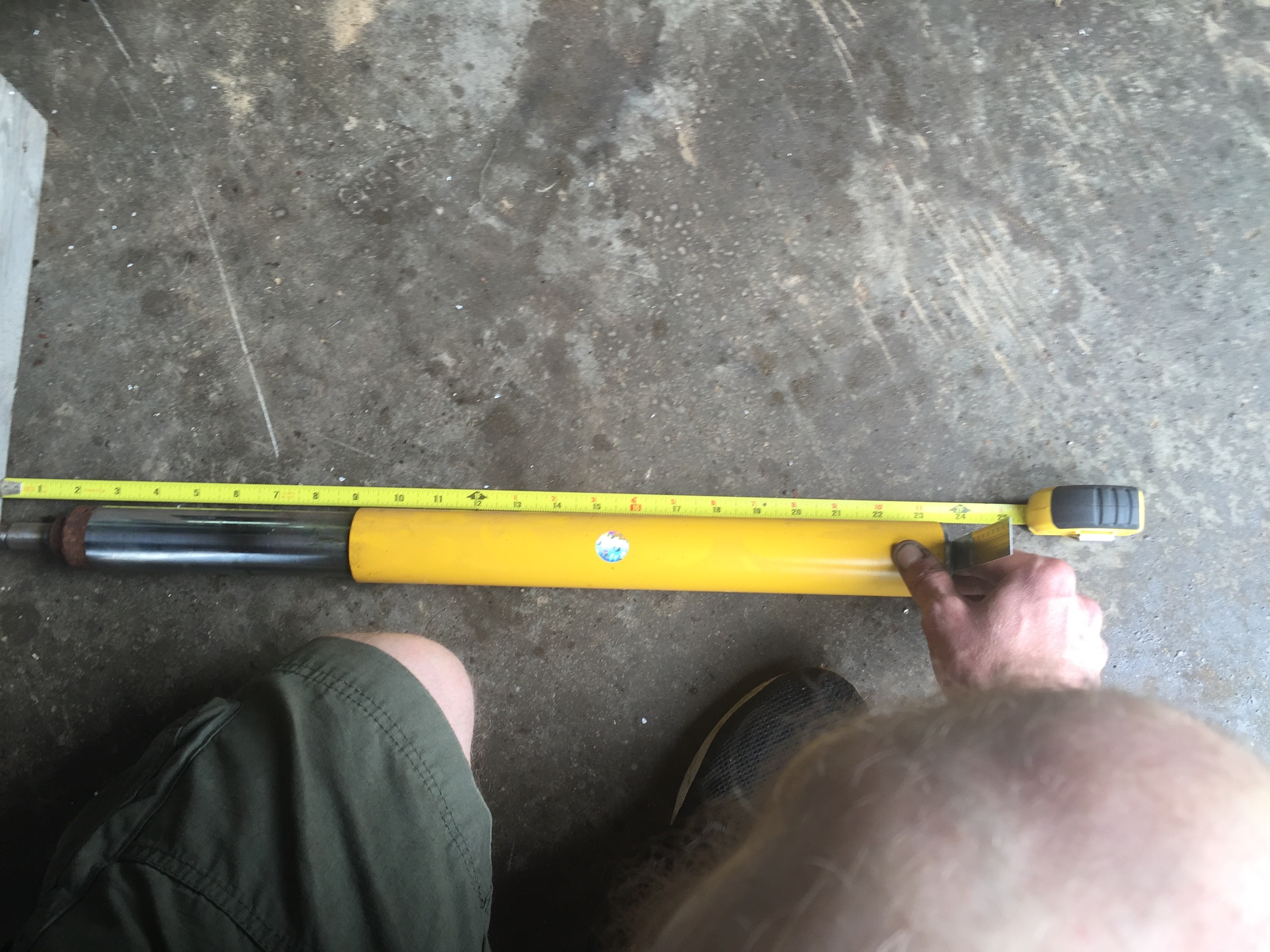

I'll grab some measurements and pics for ya tomorrow. I've got spare b3 stuff here to compare with.

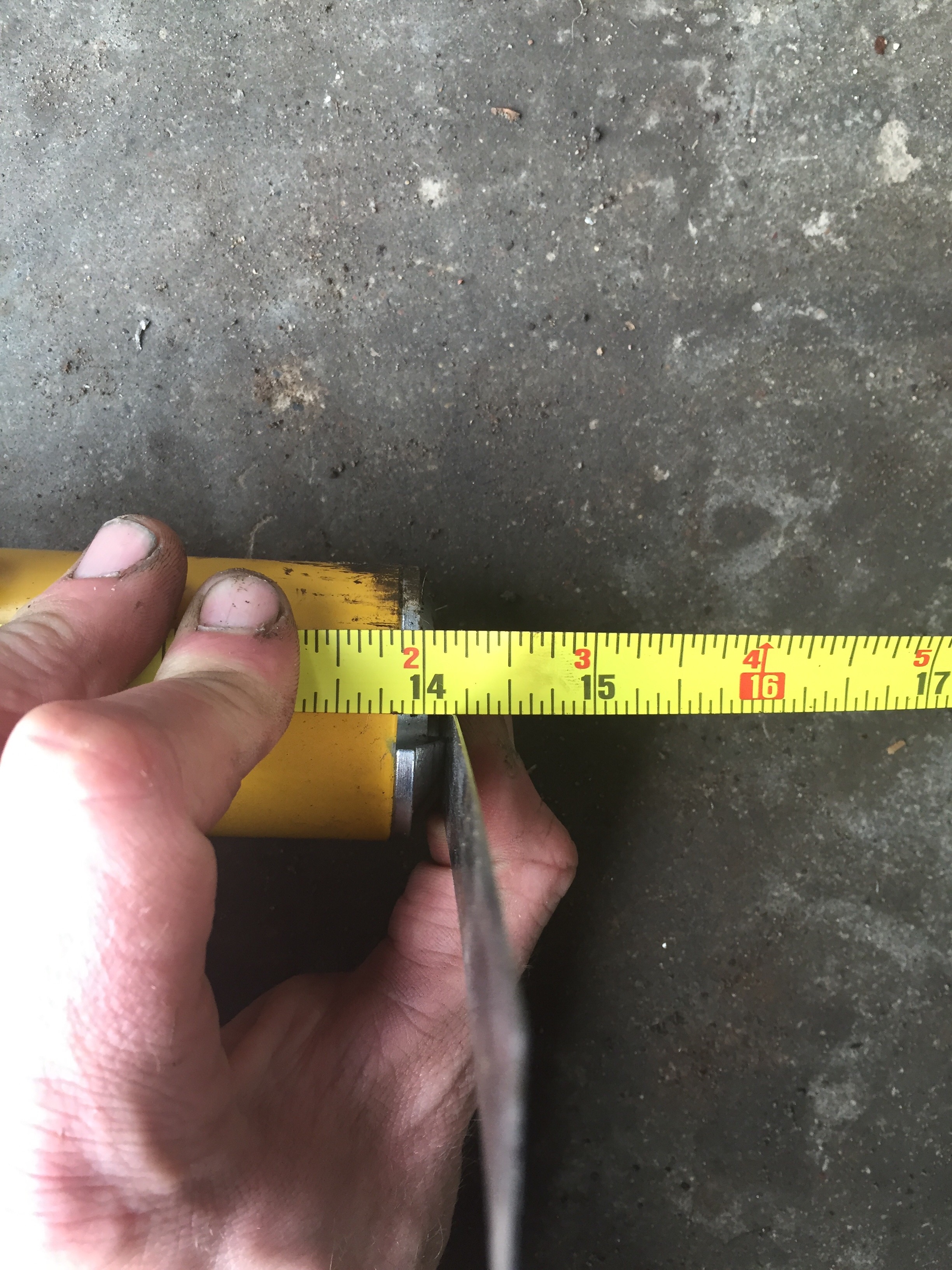

- Shock tube bottomed out...
- image.jpg (1.75 MiB) Viewed 35307 times

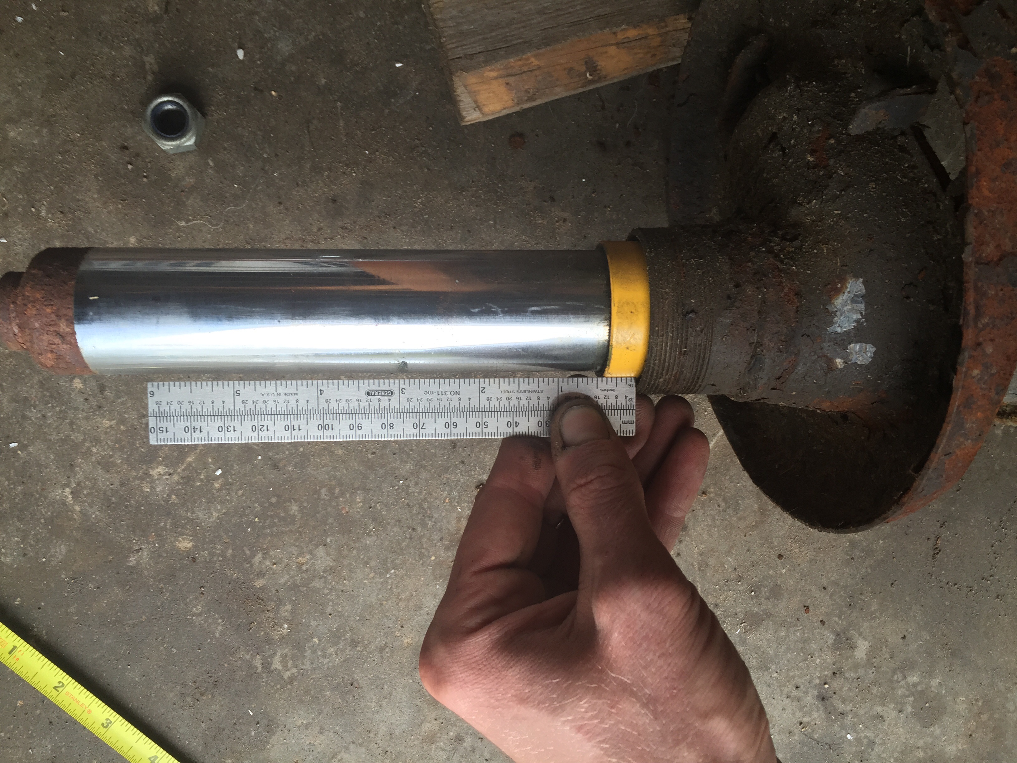

- Shock tube bottomed out in housing.
- image.jpg (2 MiB) Viewed 35307 times
- Shock tube length
- image.jpg (1.7 MiB) Viewed 35307 times
- Total length from pin.
- image.jpg (2.23 MiB) Viewed 35307 times
- Total length, from the pin.
- image.jpg (1.78 MiB) Viewed 35307 times

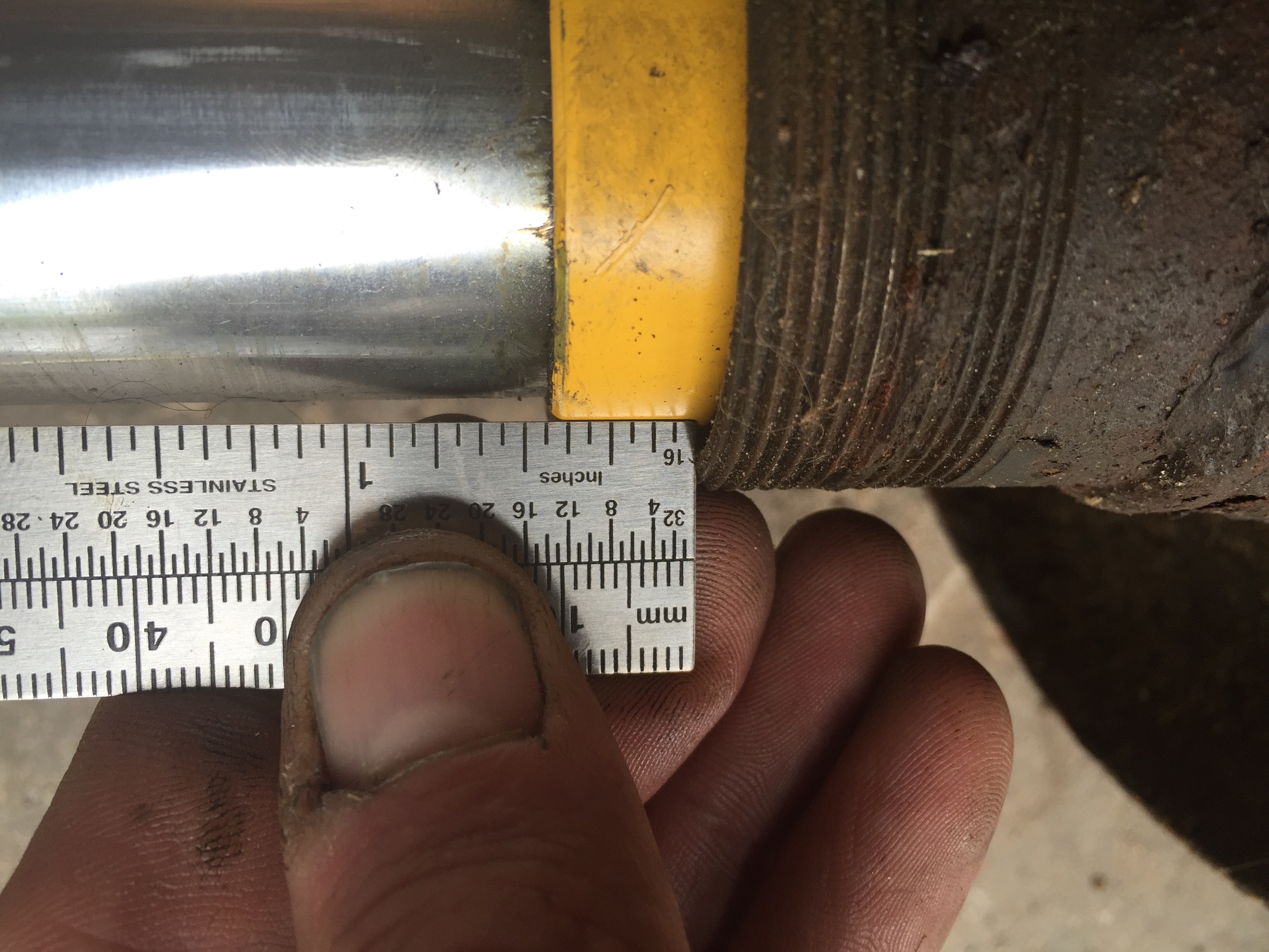

Re: BBSE question
Is that a UrS housing you are showing it stick out 7/16" from?
Re: BBSE question
Yes it is. I put that up because I couldn't find an accurate way to portray through the interwebs, the depth of the cap that screws on. Figured just showing you what sticks out would work easiest.

So, here's something kind of interesting. The body of the B3 bilstein is 1/8" longer, but sticks out of the strut housing 1/8" less. So, to make this work correctly, I need to make the over all housings length 1/4" shorter. Hmm... I'll see what I can figure out.
