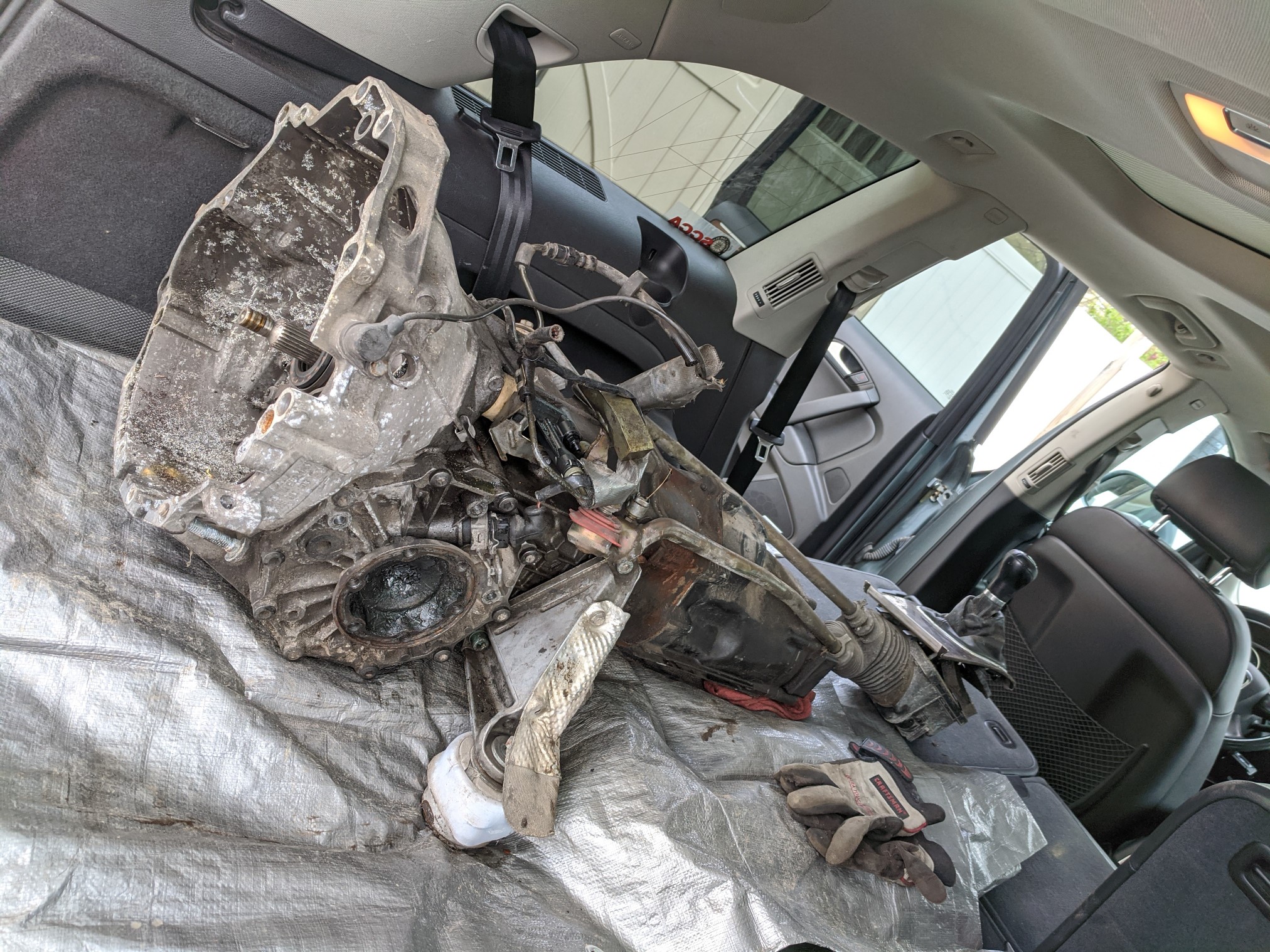

So this happened today...
- 01E 6spd
- 01E.jpg (979.53 KiB) Viewed 188169 times

Yes, I made racecar noises in my head while messing with the shifter.
Re: Eric's V8 CQ
That car makes really really good race car noises too.cuatrokoop wrote:Yes, I made racecar noises in my head while messing with the shifter.
