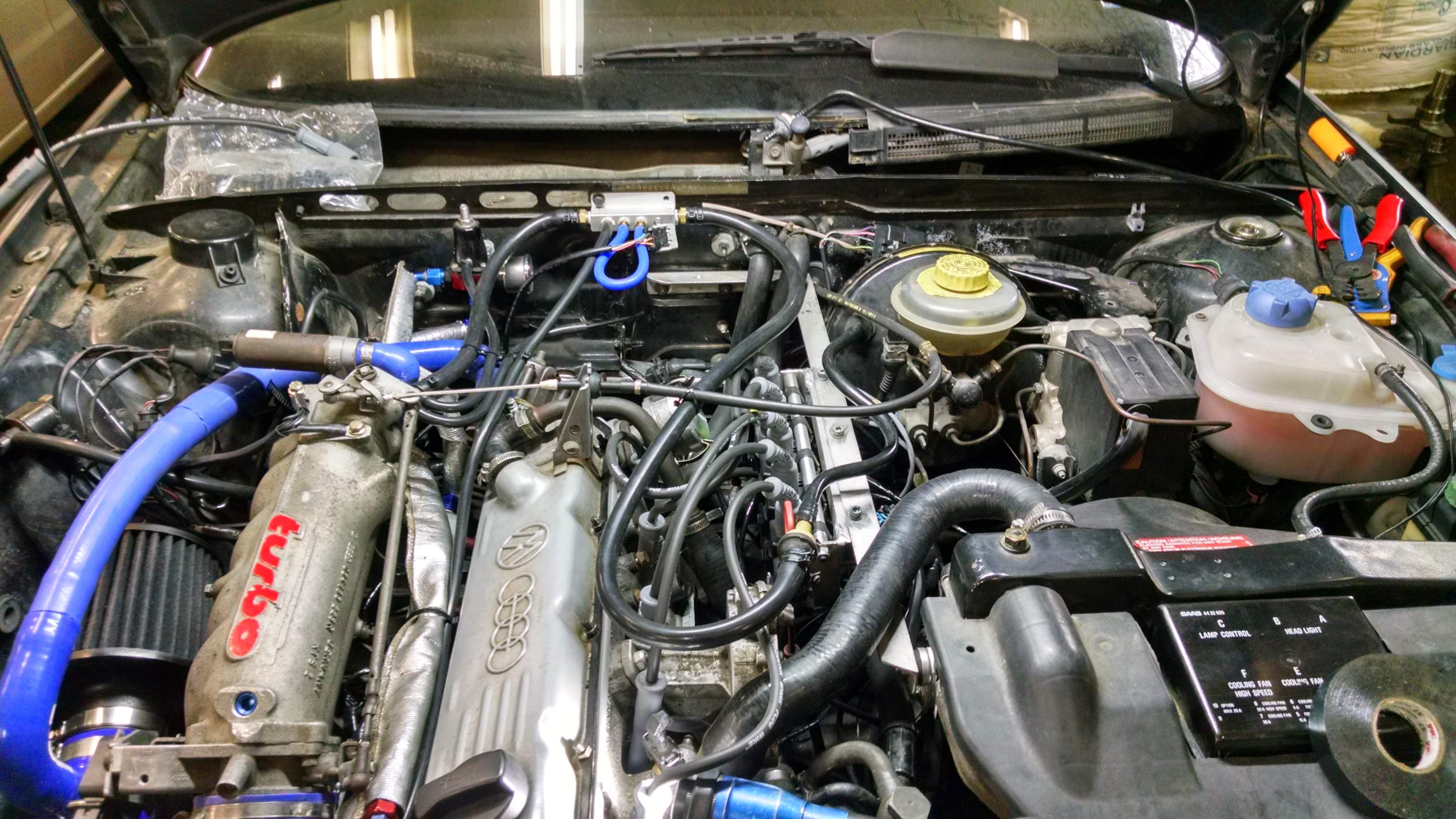

A little more progress over the last two days.
The transmission is in and all associated components hooked back up. Sweet!!! Had to remove both mounts from the transmission. Set the lump on a cheap cart and lowered the car down. Then had the boy fulcrum a 2X4 under it while i lined it up and wrestled it into place. Actually went in easier than it came out. Definitely less greasy this time around.
Since the transmission was in I went ahead and installed the front sub frame along with the gutted cat and mid section of the exhaust. The muffler hangs a little lower than I would like and that is with new rubber hangers. It's not rubbing on the half shaft, so I'll worry about it at a later date. On a side note, once the sub frame was back in I could remove the engine support beam. Its nice having that out of the way.
Next was to get the coolant system plumbed back in. The lower radiator arm mount was about 2" or better pushed back. So out came the 4' 2"X4" and pried the arm away from the sub frame. Replaced the lower ur coolant neck with the 4kq neck and installed an 82c T-stat. Originally when I ordered the 034 silicone coolant hose kit I was planning on running the aux rad, with the oil cooler in it's place that didn't happen. So most of the cooling system is stock 4kq parts. Last to do here is tie in the 200 20v 500w rad fan. I'm assuming it gets its speeds from the resister in the engine bay. I also feel I'll need to relay this bad boy. Why the stock urq has 3 wires im not sure yet since the 500w fan only has one 12v post and a ground.
-I did get the intercooler plumbing figured out. Once I found the other silicone hoses I ordered 2 years ago it made sense. Before I could start to install them I needed to figure out the starter and alternator wiring. Since I moved the alternator to the drivers side like a 4kq instead of being directly in front of the starter. Well I didn't make a note of the wiring orientation, and got a little confused. It looks to me like the battery cable goes to the (+) post on the starter and then jumps from there to the alternator. The (-) on the starter just needs gounded. I believe the small cloth braided wire goes to the trigger on the starter and the small yellow sheathed wire goes to the alternator? Does that sound right to you guys? I didn't end up with a good pick of this, but I can try again if that helps jog anyone's memory.
One last thing I am going to have to fight is the snub mount bracket. With the intercooler, it's piping, and the oil lines from the oil cooler it's going to be really tight there. I am most likely going to have to trim some more of that bracket down and look into re routing my oil cooler lines.
Just one shot of the engine bay coming together. Just need to hook the vac lines up for the booster and cruise. I hope to add fluids next weekend and try to start it!

-PS fluid is in! I have been waiting to mount the tie rods to the strut towers until I got the engine running and pump turning. Since the rack is rebuilt I did not want to damage any seals by turning the steering wheel with a dry system.
-Brake fluid is in, gravity bled till I got fluid out at all 4 calipers individually. Still need to bleed the clutch and get some more air out of the brake lines.
-Fuel is in! Put about 4 gallons of 91 in. Unfortunately it looks like I am going to have to pull the fuel tank. There is a small amount of gas coming through the floor right above the rear diff. :(
-Put the battery terminals on and then the jump pack on them. I would turn the key on and get dash lights for a couple of seconds and then they would shut off. I am guessing the battery is just completely shot. Took the terminals off the battery and directly to the jump pack. Cranked it a few times and she fired up and then died. Did this a couple times until it stayed running. It does not idle very well, but I was able to run the throttle a little bit and it sounded healthy. I am hoping it just needs ran some to get the idle back. Still need to go though some of the vac lines, but could not really hear any leaks. Must have oil pressure as I went from the full line on the dip stick to the low line. I did dump some oil into the oil cooler lines and into the top of the turbo.
-My jump pack did get a little warm after I ran it a few minutes to the point where the jump pack gave a temp light. A buddy suggested the voltage regulator might be bad. So I will change that out and hopefully can get a meter on the car the next time I go to start it. That is if I can get it to stay idling.
-There is one wire I can not figure out where it goes. It is sitting just under the coolant neck here. It is brown with a green stripe. Here is a pic, this is the newer style MC coolant neck and I am not using any of these sensors on it as of yet. The WX neck has no sensors in it.
I am not too worried about the crappy idle yet. I still need to tune the car up. What spark plugs do you guys suggest? I have new plug wires, just need the plugs, cap and rotor.
That is it for now. Hopefully I will have time to mess with it at the end of the week.
-Removed oil cooler and IC with hoses after test fit to clean up my cuts, also resprayed the front tow hooks and the bottom 1" lip of the front sheet metal as it was chipped to hell. Turned out pretty good, got a color matched rattle can. Wasn't cheap, but the color match seems pretty good. I would't use it on the body anywhere though.
-While the paint was drying I cleaned up the caliper carriers and then installed the brakes. I will be going to the 225hp TT calipers at some point so I did not paint the front brakes.
-Once paint dried I was able to reinstall the oil cooler lines, IC, etc.
-Then hung the a-arms and sway bar. Tried to use new later style center sway bar bushings but they just do not fit right. Had some beat older style ones laying around so I tossed them in for now.
-Tied in some vac lines, does the small vac nipple off the wast gate not go anywhere?
- Also tied in the vac line for the brake booster to the back of the multi port fittings off the back of the intake manifold.
-Still need to tie in the vac lines for cruise. The line going to the cruise module T to the pedal is split at the pedal and hard as a rock at the T.
-Added fluids! coolant is in, had a leak at the freeze plug turbo fitting, just a loose hose clamp thank god.
