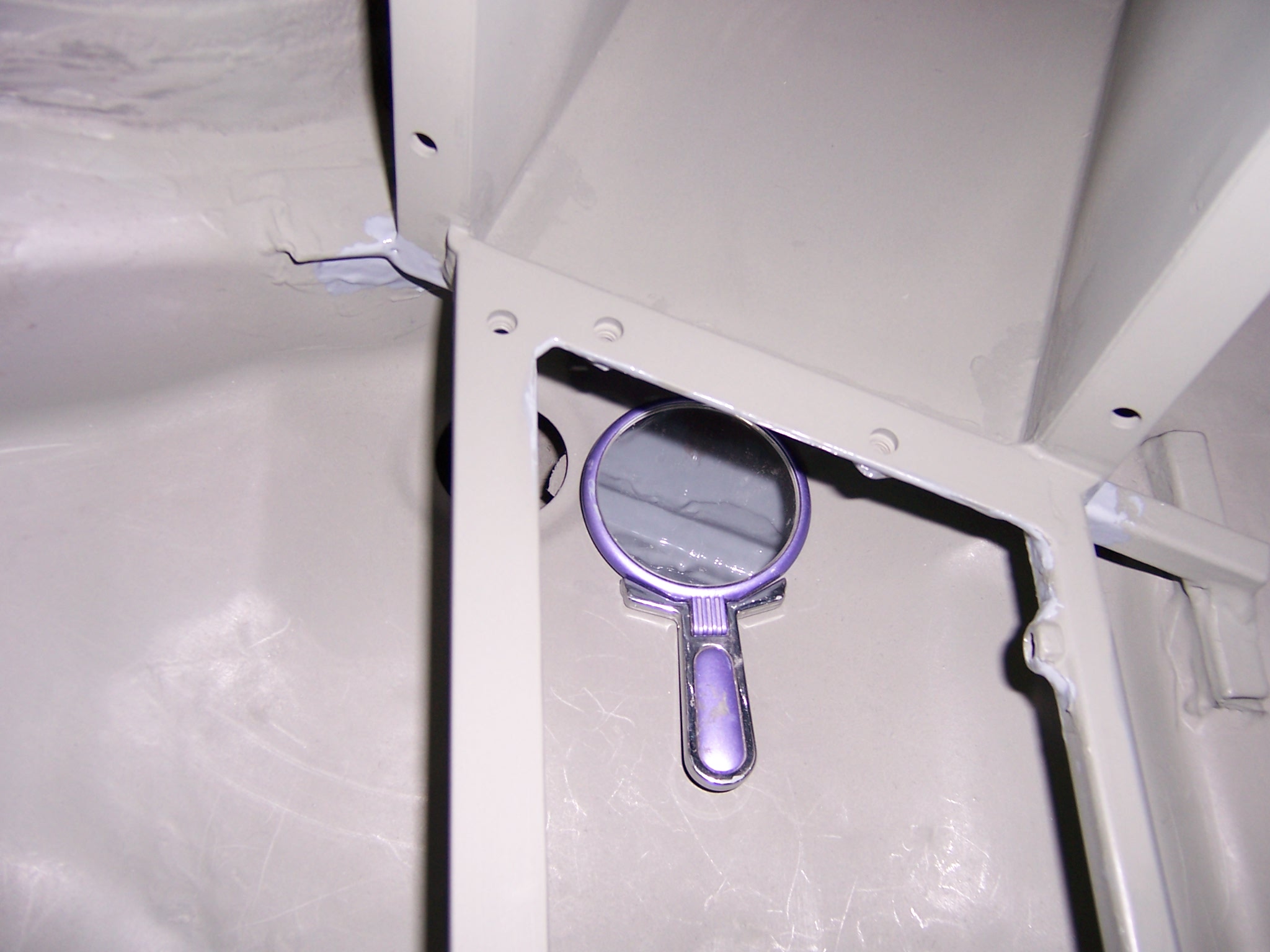

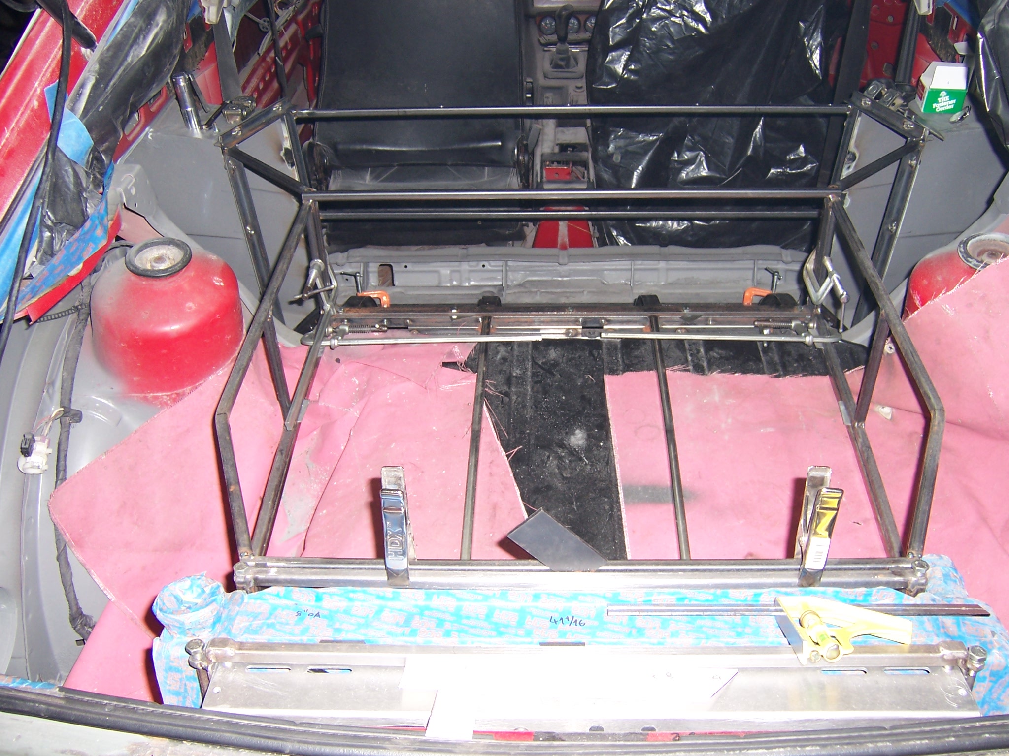

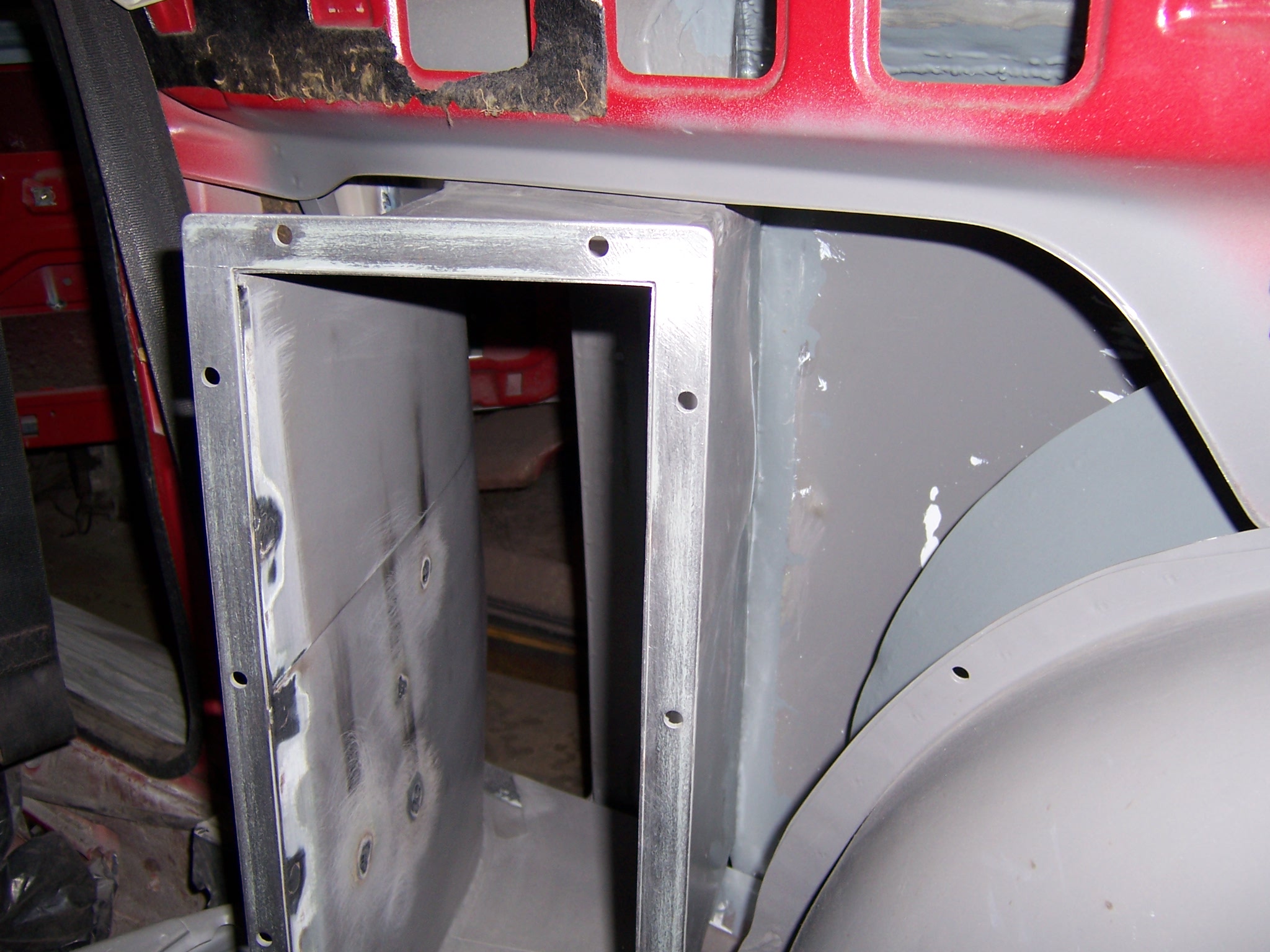

Made some angle frames for the rad intakes on the inside of the car and welded them in place. Also made mates for these frames with nuts on the backside and after these where bolted in the car started to connect the dots.
Inside View
Inside View

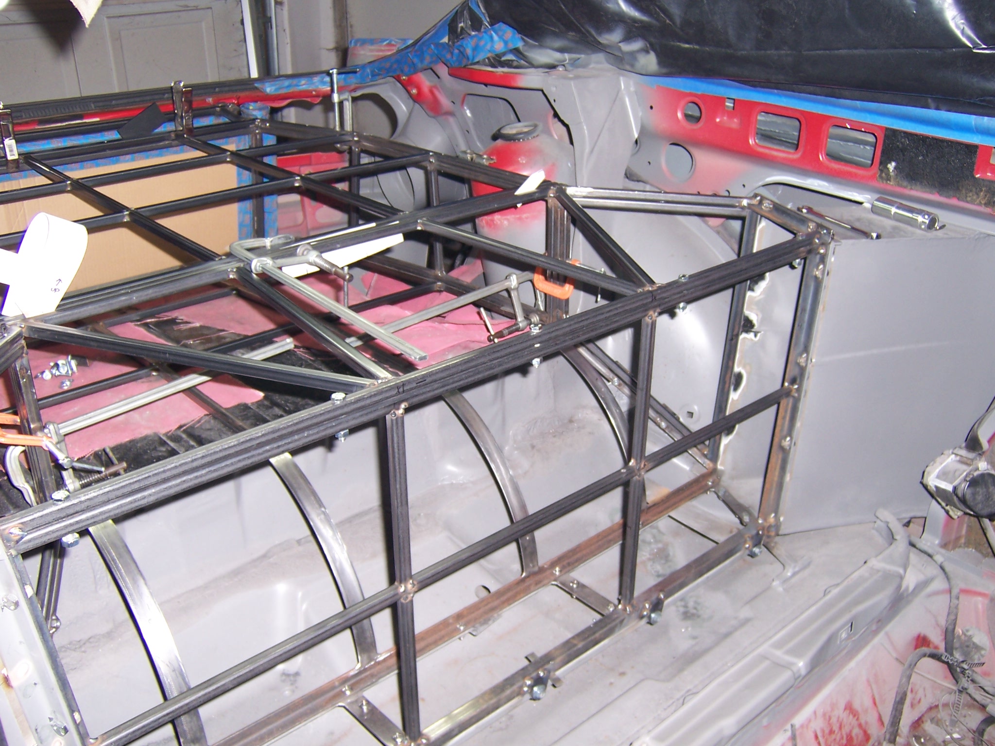

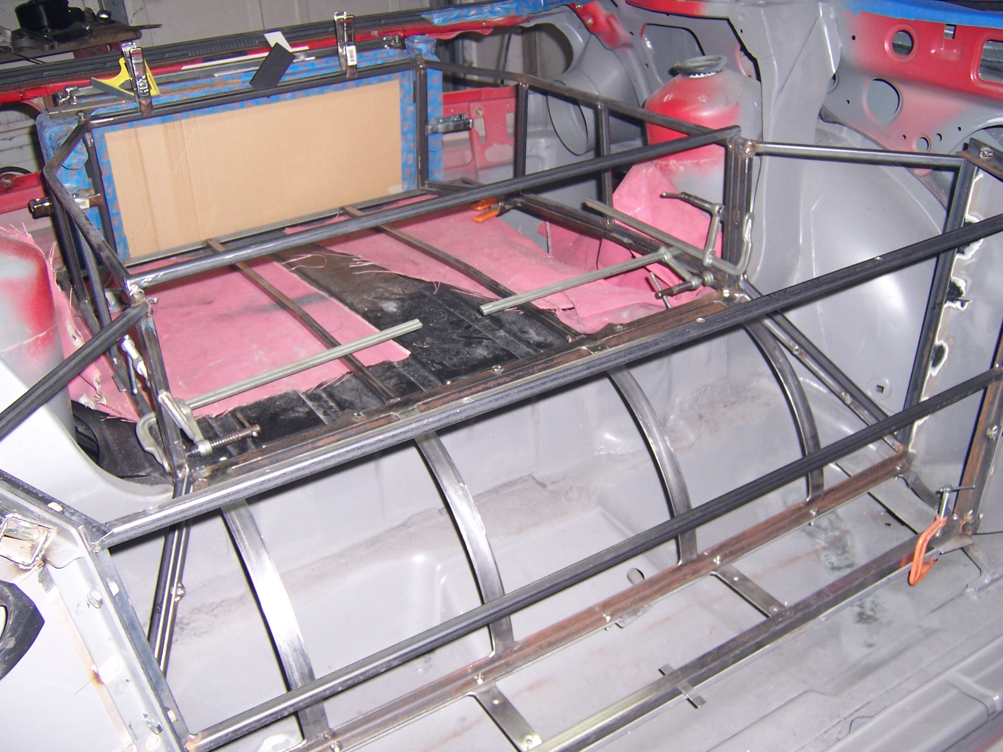

Made tops for the Rad. ducting , added cross bracing and mounting holes/tabs.
Next the have to come out for welding and grinding. Then the pieces will get straightened and clad with sheet metal. Then paint and reinstall plus seam seal.

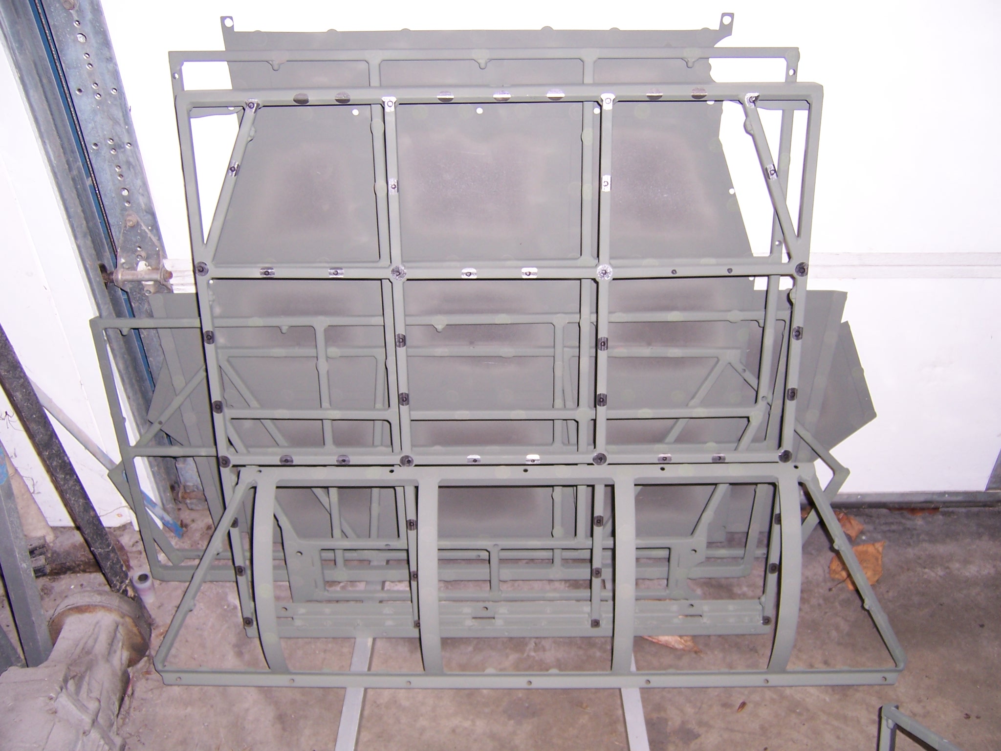

Took the Rad. ducting frames out of the car and added tabs, holes/nuts where needed. Welded everything and ground all the joints. Then made sheet metal parts to weld on the frames. Lots and lots of sanding some primer
and once the sheet metal is welded to the frames they will get sealed primed and painted. Then they get bolted back in the car and all the bolted joints other than the top will get sealed as well.

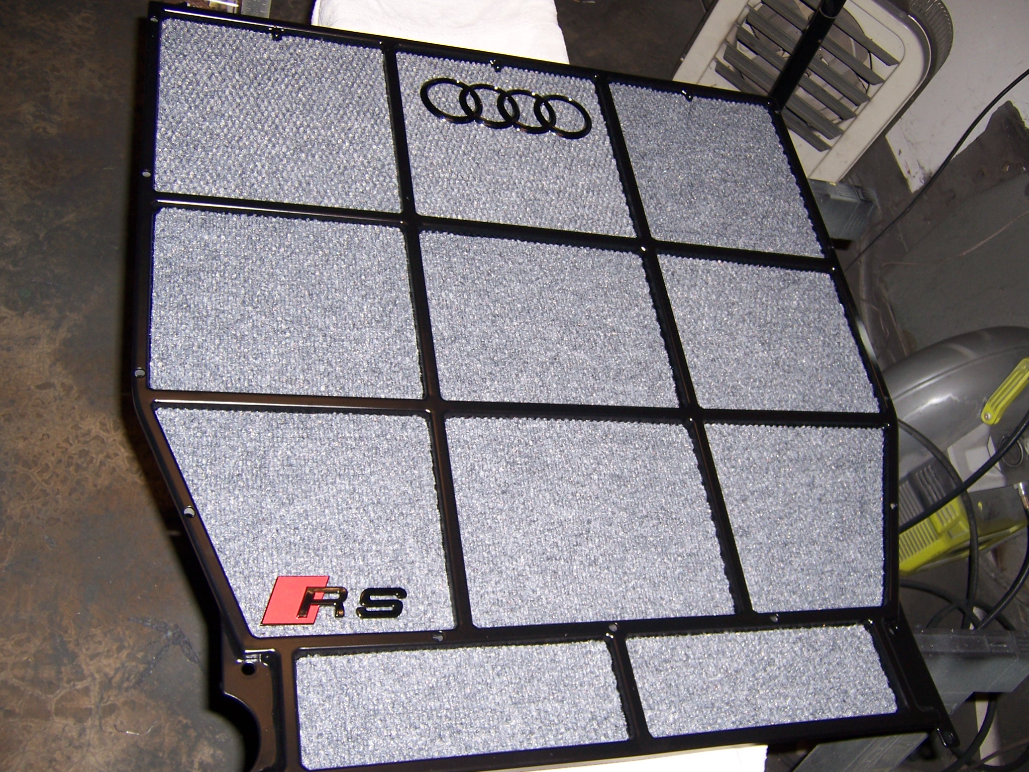

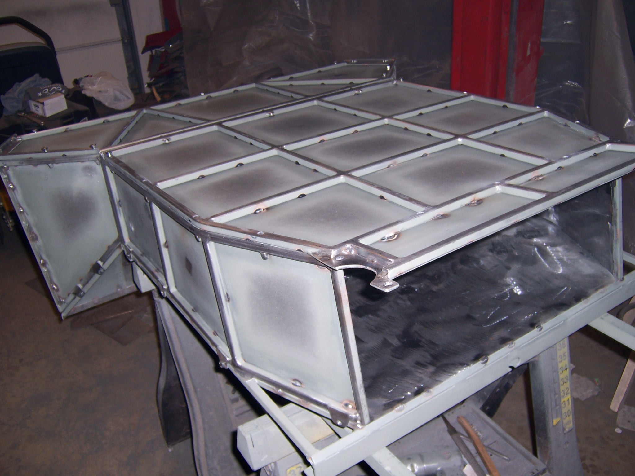

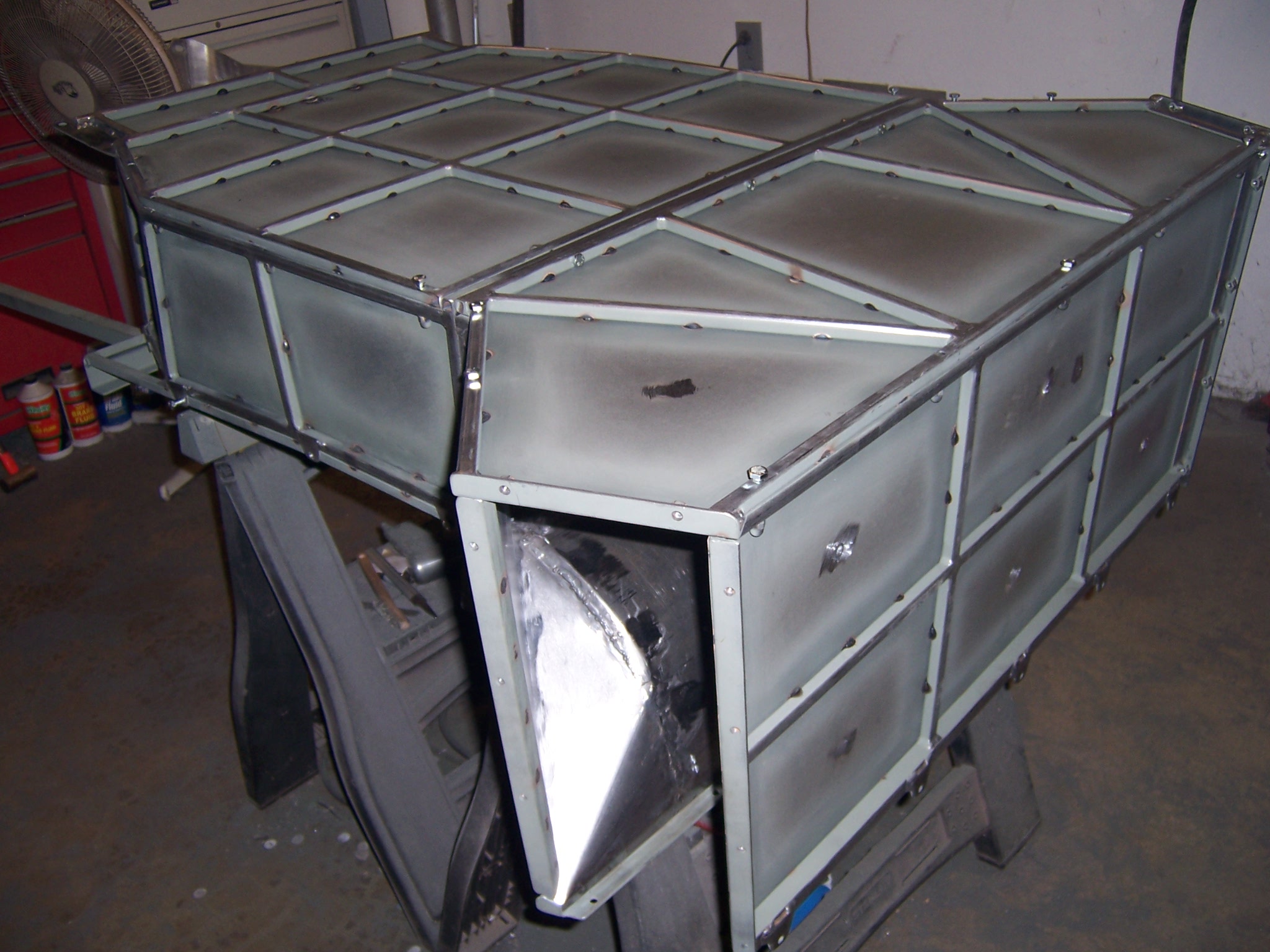

That all looks like this now ready for more primer, seam seal and finish paint. Bolted all the parts together to check fit and make final adjustments. I swear this ducting appears smaller in the car.
Intake side
Radiator side
Intake side
Radiator side
Mike
That should help get some weight in the rear
Yes , Since the point was made and I was curious myself. The parts weight in at 91 LBS. and are all seam sealed plus primer. Why the chair???????? Next time car needs to move I will weight the rear seat and see whether the difference is positive or negative.Mcstiff wrote:That should help get some weight in the rear
Last areas to be sealed and prime/paint
Then finish paint the rest of the ducting and reinstall in car.

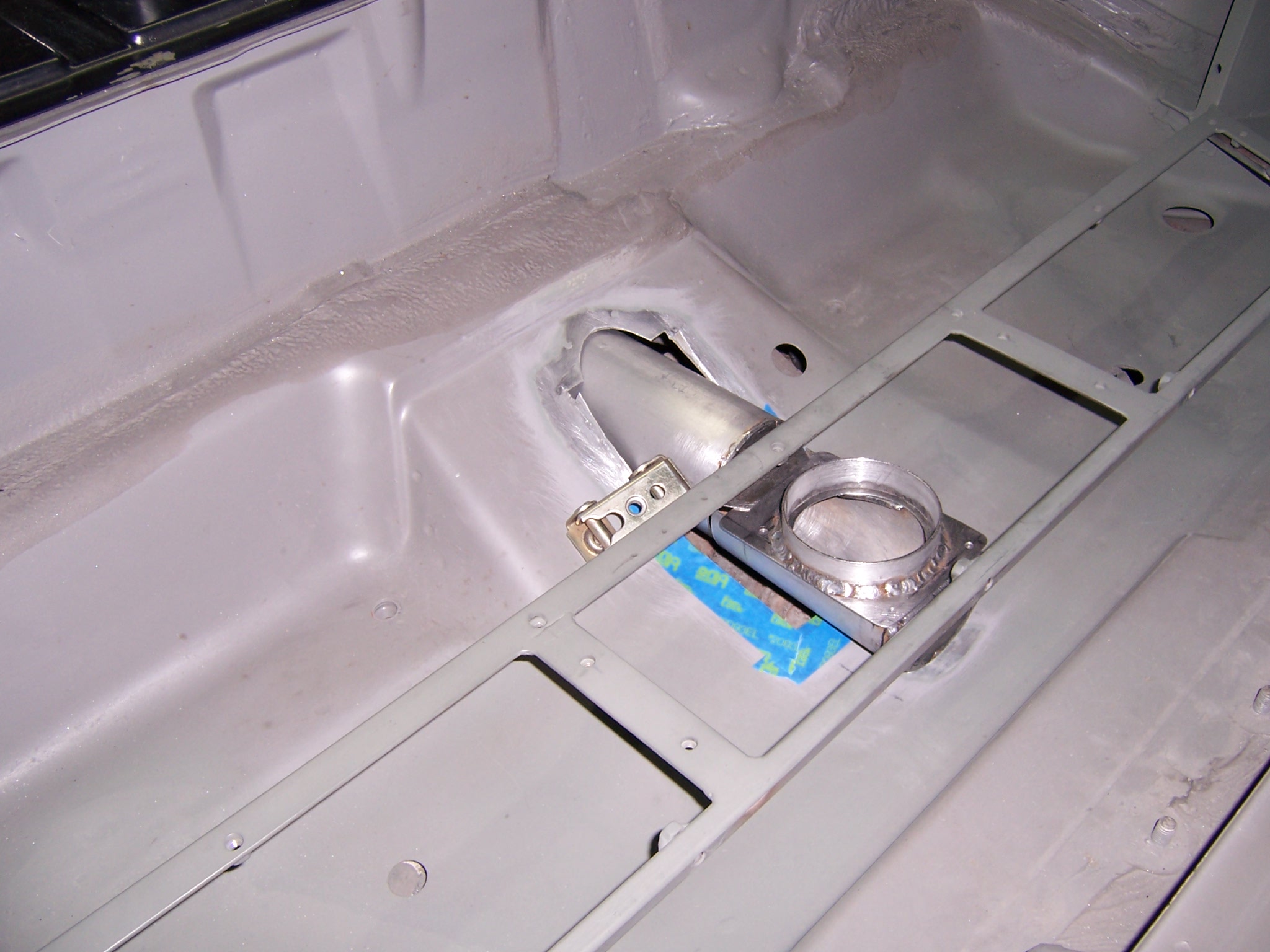

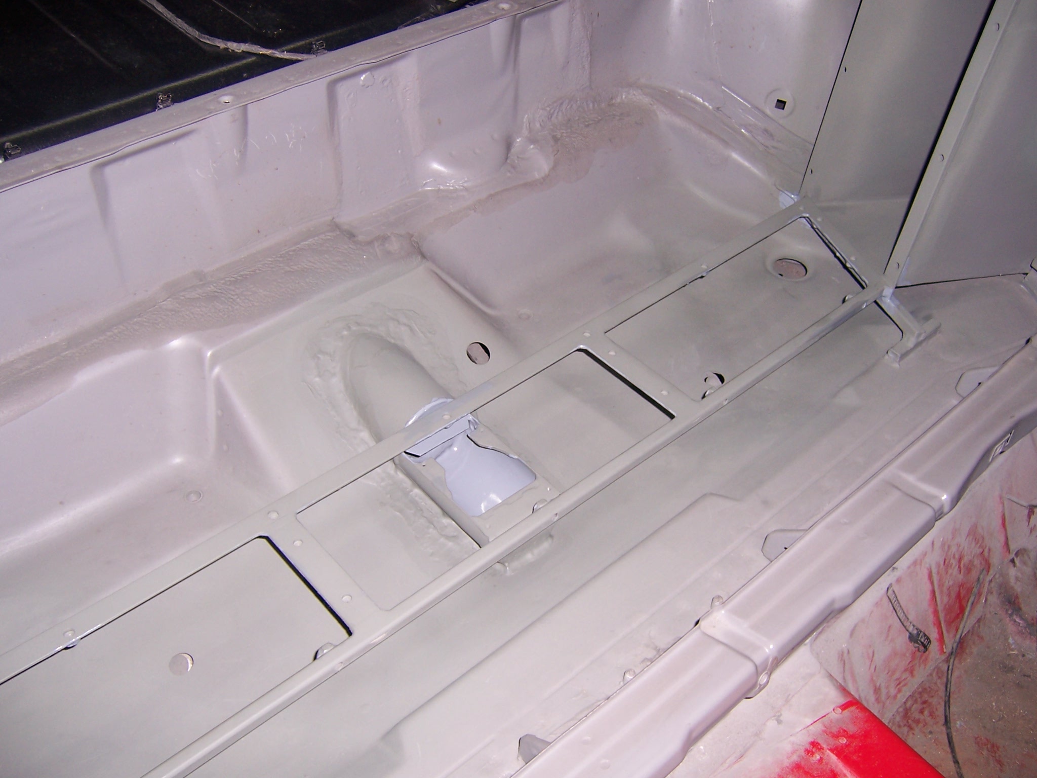

While working on the rear ducting floor piece and looking at water drainage needs. I decided on a rear diff. cooling vent that doubles as a drain. One new hole in the car and a three piece tube later.

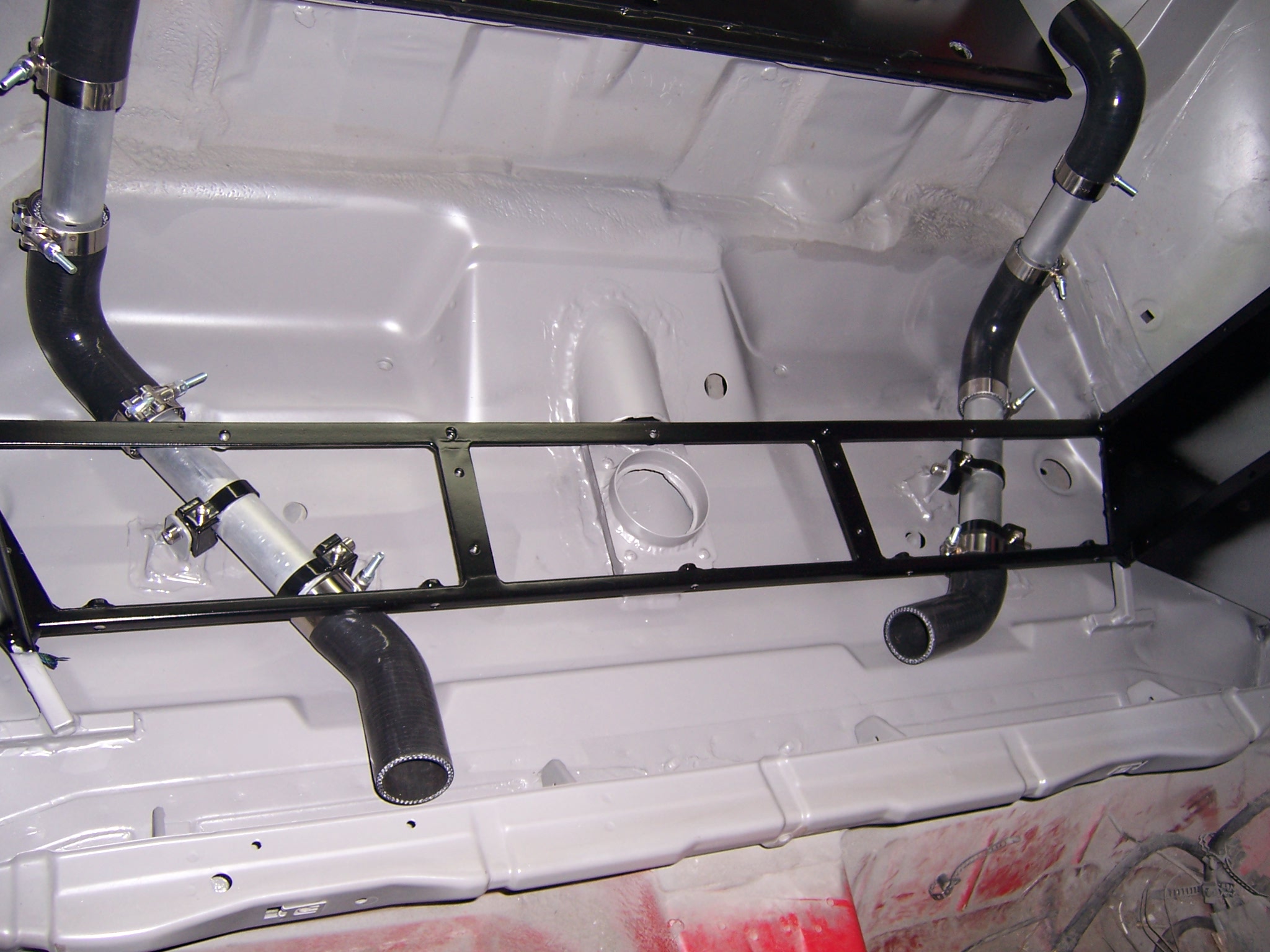

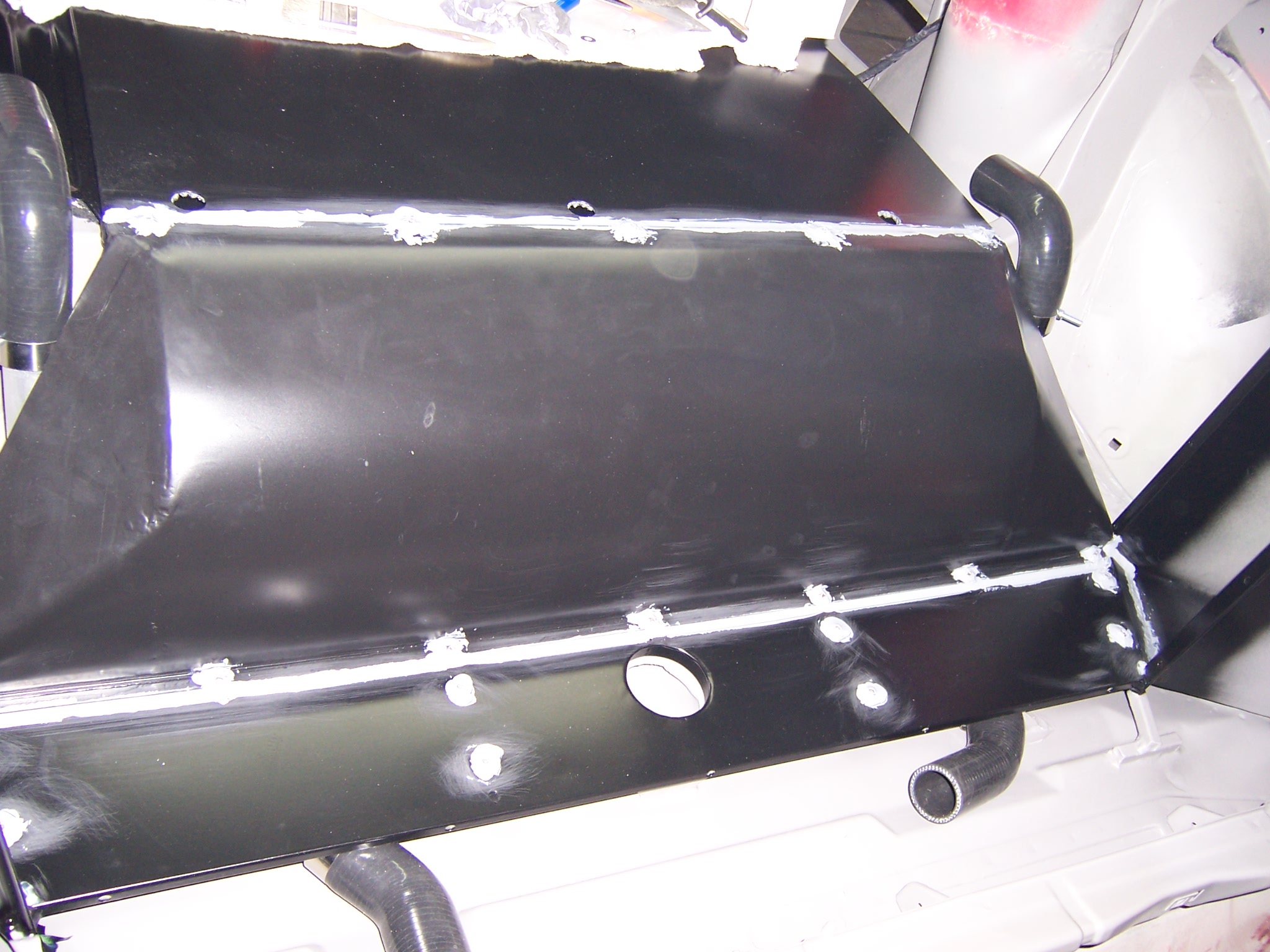

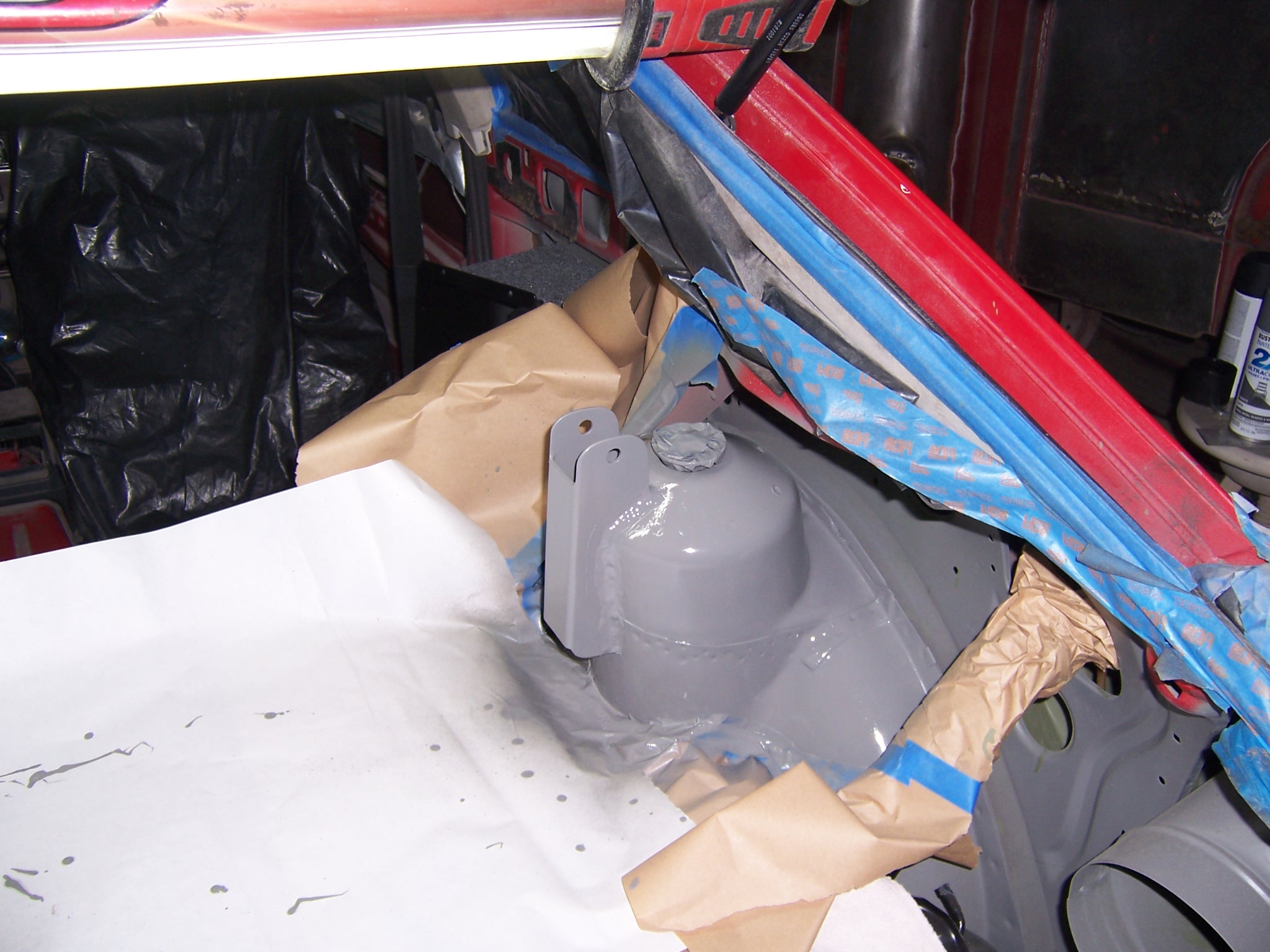

Before the rear ducting floor was reinstalled in the car one last time, some plumbing needed to get done to carry the water to and from the radiator. That meant more brackets, welding, prime/paint, seam seal etc.
Plumbing done in areas that get covered
And ducting floor back in the car plus seal seam
Plan is to get the ducting sides installed over the tank area so I can locate the rear strut tower bar and get that made and welded in. Once all the sides are back in the car they will get sealed and then some rubberized undercoat should keep the water out.

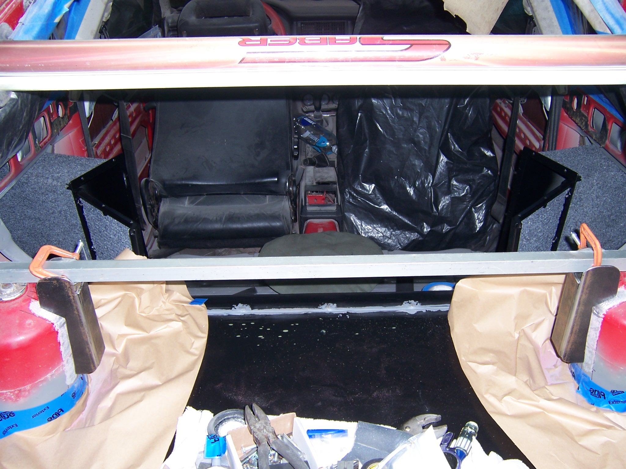

After more painting of weld seams inside the car, I glued some outdoor carped on the ducts inside the car as well. Started making parts for the strut bar after that. At this point I have all the parts made that I need plus hardware for the bar. Some trimming and cutting to length and a few holes left to do and that will get welded in. After that some more radiator plumbing and final install of rest of ducting.
Mocking up parts for strut brace

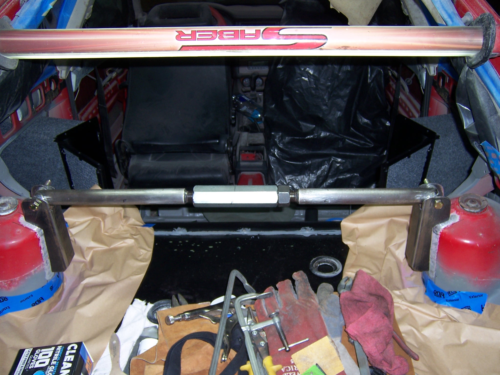

Finished fabrication of the strut bar and getting ready to weld the mounting brackets to the car.

That strut bar looks pretty beefy, and it's cool that it's adjustable. What's the measurement side to side that you're looking for?
I've been wanting one for years, but don't want to sacrifice the rear cargo room with the rear seats folded down.
Thanks PRY4SNO
Yes that strut bar turned out to be heavy duty, but that was the goal. It was made adjustable to ease install after everything is welded (brackets, strut bar). Also it is my understanding that these strut towers are rather weak, so if I crank the adjuster hard, +/- 2 deg. should be available if needed. This would only be done after all other hardware is maxed/limited and as a last resort. Not looking for a specific side to side measurement. Unless someone has some secret measurements they would like to share, bar goes in neutral and I will go from there.
I feel you on the cargo room, but that's a mute point on this car. I have not driven a car with strut bar front or rear so plan is to run both ways to experience the difference. I did have a 1rst gen. rabbit/golf that i made a bar for to tie the front suspension under the car together. That mod. was such a huge change in handling and turn in of the car that when i get another one , that's the first thing i will do to the car.

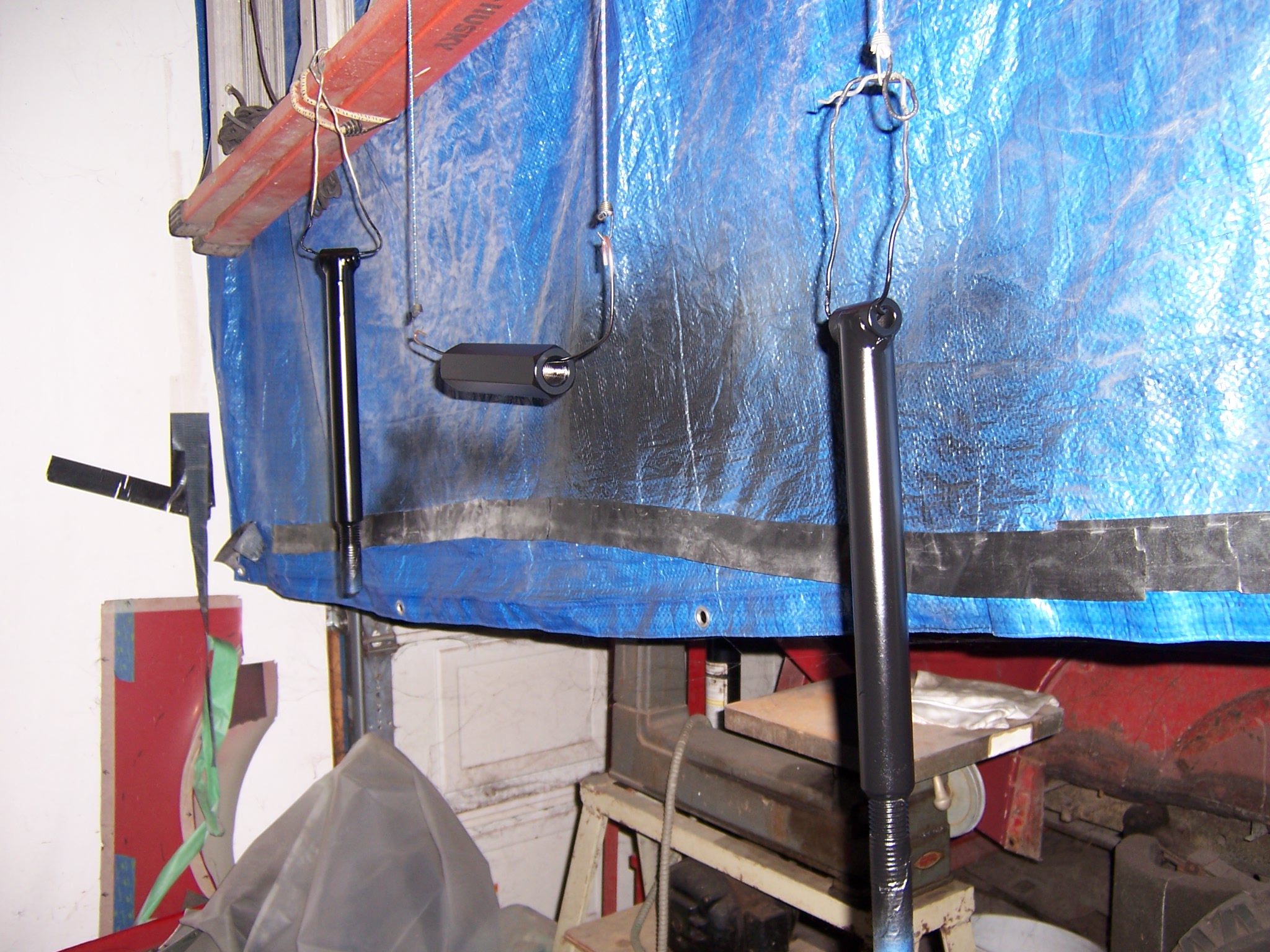

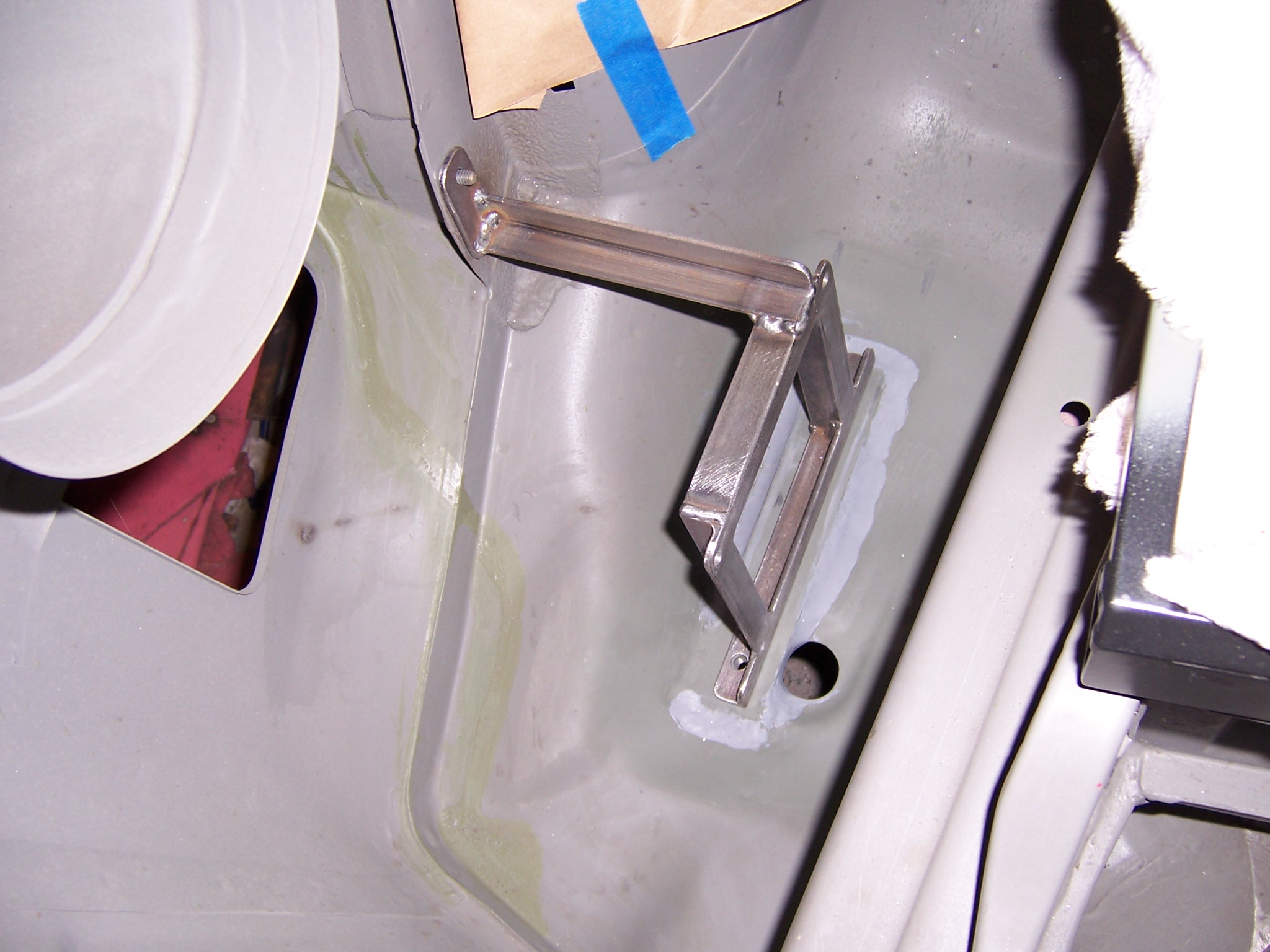

All welded up and primed, seam sealed and first coat of paint.
So because I wanted to know if the strut towers would move by turning the adjuster on the bar, after welding the brackets I grabbed it with my hands and twisted.
With just my hands I was able to move the towers +/- 1/8" to 3/16" for a total of 1/4" to 3/8".
Don't know if that's allot or hardly anything at all, but the movement involved with just my hands was a lot more than expected.
Bar drying

that rear bar is a must - I worked on a body repair CQ and got an appreciation for how little horizontal metal there is in the rear - the panel behind the taillights isnt the heaviest gauge metal and I think its spot welded with seam sealer. No wonder the hatches need constant adjustment to stop squeaking.
themagellan wrote:Can't wait to see the finished project - thanks for the updates.
Thanks and yeah about that wet noodle thing. I wish I had video of my face and body language when I twisted the adjuster. I don't notice it but people that have seen this tell me that the look of disappointment is genuinely amusing and unmistakable ......the german wrote:Sweet! That bar is a beefcake.
Coupe Quattros have the chassis rigidity of a wet noodle.
Thanks for the info: You are correct about the taillight panel. Steel is the same thickness as the rest of the car and only spot welded and seam sealer. Now mine has a few big holes in it.Peters wrote:that rear bar is a must - I worked on a body repair CQ and got an appreciation for how little horizontal metal there is in the rear - the panel behind the taillights isnt the heaviest gauge metal and I think its spot welded with seam sealer. No wonder the hatches need constant adjustment to stop squeaking.

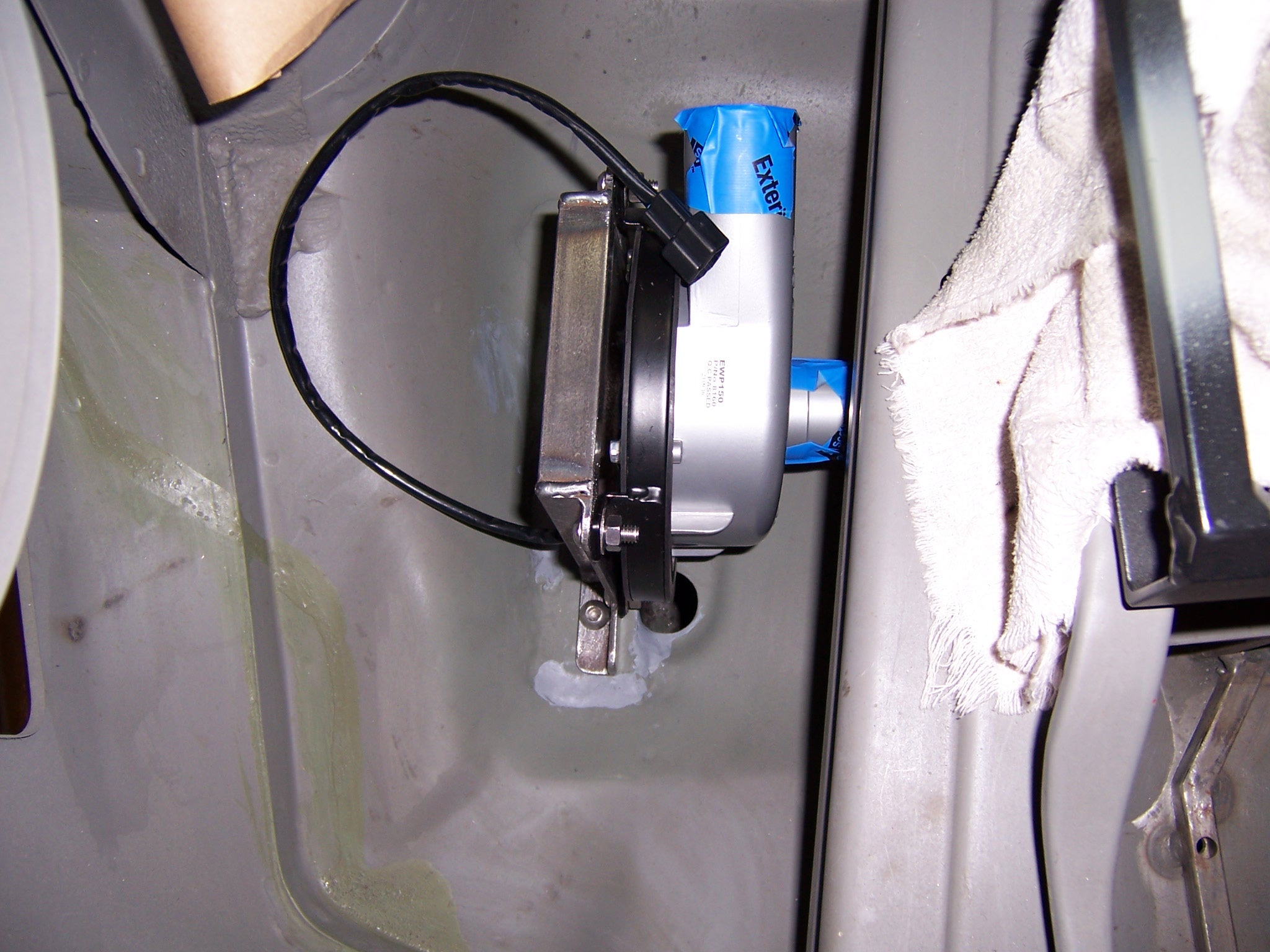

Made mount for water pump and mounted that at the lowest point in the system right after Radiator.
Final version
Also did some priming of the last areas that where still bare metal on the rear of the quarters/fenders so I can do the last of the seam seal as well. Trying to get the rear all done and sealed. Then turn the car around and finish the front. Cant wait to see the car from a distance, last time the rear wheel arch was not finished. Should look different.
