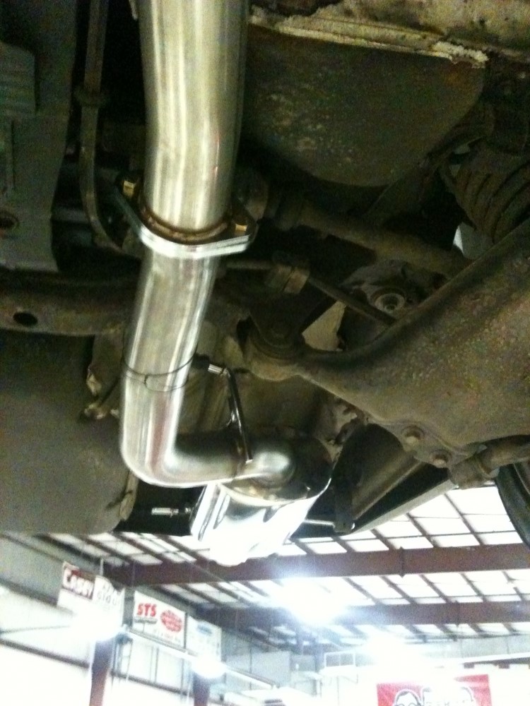

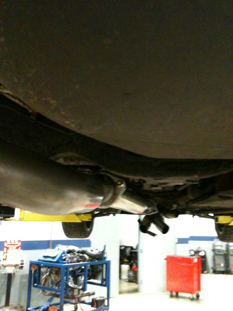

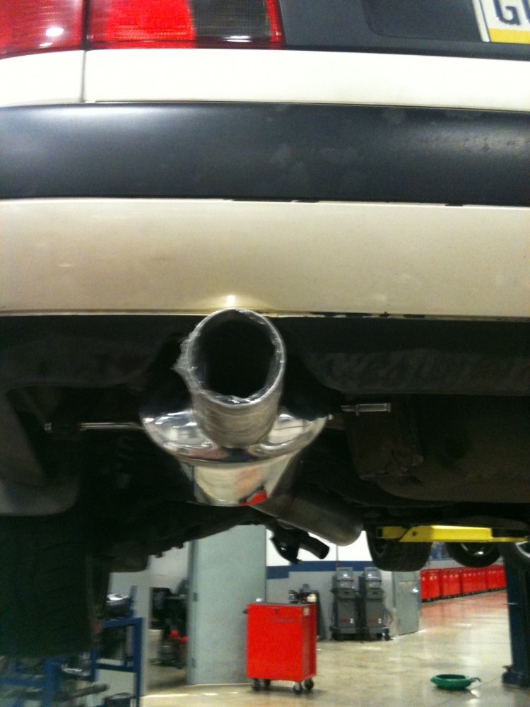

In an effort to get you into a decent exhaust, I recommend one of those 2003 2.0 Turbo WRX jobs that UrS guys can make fit... I'm not sure if C3 chassis would accept it though...
exhaust 001.jpg (184.66 KiB) Viewed 97075 times
exhaust 003.jpg (144.22 KiB) Viewed 97075 times
exhaust 004 (1).jpg (162.36 KiB) Viewed 97075 times
Re: Magellan's 1991 Audi 200 Quattro 20v - Spring 2015
bumper exit spot on t44 and c4 look to be very very very close, everything else under there should be the same.

mushasho wrote:In an effort to get you into a decent exhaust, I recommend one of those 2003 2.0 Turbo WRX jobs that UrS guys can make fit... I'm not sure if C3 chassis would accept it though...
TANABE EXHAUST GOOOOOOOOOOO
mushasho wrote:Nice to see how giving you a little sh!t has motivated you ... now... while you were there, did you do what I think you did with that last minute hiccup we encountered?...
Haha!!!! You know me way too well....
The exhaust looks really amazing, I'm going to look into the wrx stuff but ultimately will probably contact you for the turbo back contact (in the meantime I might come up to visit our friends with a few glass packs for a sticker) :hide: as there are some better investments happening on the car right now :)
