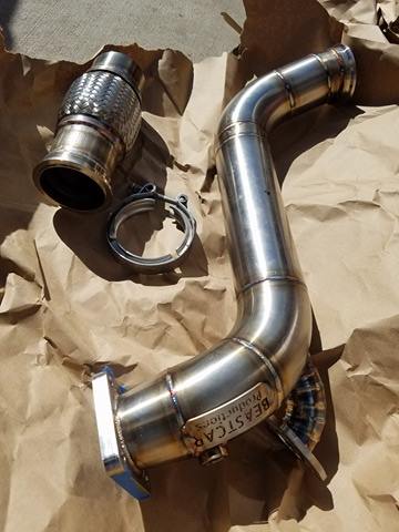

as for the quality:
¯\_(ツ)_/¯
project 2226
Posts: 2144
Re: Anyone ever use DrBeastCar ?
I'm not sticking up for him, but I don't know if I would call that shit work Chris. Maybe it's hard to tell from the pictures, The worst thing I can see is a couple of joints that are not perfectly aligned?

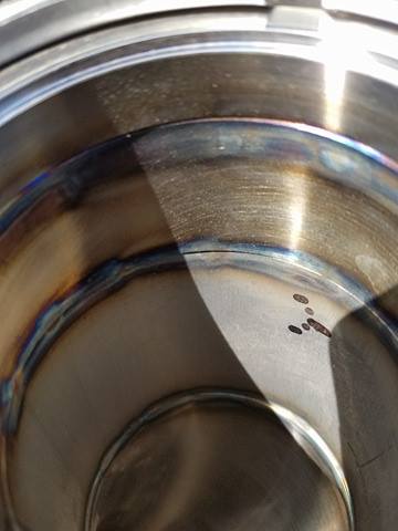

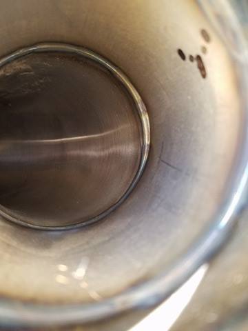

Are you kidding Jim? Or maybe you don't understand what's inherent in a good, strong weld. There is nowhere near enough penetration on those welds. That truly is shit work.
No excuses are necessary here and they should never be made for any product which doesn't state the shortcomings up front or fix the problem right away.

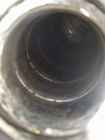

Dead serious. Looks like every aftermarket exhaust out there. It's not the space shuttle. Looks better than my shit with sugar hanging off the inside.

It would be cool if someone who is formally trained to weld would fill us in becAuse now I'm curious. Those welds look really good from the outside, much more consistent than mine, the fit up looks good, piping is clean before welding .
Curiosity got the better of me and I tried one myself , but I don't know what I'm doing .
This is with 1/16" rod and good fit up . No matter how little heat I try and put in I still have some of that heat coming through to the inside . But maybe that's just because it's not back purged?
Yeah that looks like sugar to me... back purge will help.
Are you using a 1/16" gap, or a tight fit up?
