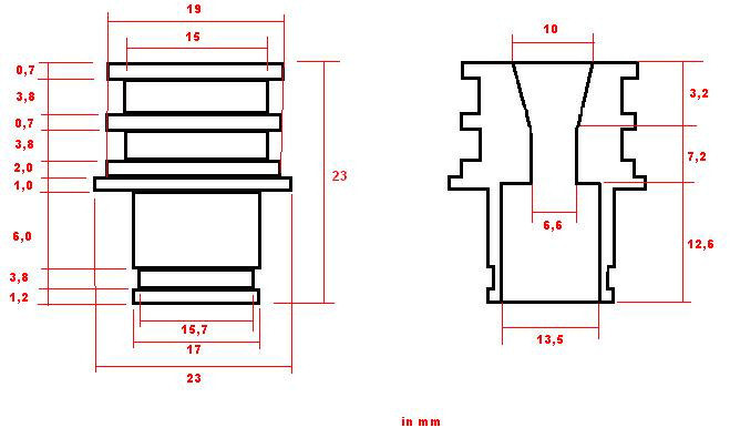

Multipurpose O-Ring, Oil-Resistant Buna-N, 3mm Wide, 14mm ID
http://www.mcmaster.com/mv1460752213/#9262K271

varia wrote:Multipurpose O-Ring, Oil-Resistant Buna-N, 3mm Wide, 14mm ID
Thanks for Varia, but I need 14mm OD, 8mm ID. I really think the one's I ordered off Amazon will work well, they come in tomorrow.

what i posted is for the 034 adapters.
¯\_(ツ)_/¯

0ooo, gotcha!
thanks for this little pseudo-drawing of the adapters! For the o-rings from the adapter to the fuel rail, I just ordered those straight from 034, fitment is nice and they were cheap (since I was ordering other stuff too...)
got the amazon o rings in last night but didn't have a chance to check fitment. This weekend.
