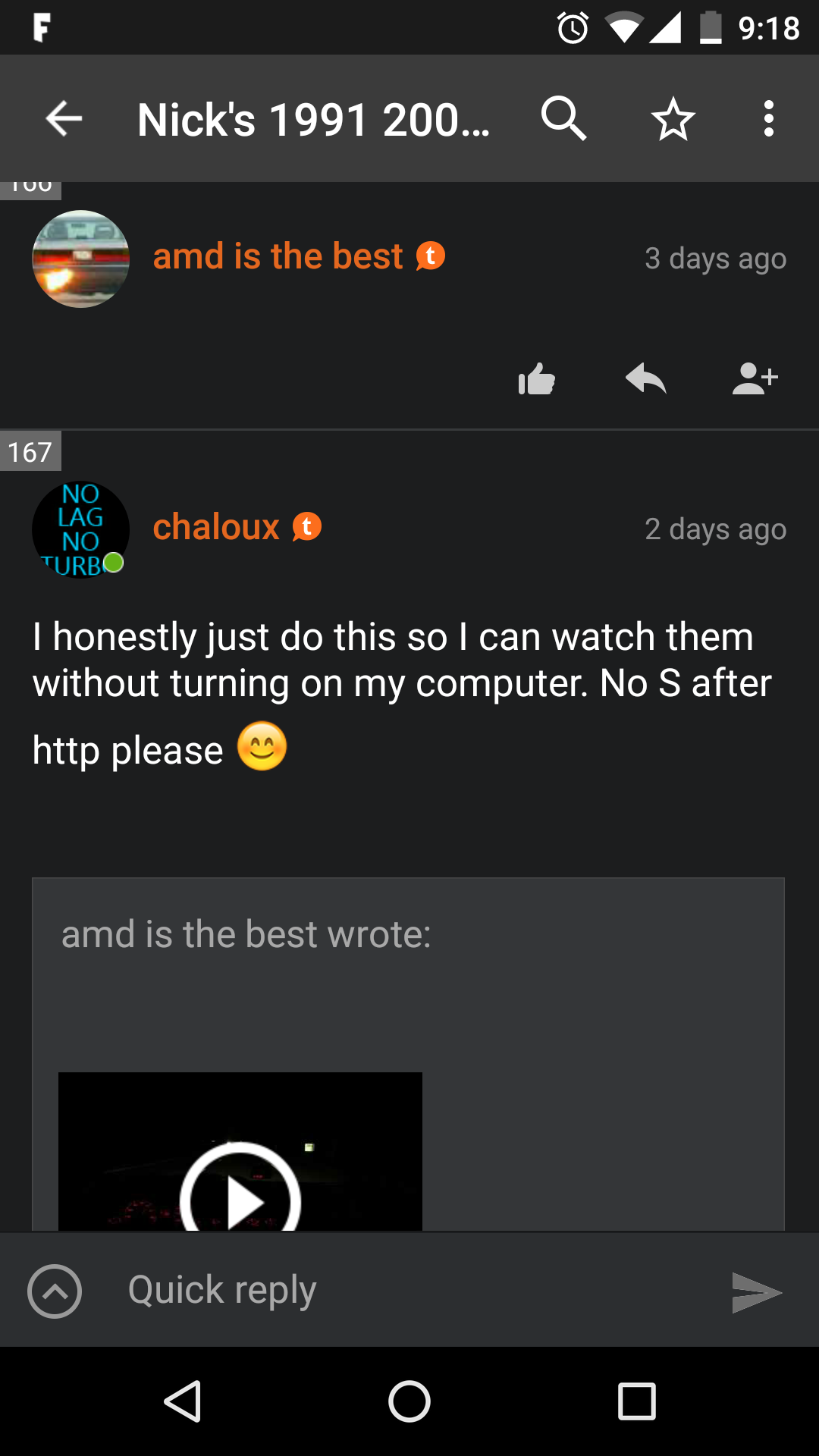

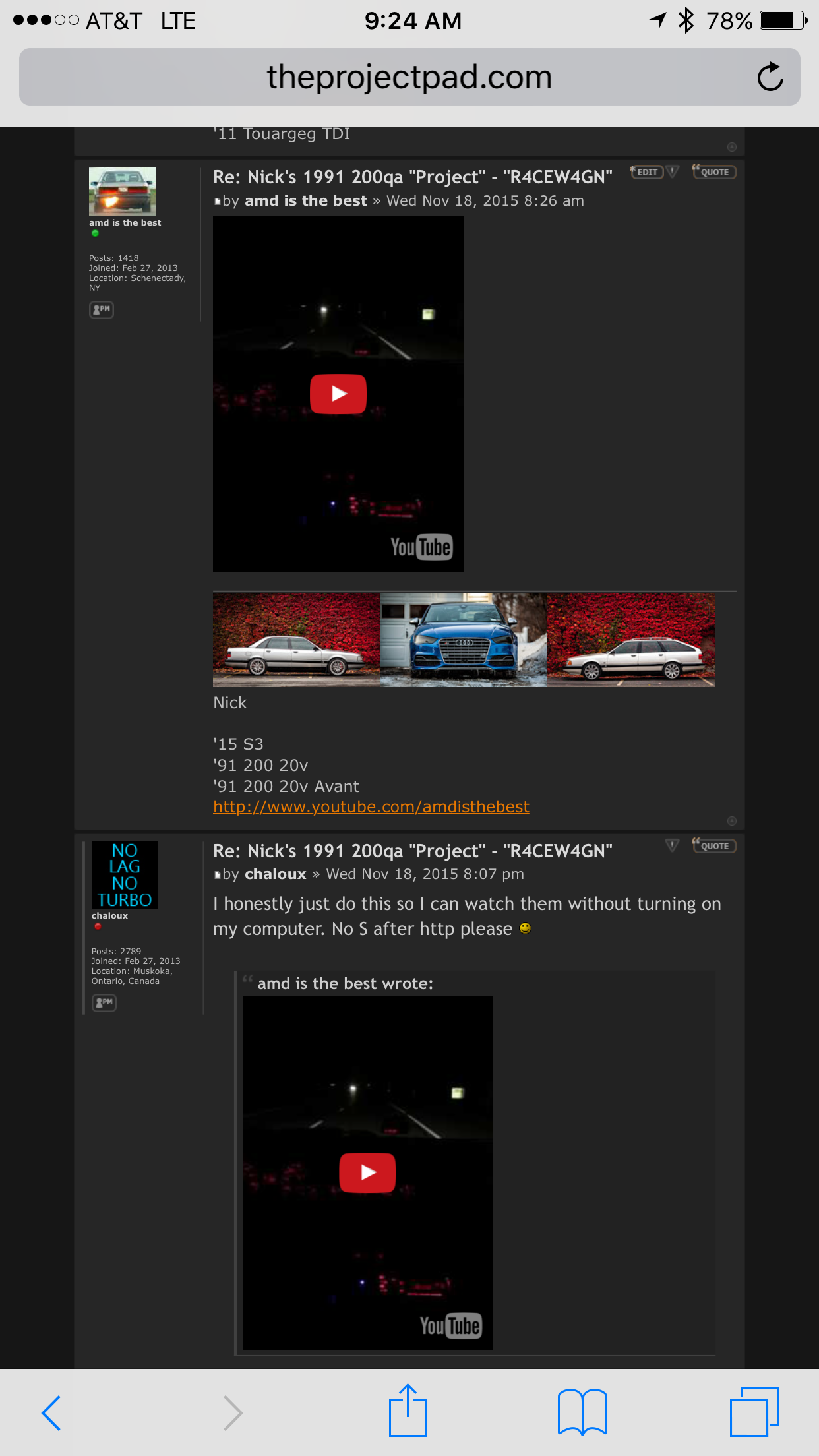

Re: Nick's 1991 200qa "Project" - "R4CEW4GN"
I honestly just do this so I can watch them without turning on my computer. No S after http please :)
Post by amd is the best »
Hmm. Seems to work fine on my phone...
Looks like you're using a browser? Matt's talking about tapatalk users.
app needs 'secure' connection - I hope there is more flogging posted soon
Yeah from within Tapatalk specifically.
This is what we see:
