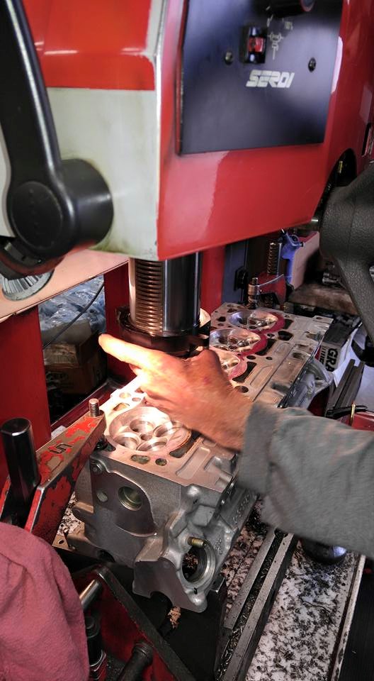

"Revver Head in the Serdi getting the final seat angles cut. Surface cut next and off to the flow bench for final numbers! 34 intakes and 29.5 exhausts. FRP developed custom angles in both seats."

Re: Chris' 200 20v Revver Project
Swweeeeeeeeeeeeeeeet
Love seeing pics of the process.
Jeff's the man!
Jeff's the man!

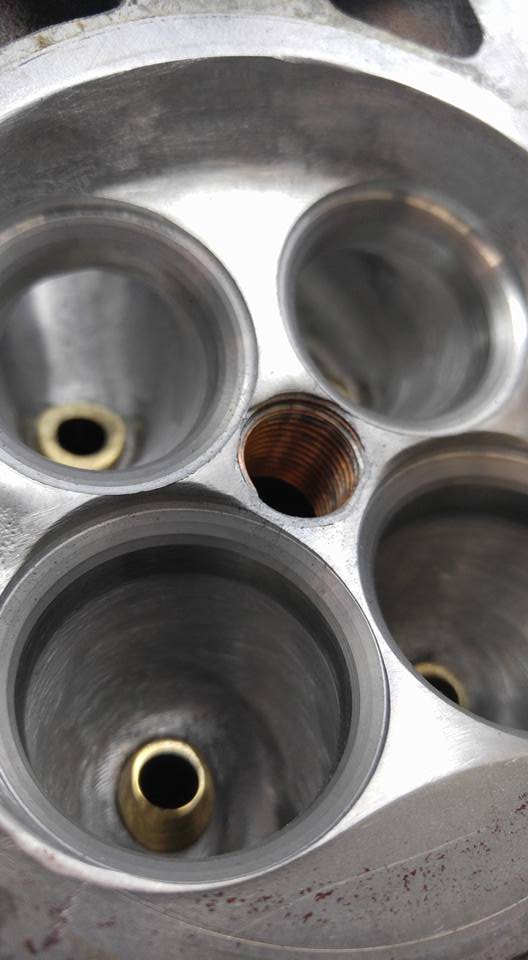

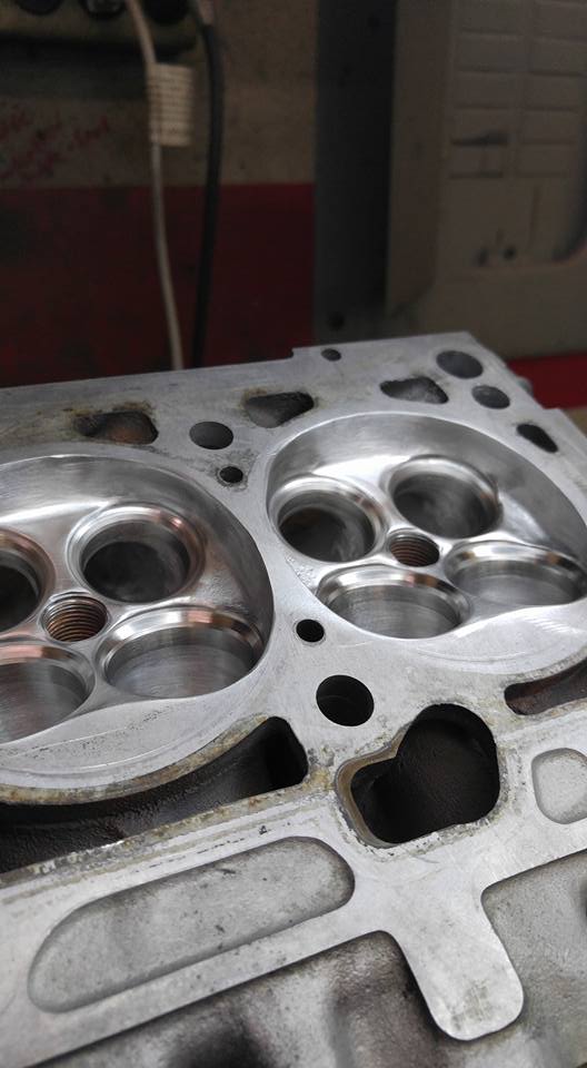

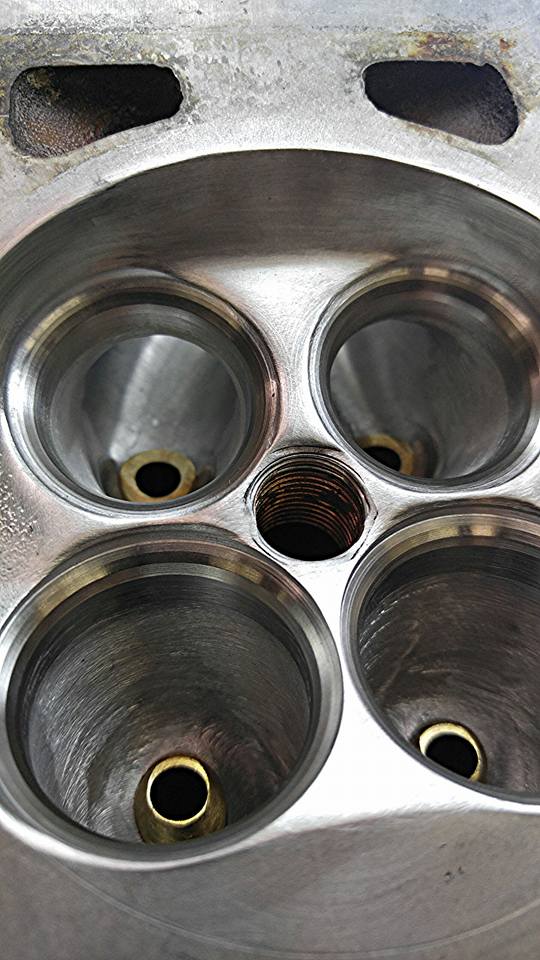

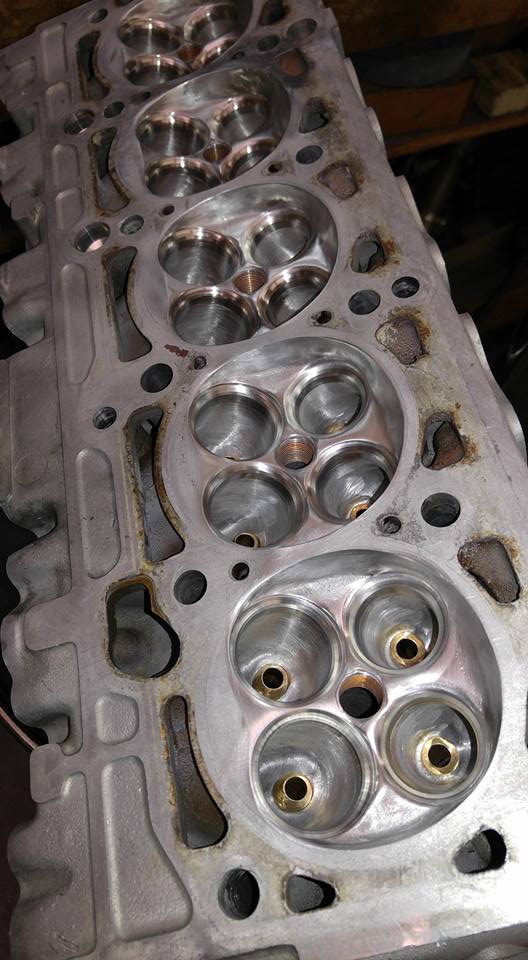

Today has been a fun day of updates from Jeff. The head is officially ready to go on the flow bench.
"Revver Head with raw valve seat machining and sharp edges and after Chamber Finishing. Four more chambers to go and onto the flow bench. Still needs surface cut but won't do that till all the solid lifter set up is complete."
"3 chambers done only 2 to go."
" 'The Revver' cylinder head is ready for the flow bench. And boy am I glad! This work is friggin tedious but needs to be perfect. I expect flow numbers to exceed the Bonneville motors numbers. Tomorrow we will see! Muahahaha."

Hot damn, you couldn't fit more valve in there if you wanted to!

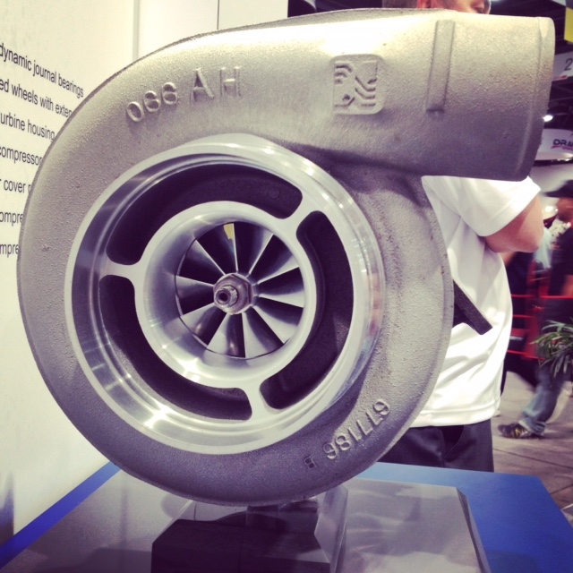

OK guys, I'm kind of excited, because I think I FOUND MY TURBO!
I've been saying for the past two years or so that if Borg Warner would come out with a 72mm turbo which would out-flow or match their current 76mm (my previous plan), then that'd be the turbo for me. I had my fingers crossed for that happening in the next year or so. Well, they have delivered!
110 lb/min at around 30 psi. Perfect for the revver! I'm only disappointed that it is a 10 blade wheel because I'm scared it won't whistle enough

Which one is it
- Posts: 2144
Re: Chris' 200 20v Sedan - The Revver - Turbo Found
Looks like the S400SX-E. You going to spool valve that bitch?
Yes, it's the brand new turbo in the s400sx line. Part number is above, but it's the re-aero'd 72 mm compressor 87/81 turbine.
I guess they will call the new versions with modern aero the sx-e?
Jim, yes definitely a qsv
Although it's not necessarily needed as that's not the point of the car, why not gain some more "low end" power if you have the ability?
