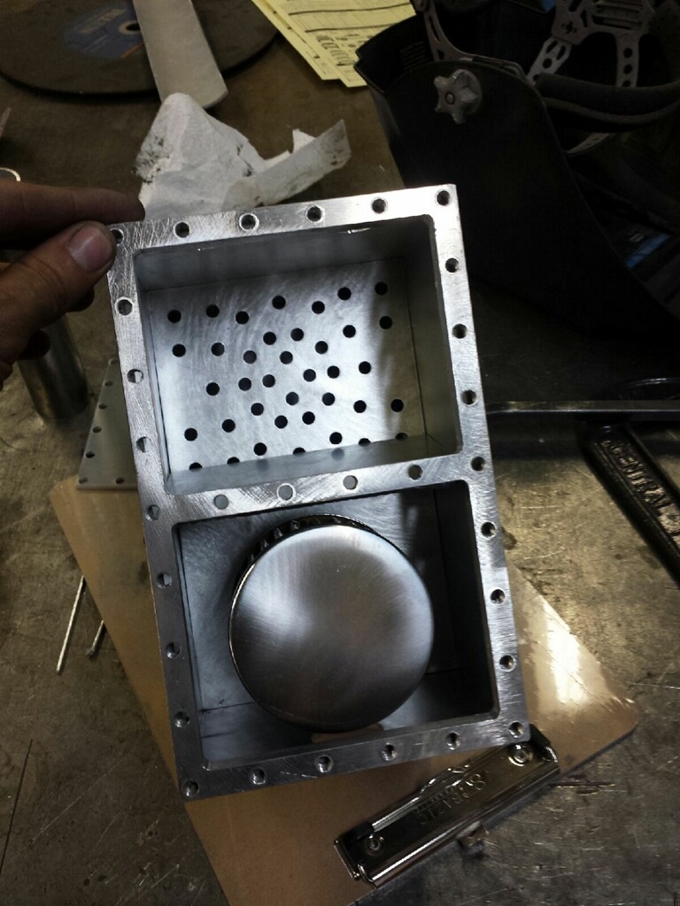

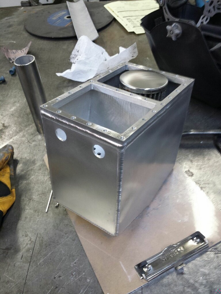

I shouldn't have to worry about positive crank case or valve cover pressure and oil should stay cleaner for longer periods of time. There's plenty of flow, baffling, media, and filtering for separation in my catch can. I could probably have a half worn out motor with tons of blow by and still be ok as long as you don't forget to keep adding oil.

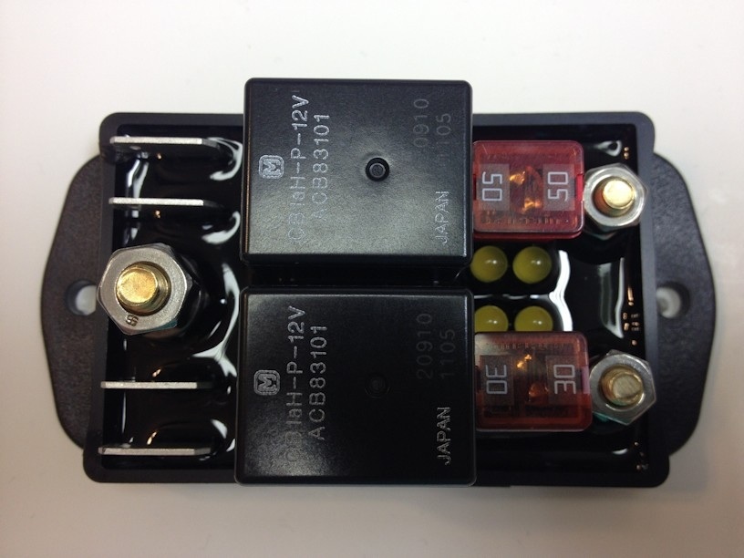

Got a nifty little dual relay board that has l.e.d. Failure indicator lights to run the dual 044's. Will make for a clean install. The fuel pumps should run pretty cool being mounted down low up in front of the car and help with keeping higher pressure being up front and close to the fuel rail.

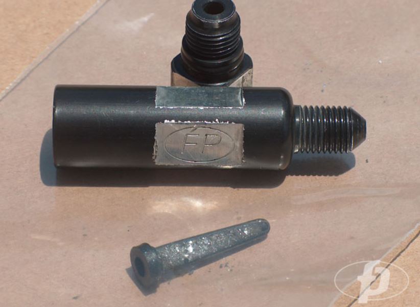

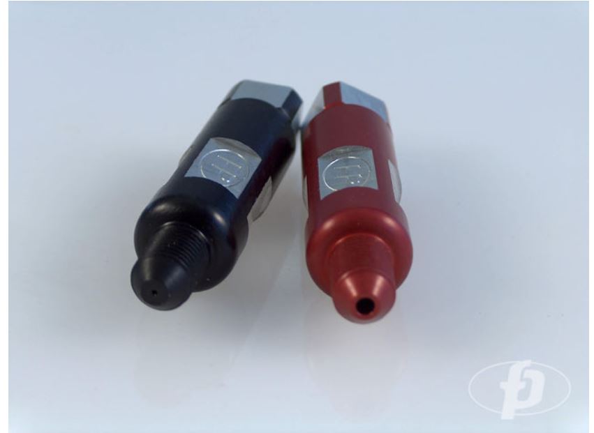

Nothing interesting, but a little update or documenting my build in case I decide to sell my baby one day. I ordered a Integrated Engineering Manual Boost Controller to operate the quick spool valve. Also got a non-flow-restrictive in-line oil filter for the turbo. It's a little piece of insurance just in case there is some trash somewhere in the system from the new engine build.

Re: Josh's 2.5 200QT.
Good call on the filter. But you should REALLY be operating the qsv by an n75 using one of VEMS outputs. We had a manual boost controller type setup in dad's car initially. What a pain in the ass. In VEMS you just setup the output (20 seconds), plum the boost line, and go do some logs. You have much much much better control not only of when you want the qsv to open but also how long it takes to open and if you want it to ramp up etc..
Just my .02
