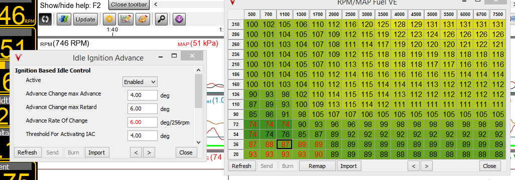

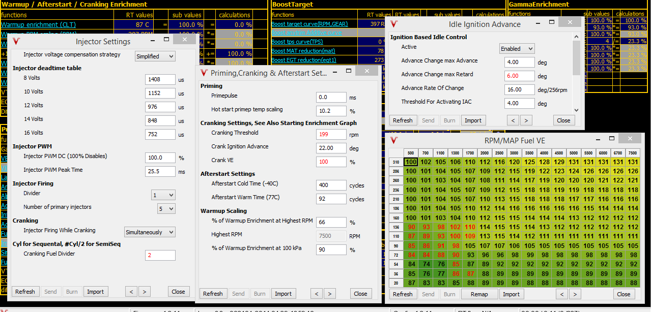

I set the MAT/TPS Table on the lower right cells a bit leaning out since i noticed the a/f become richer once the MAT ramp up.
i think i got all sorts of issue.my friend tried to remap and play around the VE table and set the ign adv rate of change from 16 to 6/256rpm.the injectors pulsewidth seems more steady than before.my Deka's PW is 2.0ms. too low?I have 5bar FPR,max
injector DC is 93% on 29psi of Boost.I will need to get bigger one for E85 soon.
Anyway,i heard some slightly knock when WOT at the top end around 6-7K RPM on E85.Too much advance on the top end?
my lambda target is 0.80.

Your entire timing map is very advanced. +6-10* higher than mine in almost every cell. I still highly doubt you got E85 to detonate at .80 lambda though.
Being 31-33* advanced at idle is probably also causing some of your idle issues. I'm around 20* there.

Do you have it that high because of the large injectors?I'm around 20* there.
Re: Idle problem on Deka's 630cc.
No, that's pretty normal. 15-20* there on a stock AAN tune. If you use idle ignition advance that effects the actual advance at idle as well
I try a very different idle strategy, modeled after what the later model cars do. I run a lot of isv duty cycle and keep the idle down using low ignition timing. My car typically idles between 2deg btdc to 5deg atdc. This greatly increases the 'reserve' power available and slows the responsiveness of the engine under idle control. A side effect is that the car now idles between 45-55kpa depending on loads, increasing pulsewidth and making it easier to tune in the linear portion of the injector. Pop may have trouble trying to do this though as his car is an auto and is already under a lot of load when in drive.
