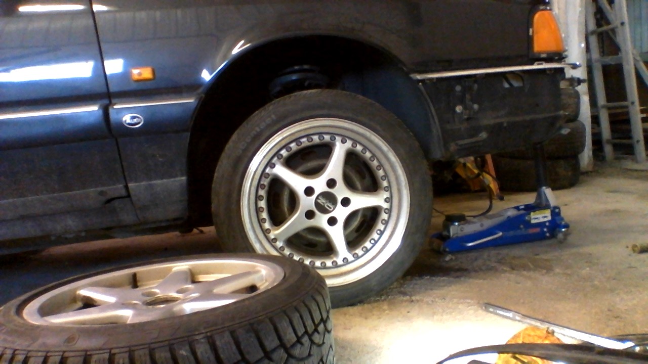

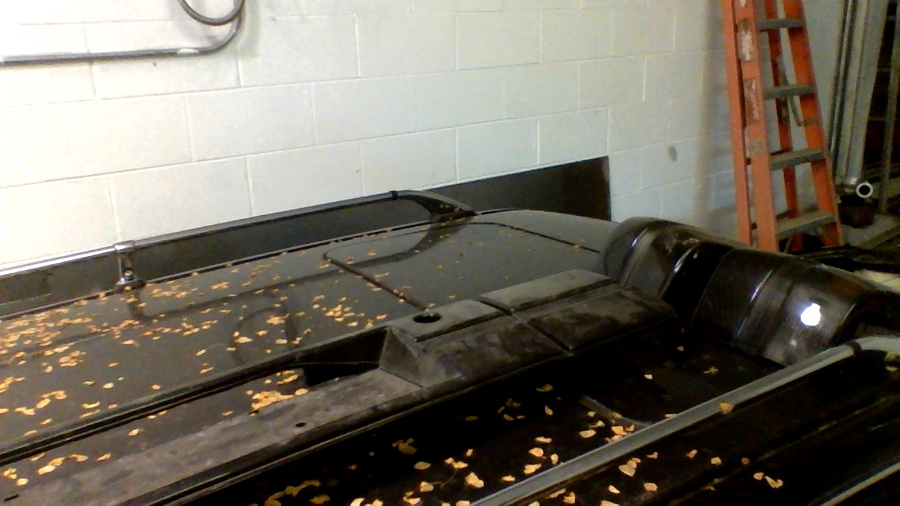

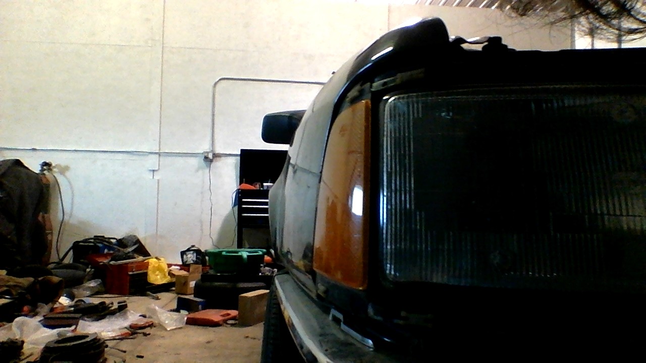

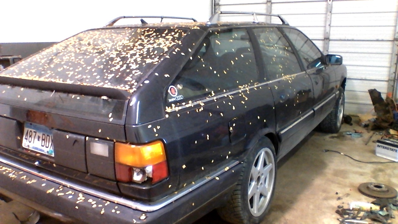

Some pictures not the best quality, but it's all I got for the time being.
- Some smoked tails
- picture053.jpg (166.98 KiB) Viewed 30921 times
- picture048.jpg (151.63 KiB) Viewed 30921 times
- picture046.jpg (175.56 KiB) Viewed 30921 times
- picture041.jpg (209.74 KiB) Viewed 30921 times
- picture040.jpg (152.96 KiB) Viewed 30921 times

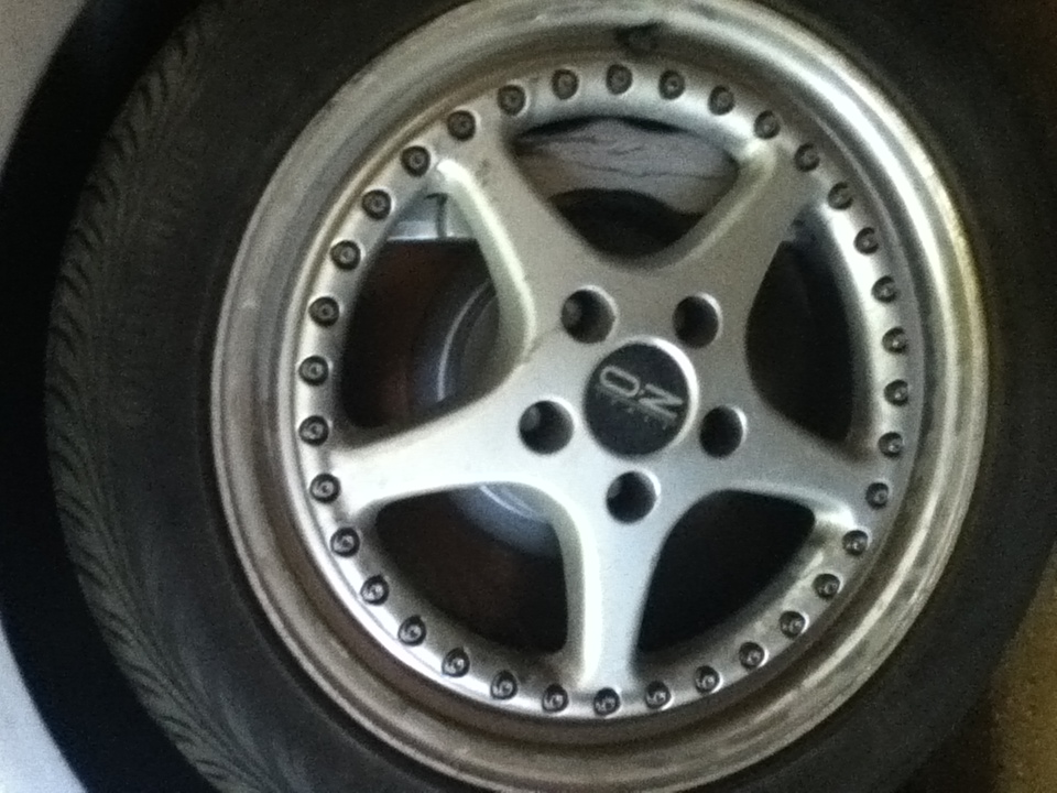

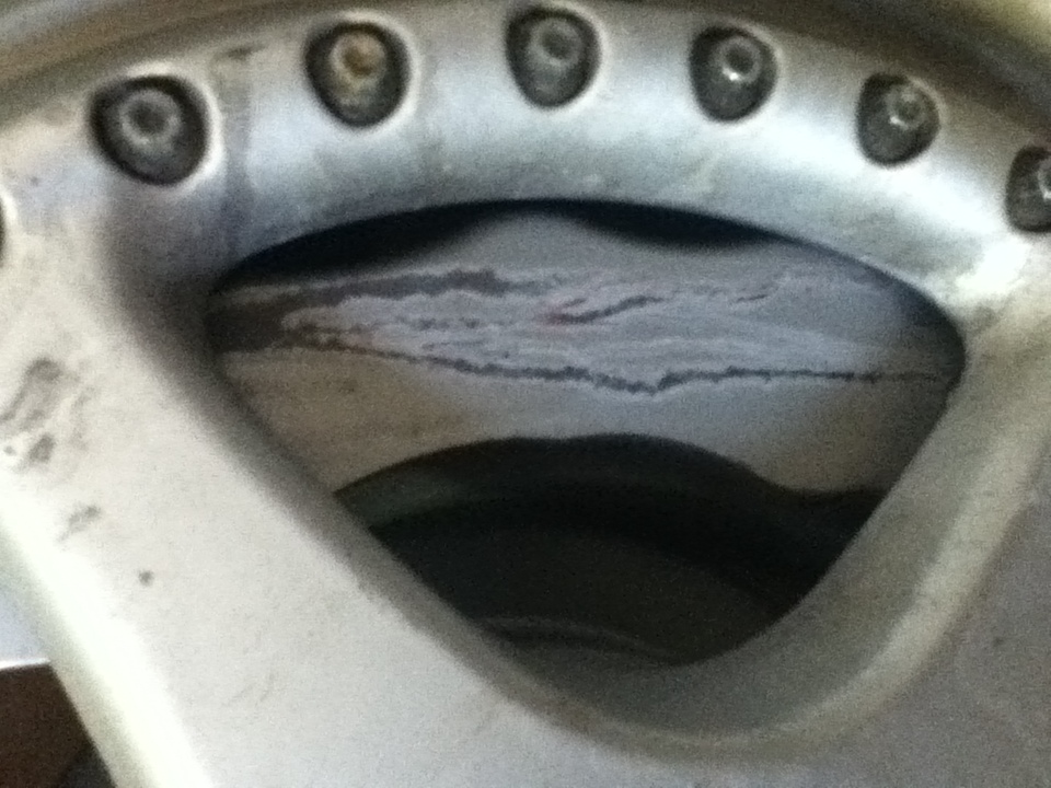

well test fit my OZ's on my mk5 rabbit to see if they cleared the 18z T-reg brake setup and with a spacer they would. That's good, so a 350mm rotor and a 6-pot caliper can fit inside these wheels. Just one more reason I love them. Currently working on picking up another set of calipers (probably the smaller 17z) to get them mocked up on the 200 UFO housings with S8 345mm by 30mm rotors.
pictures for proof they do fit.
- IMG_0861.JPG (239.36 KiB) Viewed 30900 times
- IMG_0860.JPG (245.62 KiB) Viewed 30900 times

That is awesome. Brakes are stuffed in there haha
Re: Project DRTHWGN
Insane amount of brake for the wheel! LOL
Re: Project DRTHWGN
I can tell you the 18z brake package is insane levels of brakes for any wheel. They engage so quickly the ABS isn't quite sure what to do.

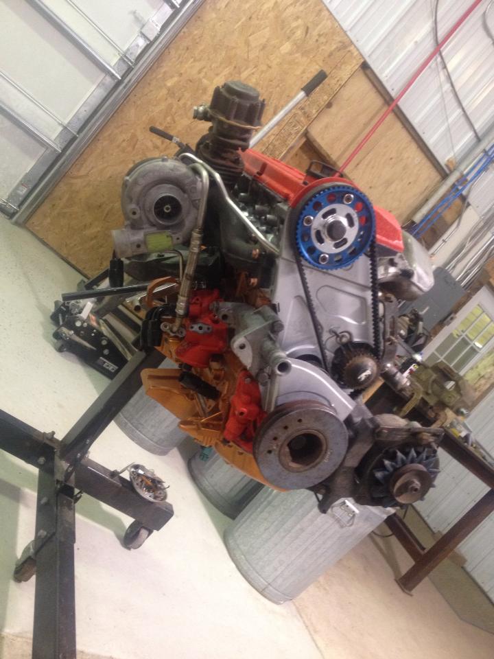

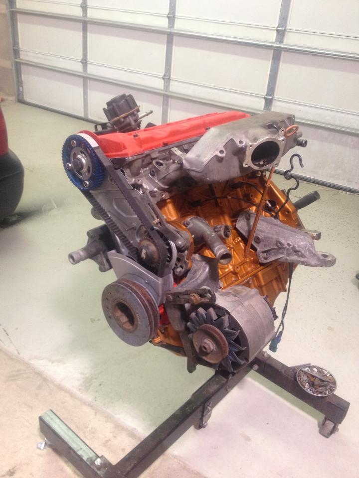

little update on this I've been working on it and am almost done building the engine for it. I couldn't get the 3B out in time due to space issues at my shop so I am building a Mutt. Using a 7A long block that I picked up cheap as the base of the engine. 3B exhaust manifold and WG with 2.2 bar spring, 7A cams, 3B/7A dizzy setup, AAN intake, K26 from a 20vt, 20vt oil filter housing, and a 7A clutch package with stage 2 clutch. Not a bad pile of parts for a temp engine I built from spares. I have a IA stage 3+ to run the whole thing on hopefully the 7A is up for that. I setup the oil return and oil cooler with -10 lines. The oil cooler is also from a V8Q so it's a little bigger then the factory.
Going to be doing an 01E conversion on this car using a setup I bought years ago when I was going to 6-speed convert my V8Q before the wiring burned up in it. So I have a set of new V8Q 6-speed mounts, a complete URS4 shift linkage, 01E slave/master line, a set of URS4 axles modified to fit the t44/D1 chassis and a set of new transmission mounts. Only thing I need is to swap a V8Q front subframe in the car (which I have several of). I also have a Euro 28mm V8 front bar I'll throw in there. Transmission will be a DQT code 01E I have had collecting dust in the corner since i started my coupe build 6 years ago.
- Mutt20vt1.jpg (77.58 KiB) Viewed 30671 times
- mutt20vt2.jpg (89.78 KiB) Viewed 30671 times

7A is 10.3:1... you are going to run into issues with that kind of compression and 20-22psi of that IA 3+ chip. You should at the very least stack some gaskets in there to get it hopefully below 10:1. Stock 20vT's are 9.3:1
Also, do you ahve the distributor in yet? does it fit with the AAN manifold? Speaking of the manifold, what is your plan for the radiator?
Not trying to be a debbie downer, just wondering.
Re: Project DRTHWGN
Dizzy fits fine, early AAN's in europe used a capped off dizzy for the CPS.
I'm aware of the higher compression, I don't think it will be that big of an issue with a larger then stock IC and the cold air up here in the north land. I plan on my stroker being 10:1.
Radiator issue I haven't resolved yet, waiting on a set of 200 motor mount arms so I can mount the engine in the chassis.
I've built several 1.8t's with similar boost on similar compression and not had issues with them (stock internals with thinner gaskets).

*10.2:1 I thought?
Did your 1.8ts have cast pistons?
I can confirm that a stock, never opened, 7a can survive at~200kpa with E85. Sometime this fall my clutch started slipping so I've been running on spring only since. I'm on a street tune so I'd guess that a day of dyno tuning could allow for a safe tune with additional boost. Honestly, I'm deciding if I should kick off the upgrade avalanche by installing my AAN shortblock when I get around to doing the clutch (so DM rods, clean up bottom end, all new gaskets, ARPs) or just doing a clutch and sticking with the 7a a bit longer so I can get on the dyno and tune a bit.
Regardless, I've wondered what would happen if you put a 3b harness, ECU, and turbo parts on a 7a so I'm interested to see what happens here!
Re: Project DRTHWGN
if it blows up it blows up. I wasn't going to spend the money a real 20vt costs when I have no plans to keep it stock and no plans to stay 2.2/2.3L.
I've seen many stock 3b's pushed far beyond were people thought they can go and the IA isn't known for being the most aggressive chip on the planet.
It will max out the stock K26 that is for sure.
