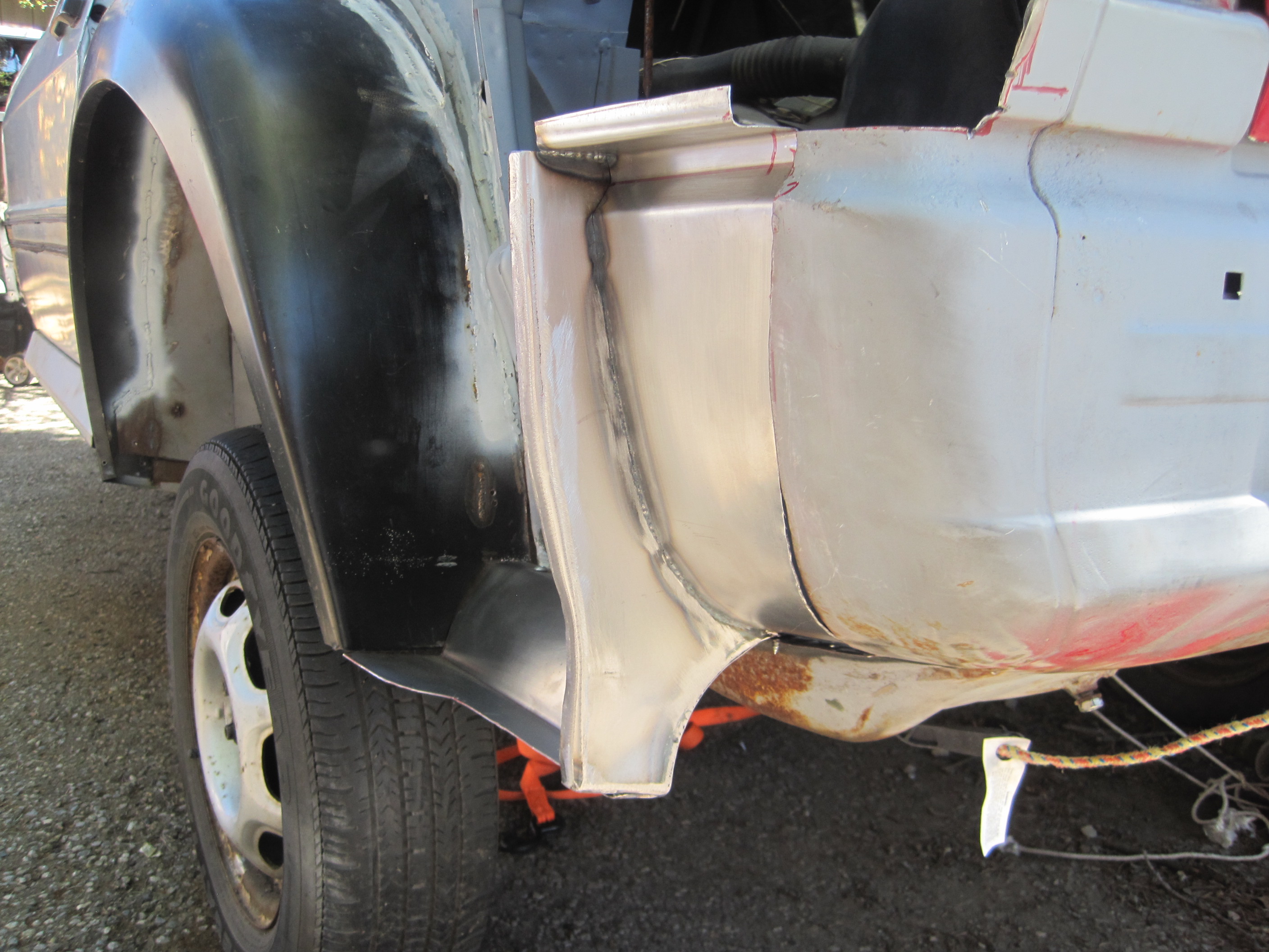

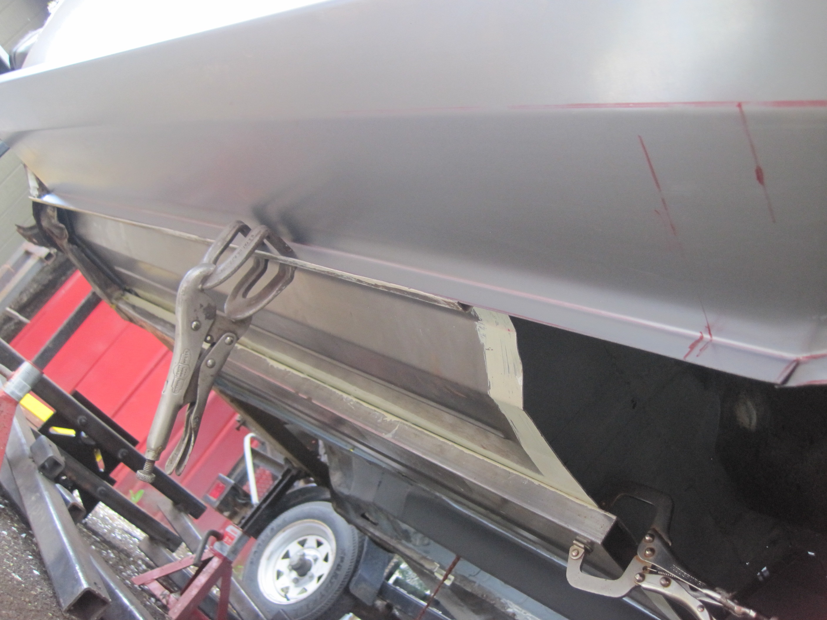

Another piece of the puzzle completed.
Just have to fnish the other side and weld them on to the car.

Looks good Craig. How did you flange that outer contour? I wanted to build a tipping die for the bead roller but i haven't had to build anything like this yet. It looks very challenging to fabricate. Keep up the good work!

Thanks for the kind words guys
John I don't have a tipping die for my bead roller, but I would really like one.
I basically marked out the flange area and carefully bent up the lip with vice grips and then
hammer and dollied out the rest. Turned out pretty well me thinks. This will give me a nice bonding surface
for the carbon rear quarter. I'm going to have to re-make my rockers
It turns out one of the angles is a few degrees out. I could make it work, but I wouldn't be happy with it.

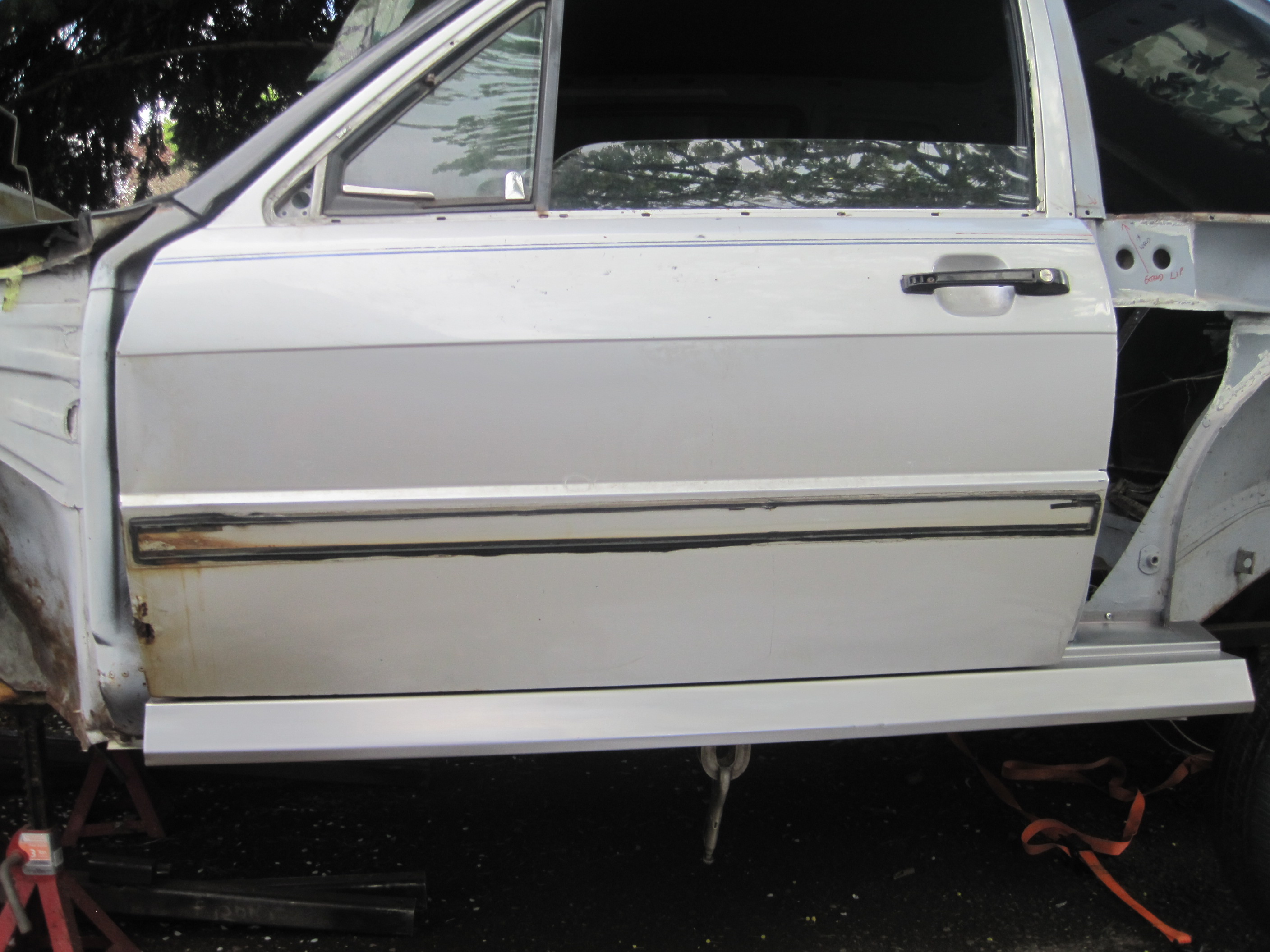

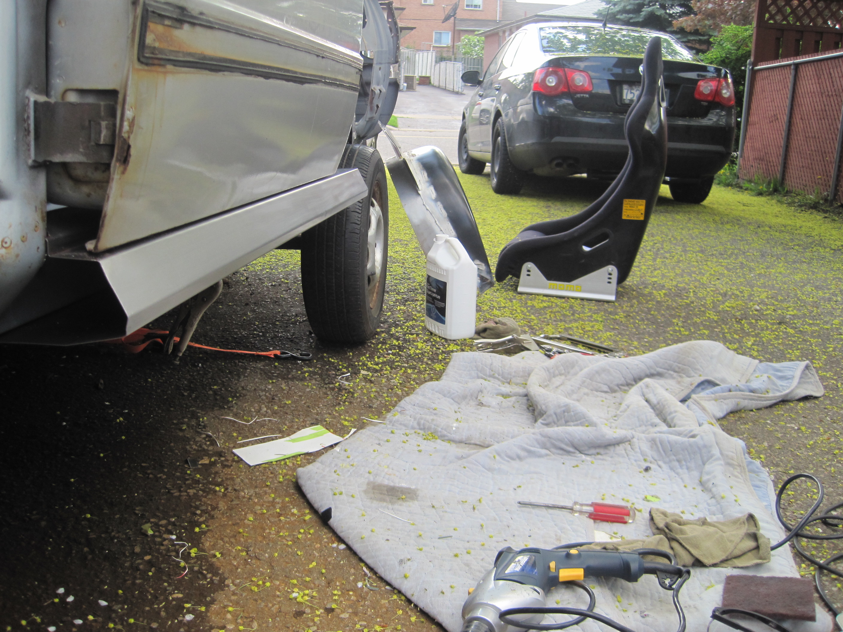

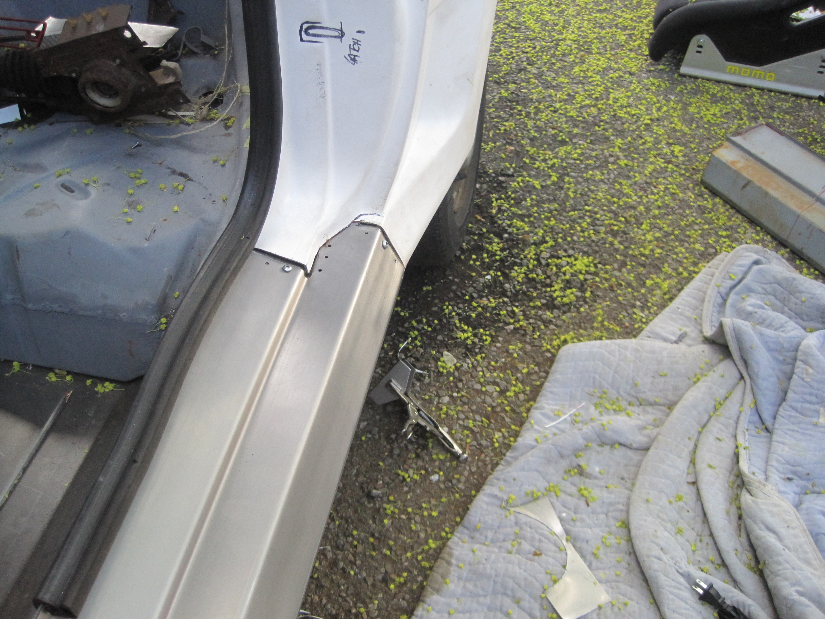

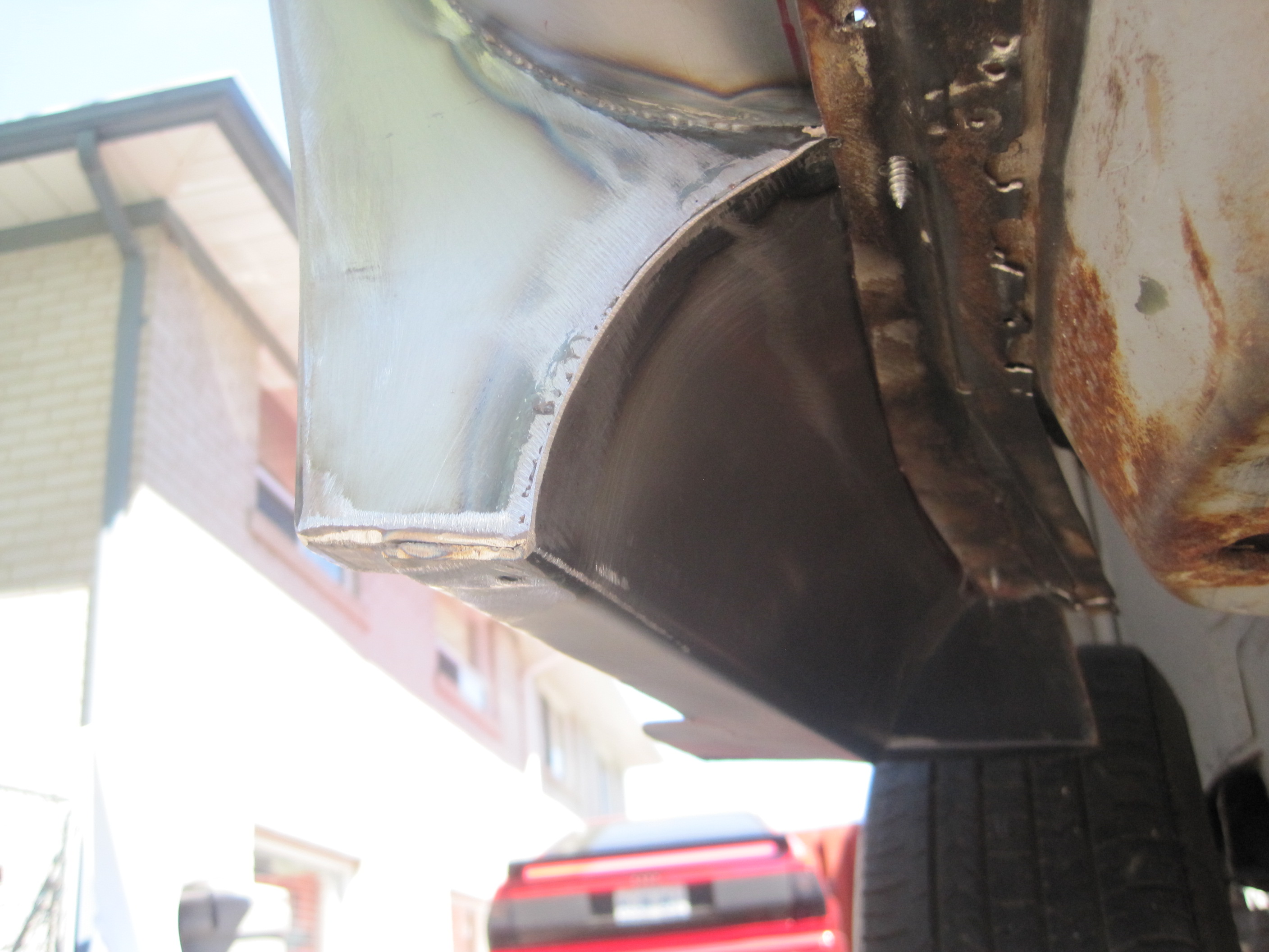

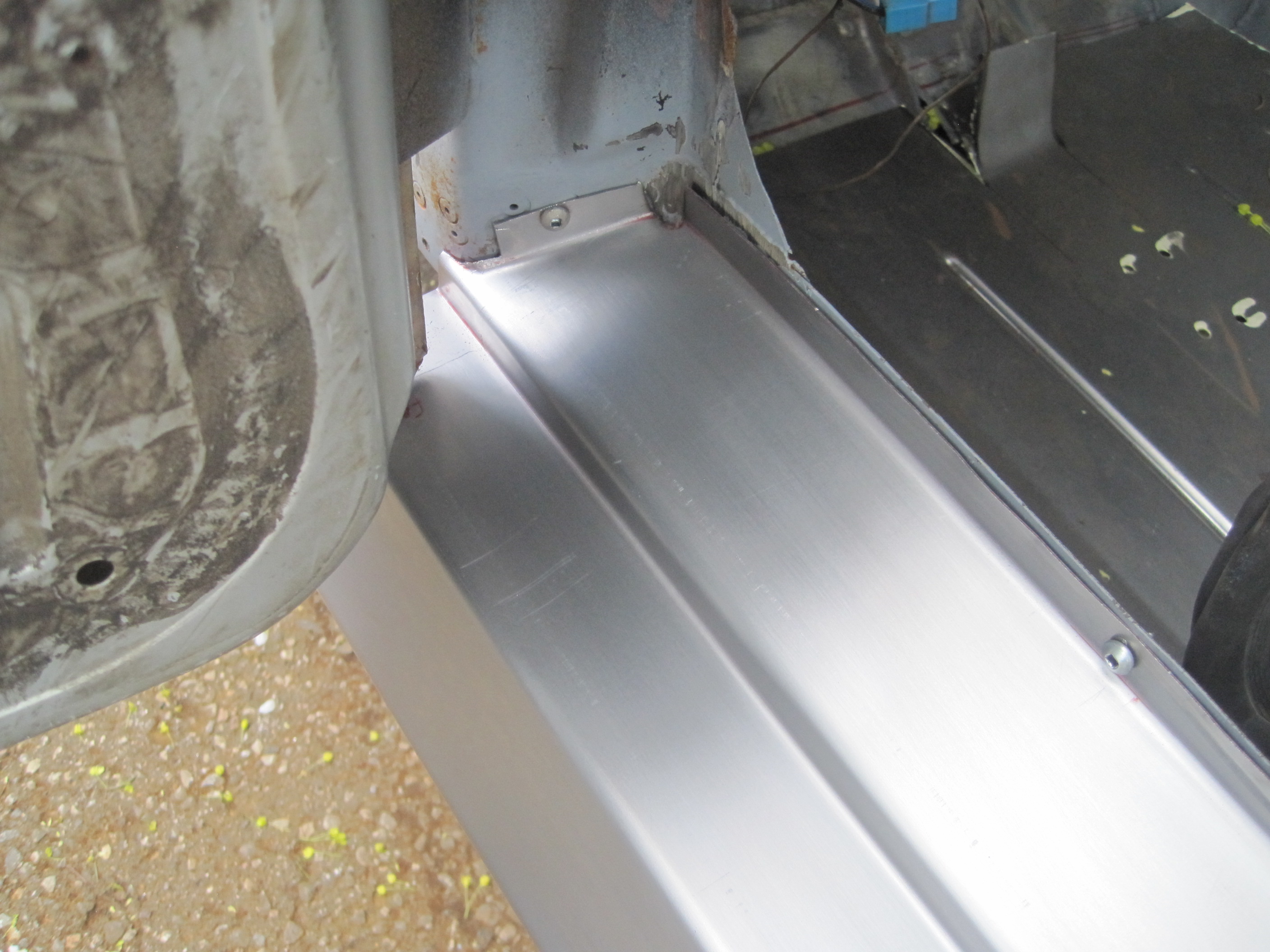

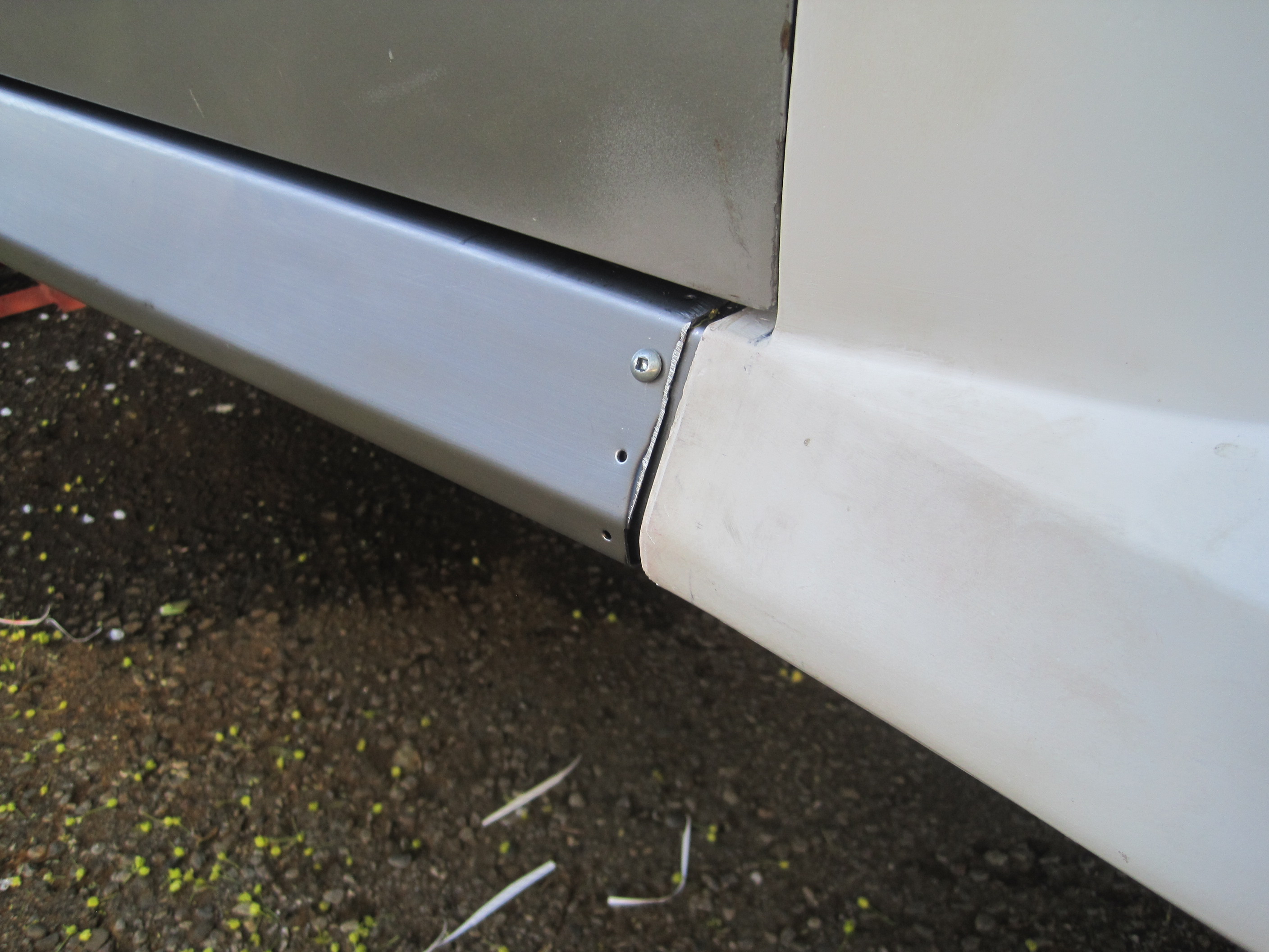

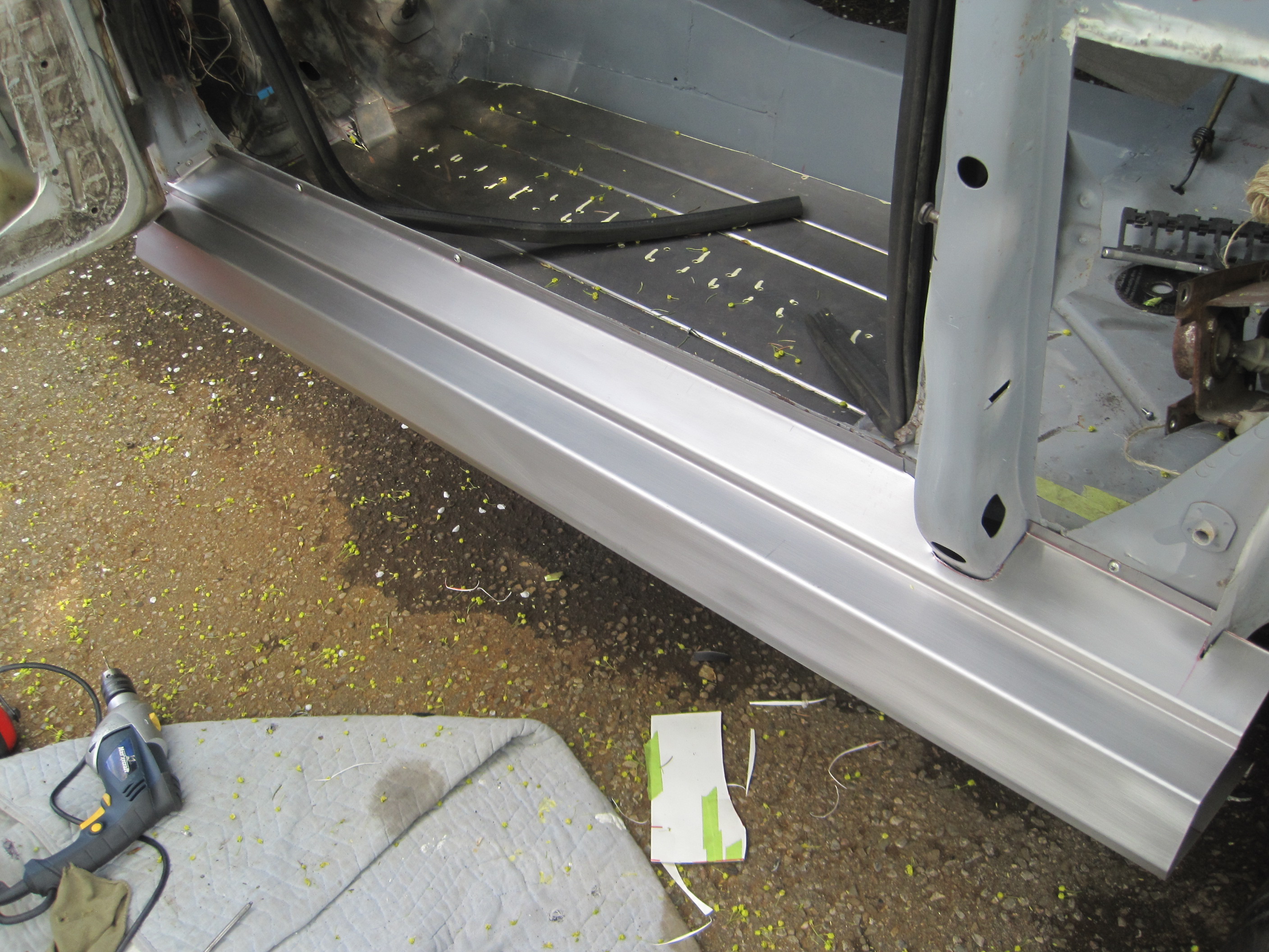

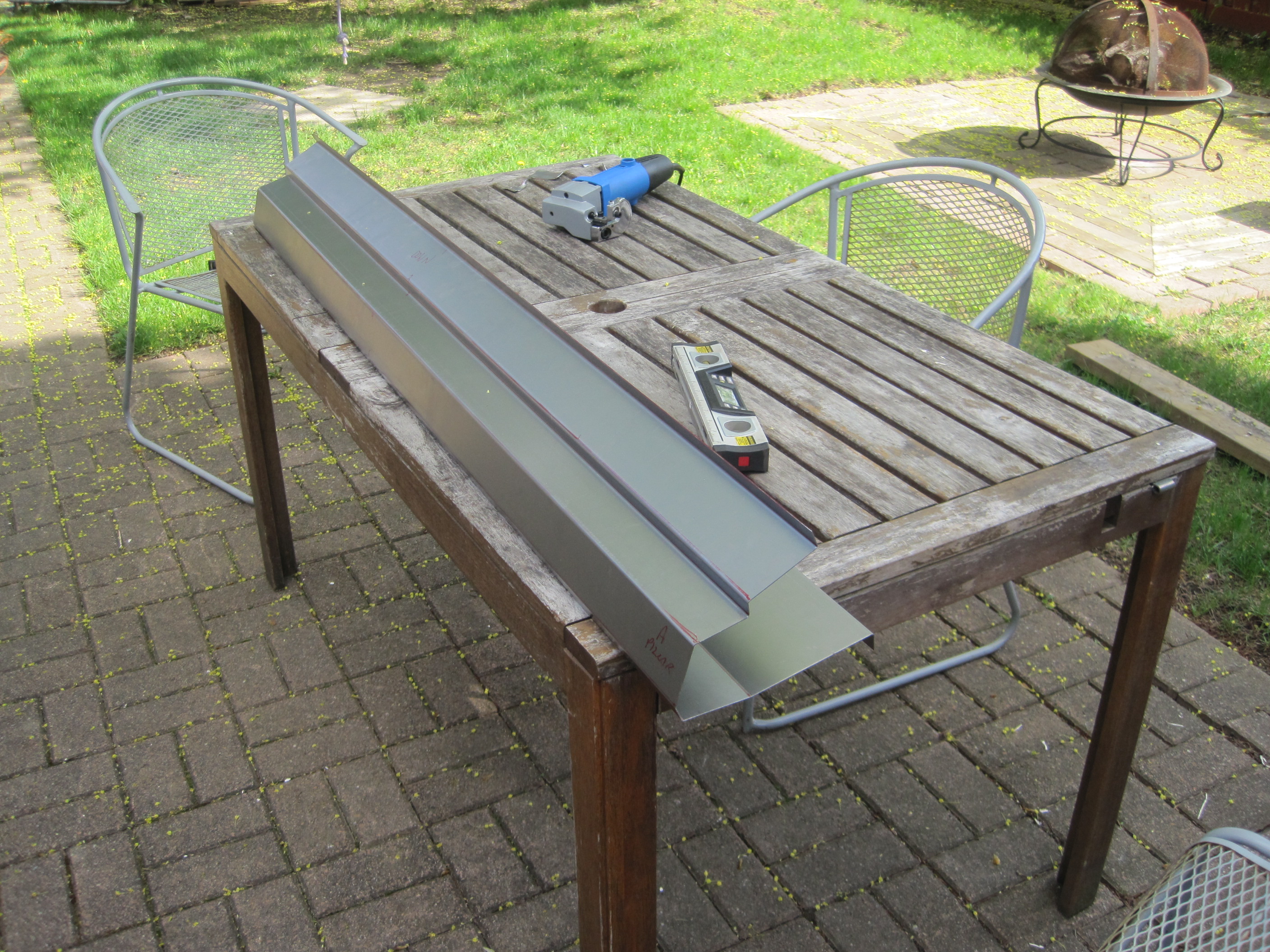

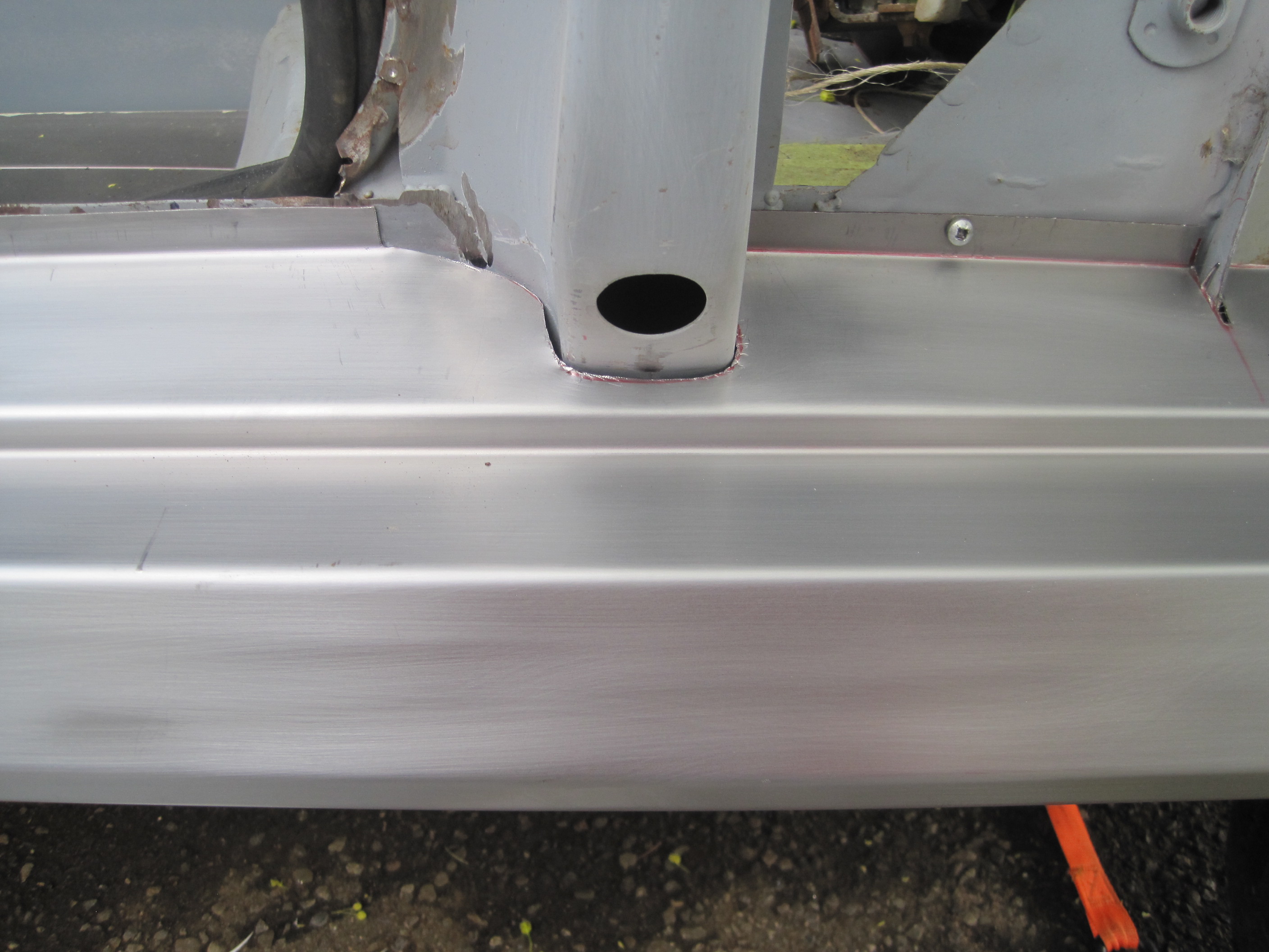

Finally I got around to making my rockers version 2.0
The first set turned out okay, but I wasn't happy with one off the bend angles.
I managed to get access to a really nice long sheet metal brake. This way I could bend the rockers
in one go. These are tricky buggers to get just right. Luckily I managed to get a cross section of a factory
urq rocker (thanks Mike) and changed some of the angles from vesion 1.0 and began bending away.
I'm really happy with the results, just need to get time to get them welded in. Now the carbon rear fender sits just the way I wanted it to.
A few pics.

Re: Craig's Sport quattro build
wow, those look great!

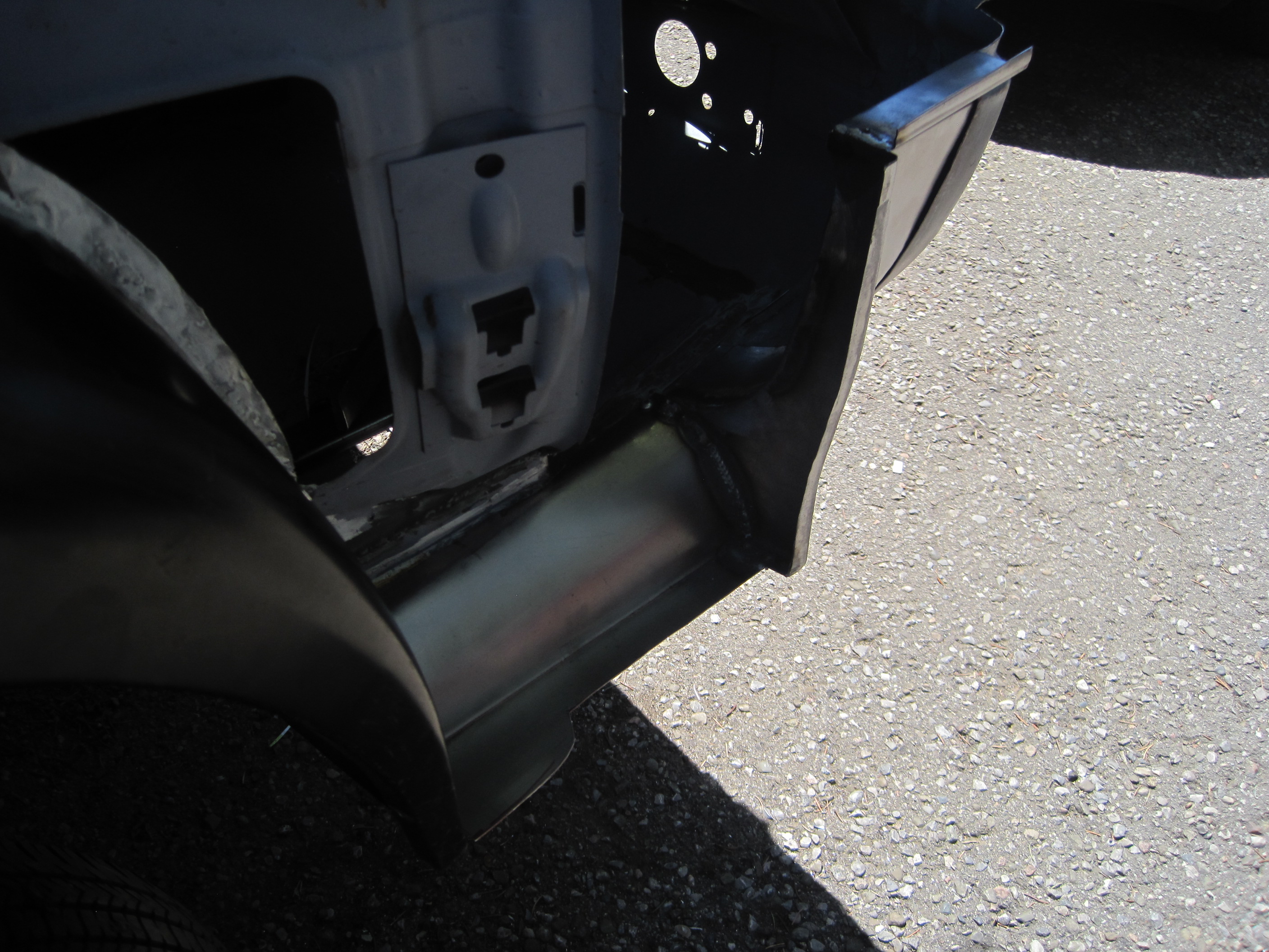

Awesome build, and nice job lining up those rockers. They look OEM the way you have welded them back in.
