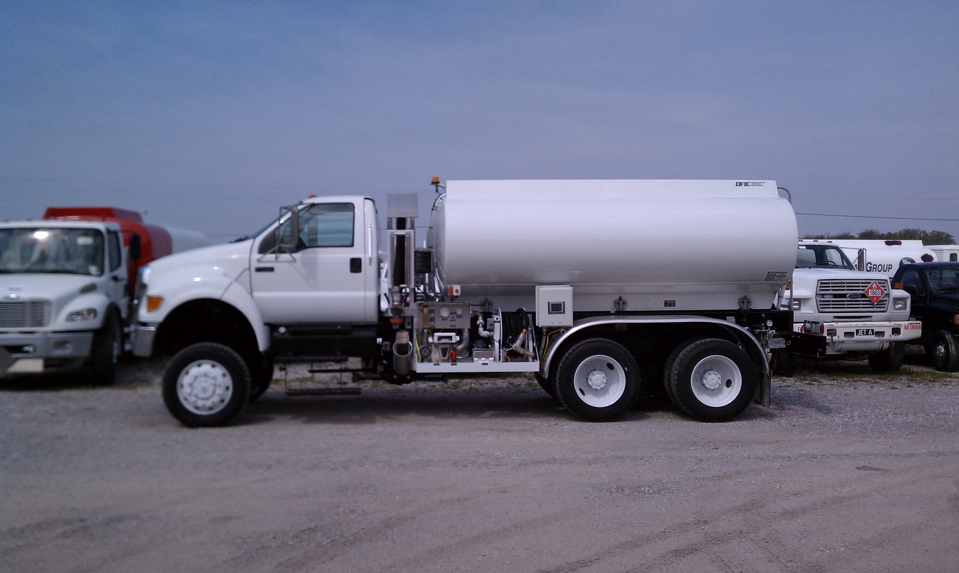

Here's a less complex example of one of our trucks. It's overseas now...
- 6x6 F750 ISB/2500RDS
- IMAG0203.jpg (1004.23 KiB) Viewed 24412 times
Re: Tig welding
Yeah, I could see welding that up with a big 26 body aircooled torch. Sure most of it is done with a Spool or MiG

The piping was TIG and MIG/spool on sch10 aluminum. The tank was probably machine, we didn't build that particular tank. The red/white tank on the Freightliner was one we built, it's actually steel (yuck) with epoxy coat inside. It's also RHD. Really goofy to drive, it was converted by a garbage truck builder for us.
