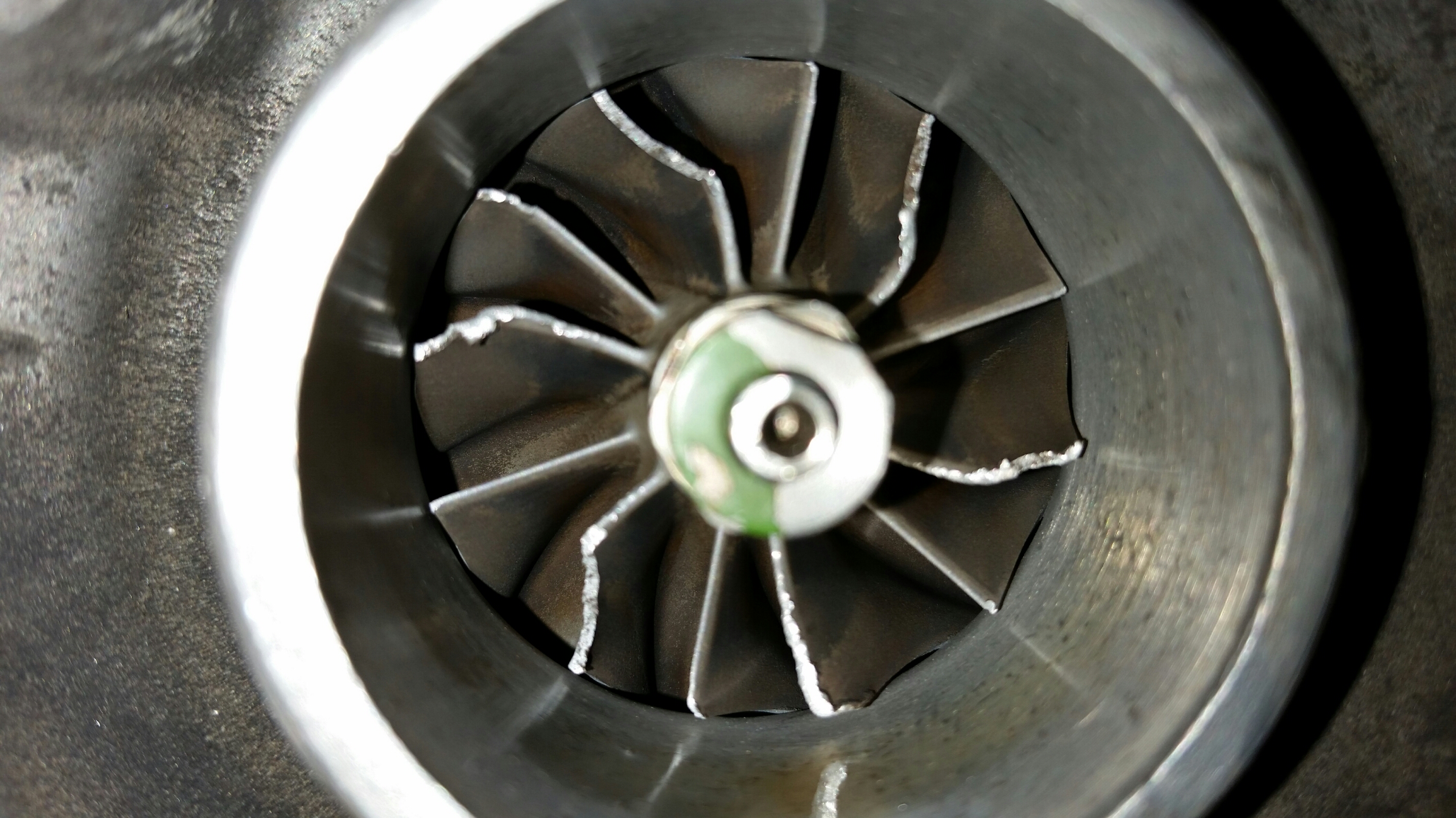

I actually didn't want to go past a k04 to be honest. For having to wait for spool, its about as long as i was willing to wait for. I'll have to check the code on the trans, I thought it was an 01X. Either way, I was getting an unusual whining with spool, so i figured i would check the turbo to be sure what was going on. Sure enough....
2015-06-21 10.46.41.jpg (2.41 MiB) Viewed 14637 times
I should have checked the turbo when my brother bought it... well, its my problem now and is down till I find a k04 to put in.
