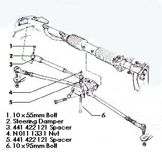

I am adding a steering stabilizer and wanted to buy the bolts,spacers, and nut to bolt a new stabilizer on my car.
You need two new bolts, two 15mm spacers, one nut, and the steering damper to retrofit this damper to the earlier vehicles. The spacers go between the damper and the right side and center mounting bracket.
For retrofitting on the earlier Audis, the Audi part numbers for the spacer is 441 422 121 (2 required), the right side mounting bolt is N 010 455 3 (10 X 55 mm, 1.5 thread pitch), the steering rack center mounting bolt is N 010 483 3 (10 X 95mm, 1.5 thread pitch) and the nut for the center mounting bolt is N 011 133
