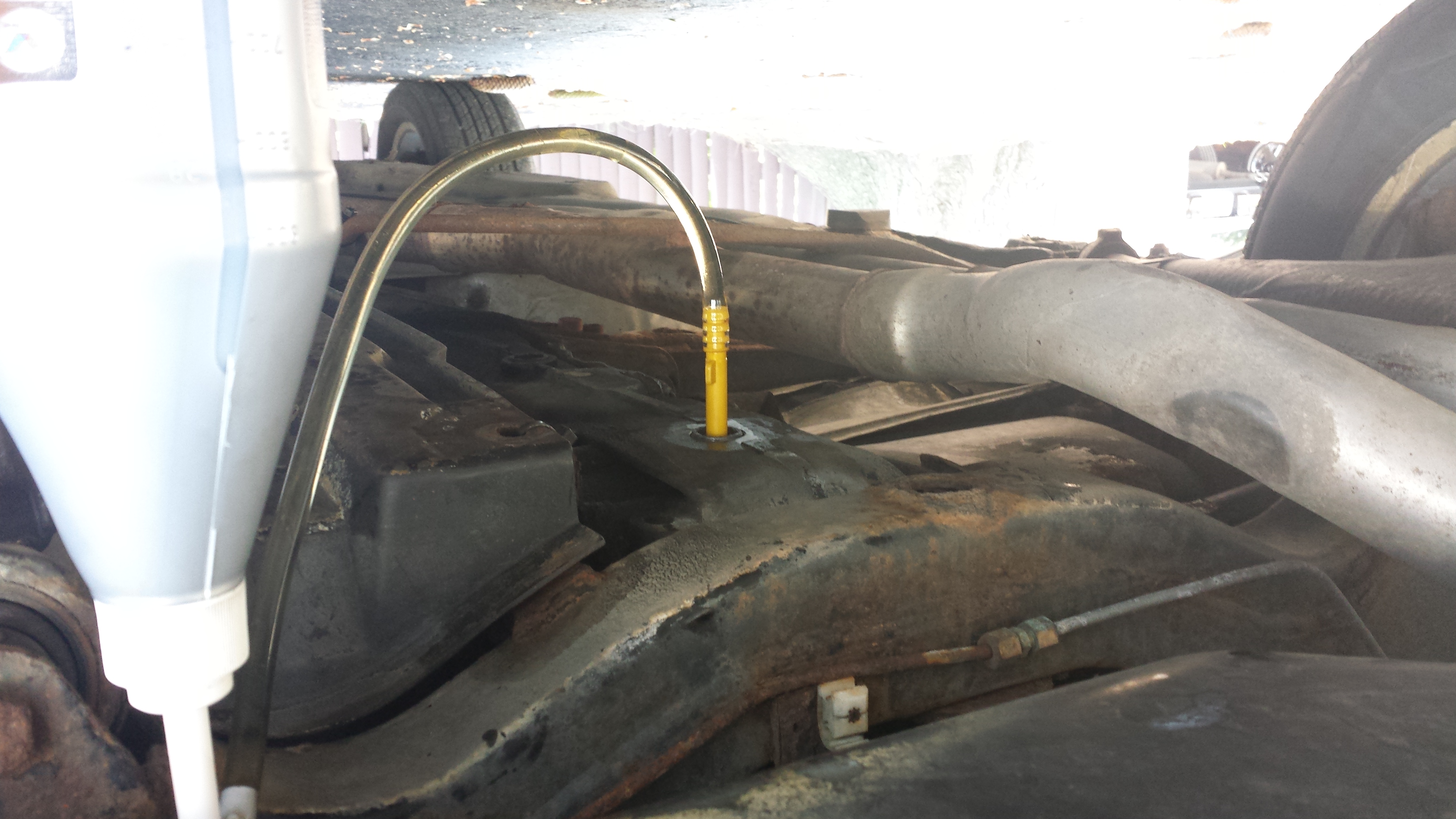

If you're all embarrassed of my methods, please comment lol

Posted: Sun Aug 16, 2015 12:17 pm
by DE80q
Filling the rear diff from the drain?
Posted: Sun Aug 16, 2015 12:30 pm
by 88a5tq
Good eye Dave. That's the pump I got when I did the 5k's. I love finding tools from the past. It's only $10 for the pump but still, savings.

Posted: Tue Aug 18, 2015 8:41 am
How did you fill it from the drain without it all leaking back out?
Posted: Tue Aug 18, 2015 9:57 am
by 88a5tq
Drilled/tapped for my Walmart outboard motor oil pump. It has a threaded Yamaha motor fitting which I plugged with an identically threaded hex head bolt. Works like a charm. I put an oil resistant oring on the bolt and then cover in ultra black sealant to prevent tampering or leaks.
