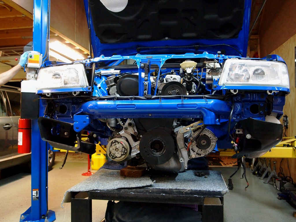

I think the deal with v-belts in small chassis builds have more to do with the AC, Alt, and fan being on the drivers side in the C4:
This will not work with a side mount rad, so Audi moved things on the ABY/ADU:
Saltinot's RS2
Saltinot's RS2

Thanks!
I'd thought that some of the accessories moved to the other side with this setup.
I definitely want to keep AC and factory PS on this swap
