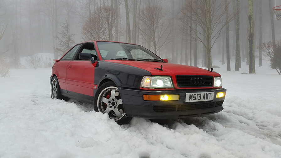

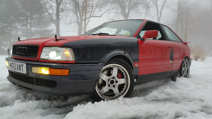

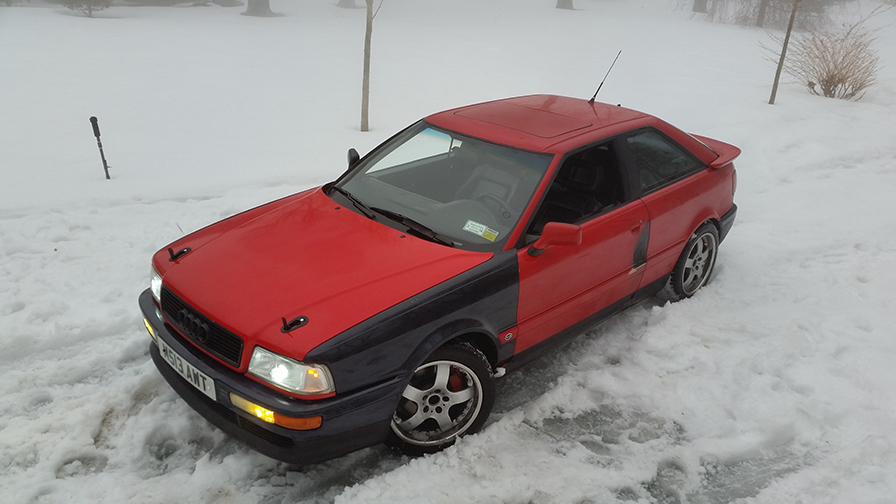

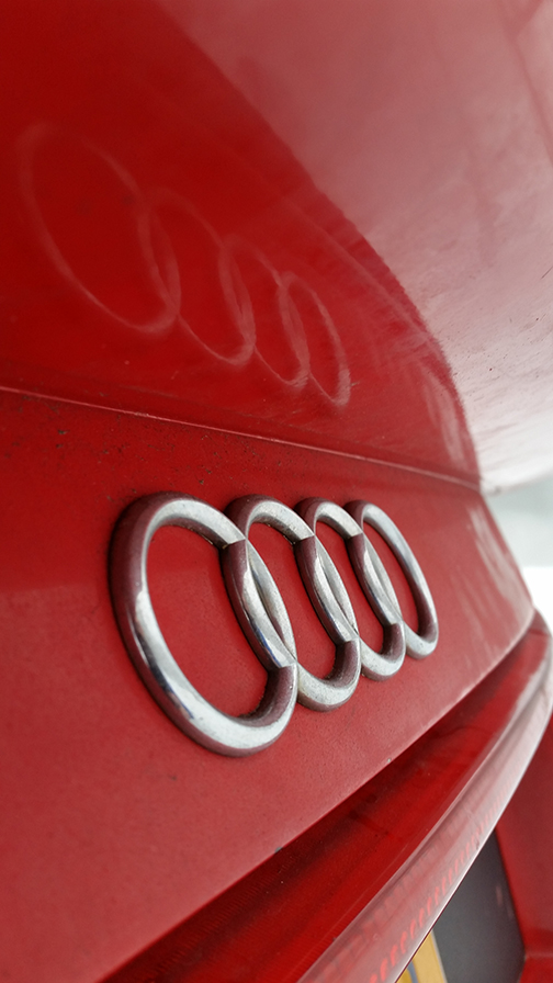

few more
- Sebastian's 91 Coupe Quattro Winter 5.jpg (331.38 KiB) Viewed 20186 times
- Sebastian's 91 Coupe Quattro Winter 6.jpg (293.26 KiB) Viewed 20186 times
- Sebastian's 91 Coupe Quattro Winter 7.jpg (292.76 KiB) Viewed 20186 times
- Sebastian's 91 Coupe Quattro Winter 8.jpg (277.97 KiB) Viewed 20186 times
- Sebastian -

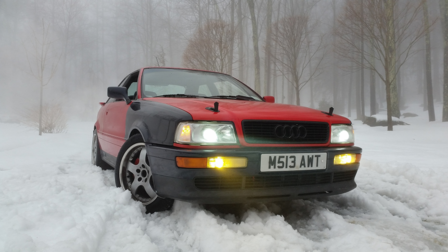

Re: Sebastian's 91 Coupe Quattro - 3b swap - Vems - e85
- Sebastian's 91 Coupe Quattro Winter 9.jpg (274.04 KiB) Viewed 20186 times
- Sebastian -
