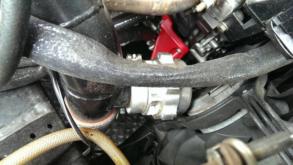

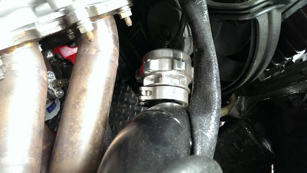

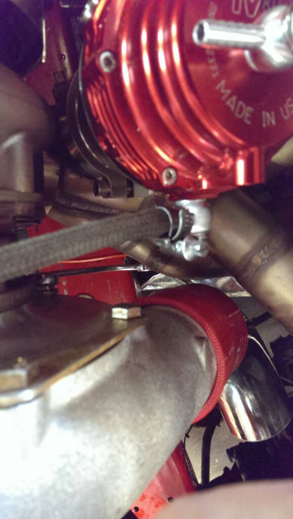

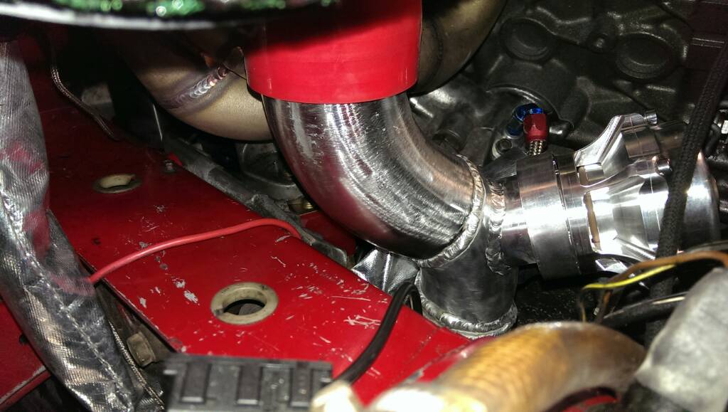

It will move both directions based on accel/decel. Those engine mounts keep it pretty sturdy but it still moves significantly. I just don't understand why you went out of your way to keep the charge pipe on the motor side of the frame rail? Rotate the compressor housing a bit and that pipe would have been much simpler to fab.
The vaccum line attaches to the top of the BOV...I see a vacuum line hanging...
Re: A tale of Rubí...Samco Delete & TIAL "Q" w/PICS...
EDIGREG wrote:It will move both directions based on accel/decel. Those engine mounts keep it pretty sturdy but it still moves significantly. I just don't understand why you went out of your way to keep the charge pipe on the motor side of the frame rail? Rotate the compressor housing a bit and that pipe would have been much simpler to fab.
I hear you... But a few things...
1) I looked at many dyno videos, and everyone of them lifts on the passanger side under acceleration and back down on the mount on decel... None of them had these firmer mounts that I know of
2) I went out of my way because I had no time constraint and lets face it, I've dealt with bigger complications than dealing with cuts and pipe angles... it was simpler for me this way... Less piping and more room for the future oil cooler
3) I did try many different routes:
4) As it sits now, I have almost 2" of pipe to frame clearance(I'll get a better pic)... I highly doubt it'll hit and if soo that's why there is silicone flex, right?
5) I like the least travelled route as long as it doesn't hurt performance...
EDIGREG wrote: The vaccum line attaches to the top of the BOV...I see a vacuum line hanging...
Its not connected cuz this unit has no spring and was used to mock up my unit with hasn't arrived... Waterfest plans are looking dim... :sad:

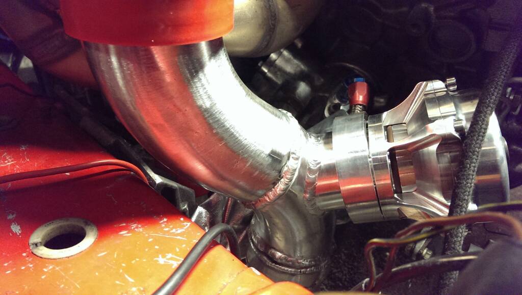

Gotcha... the length is about the same around the other side of the frame rail and it has less bends. I also prefer it to keep the piping away from the heat.

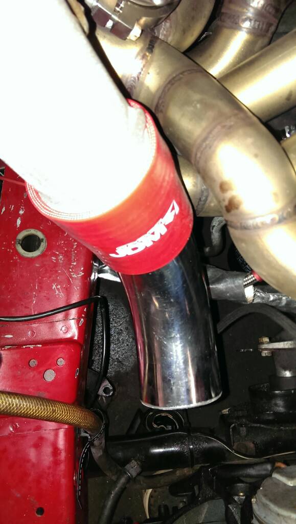

If you have 2" you will be OK. This pic make it look like it was touching the frame rail
Is it driving yet?
EDIGREG wrote:Gotcha... the length is about the same around the other side of the frame rail and it has less bends. I also prefer it to keep the piping away from the heat.
Is it driving yet?
Oh I see why you'd think that based off that... I'll get a better one ... And yes, it runs and drives in and out of the garage bay every morning
... Just not on the street yet until I get my fully functioning BOV... is it me or does Tial always take a while to get stuff out? Maybe I'm getting antsy... tomorrow I'll be putting my bumper on though....

Here's a better clearance pic... Looks like the pipe might have slipped down since I had no clamp when I took the original pic...
