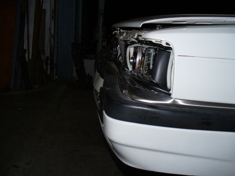

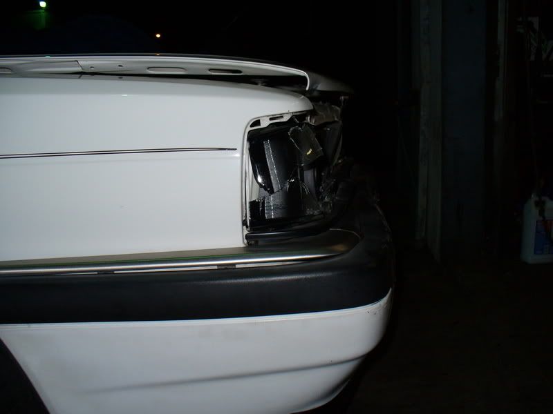

derracuda
Post by derracuda »
uhh......
that's what happens when the car in front of you doesn't GO WHEN THE LIGHT IS GREEN..... gah
HT Motorsport
Posts: 350
Post by HT Motorsport »
DOH DOH DOH.... Weep!
Posts: 1587
you can rebuild her, you have the technology
Wizard-of-OD
Post by Wizard-of-OD »
UR-Q FENDERS!!!!!111!eleven!!
IanRota
Post by IanRota »
owwee.... :o
welp... at least... nope I can't see a bright side right away... that sux dude! :(
you'll build it back... :-)
dspl1236
Post by dspl1236 »
i see the other party had a 2'' hitch
