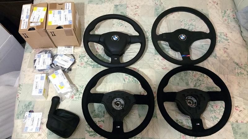

I haven't been home in FL for about six months. That means the E36 (Dad's, not mine), E46, E30, and E24 haven't gotten any love lately! Upon arriving home, I beelined to the pile of parts I have amassed over the last six months. I ordered some for "investment" purposes, others for repair, and some just because. I now have two brand new M3 Sport Evo (real) suede steering wheels, Sport Evo suede illuminated shift knobs, matching Sport Evo Bison leather shift boots, and OEM retrofit kits for the lighted knobs. I bought all of this stuff because there is very little supply left. I hear there are less than 10 knobs left from BMW. They are pricey, but are a major wear item and I suspect that Sport Evo owners who may want to freshen their cars up a bit in 20 years when they are worth well north of their current 150k+ prices will pay a pretty penny for them. Or maybe not! Maybe they'll want to keep the cars original. If so, that'll be fine with me. I will use them for my own enjoyment
I also bought a leather version of the Sport Evo wheel for me to actually use. The leather holds up so much better than the suede and that wheel is to die for in terms of design and feel while driving.

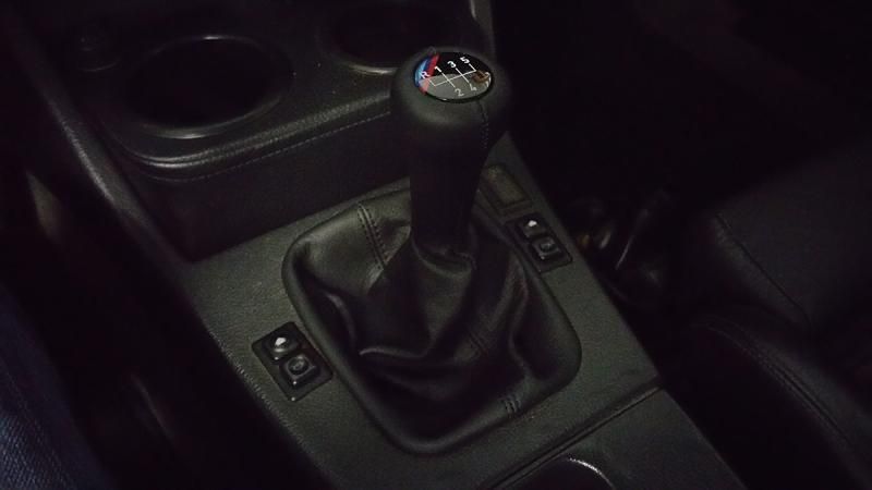

I also bought a new OEM regular M3 knob to replace the crap that came in the car. I installed it that same night.
It's always a nice sight to come home to this car in the garage.
Old vs. New
It feels so much better now.

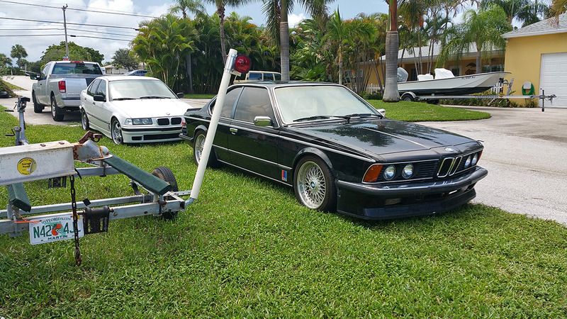

The E24 (635csi) hadn't been moved for that entire time because of a no-start condition. Luckily my friend Justin (turbo E30) was able to diagnose it. He claimed it was a bad fuel pump, so I bought a new OEM pump and filter.
The morning after I got home, I promptly installed the pump with very little drama other than taking some fuel to the face/mouth in an effort to make sure the pump would be primed properly when I attempted to start the car. The car started right up on the first try (after procuring a new battery), not that I didn't expect that what with the M30 engine's rock solid nature, my excellent mechanical prowess, and Justin's mastery of diagnosis
Here it is out of the overgrown spot in the yard it was sitting in for all that time... the poor thing still has grass cuttings all over it from the lawnmower. I suspect my Dad will tend to that situation soon now that it's back in the driveway again. I'm glad that car has no interior in it right now because bugs were definitely able to get in easily in the area I still haven't patched in the floor

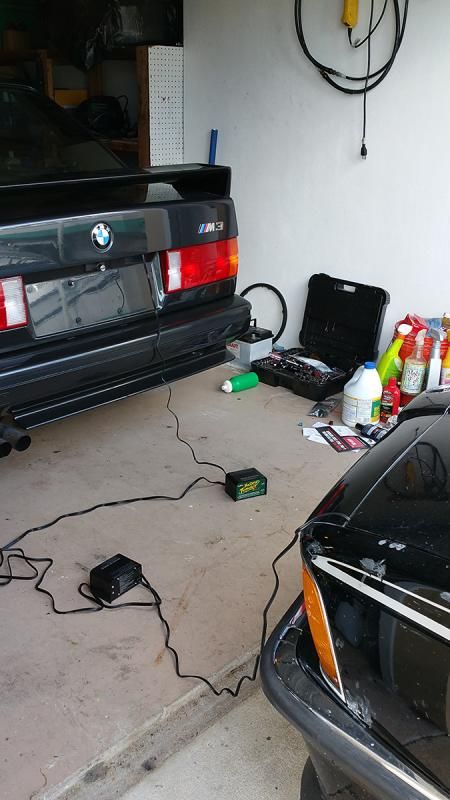

My Dad also informed me that both the 635 and the M3 had bad batteries, so I went out and bought two new ones along with two Battery Tender Plus battery tenders/conditioners. I have gone through enough batteries between cars and boats in the last 5 or 6 years that I finally decided having a few of these would be a worthwhile investment. I'm hoping they keep these batteries fresh for years to come regardless of possible power draws in the cars. I have one on the M5's battery in PA too. They seem well-built and I expect them to do a nice job for a long time.

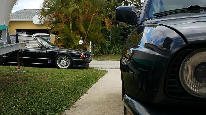

The E36 doesn't need anything other than two new rear tires, so that's a relief! Keeping the "fleet" up is a lot of work! That car is a true joy to drive. It is set up with stock M3 springs, but Bilstein sport dampers up front and Sachs M3 dampers out back. It makes for a really nice ride that's firm, yet compliant and handles quite well. Solid front control arm bushings from Treehouse Racing are a little harsh too, but having 17's on the car with decent meat on the sidewalls means it isn't too much to live with. They provide extra castor and help the car track straight with no signs of a shimmy (BMWs are notorious for shimmies because of front control arm bushings!) Anyway, I love driving that car. It just needs an LSD to be truly great. An E46 M3 S54 engine wouldn't hurt either

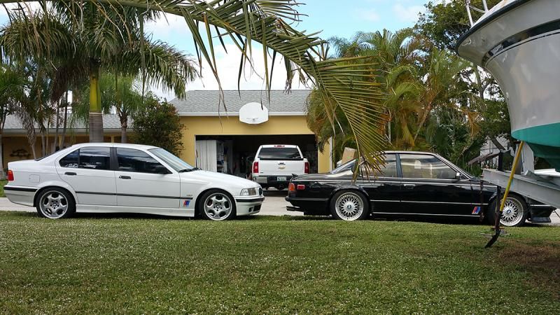

Here it is looking it's best next to the 635csi.
It definitely needs an M3 front bumper (and maybe rear) to come even close to the sexiness of the e24 (at 30 feet

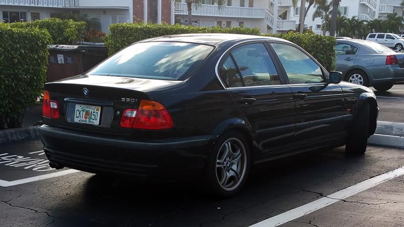

Finally, I made sure to drive the poor unwanted E46. I'm pretty proud of how I took the car from being a total basket case to being mechanically perfect now. It drives like an absolute dream! Gone are the clunks from the rear diff (solved by poly diff bushing), oil leaks (valve cover and oil filter housing gasket), loss of coolant and terrible, terrible noises (water pump), broken windows (two new regulators), steering shimmy (poly control arm bushings), other rear clunk (new rear struts and strut mounts), and much more. Unfortunately, it has cosmetic issues inside and out. Probably another thousand dollars would fix all or most of that, but then I'd probably have more in it than it's worth. I'll let my Dad decide how he wants to handle it (I kind of gave it to him as "rent" payment for letting me live at his house for free for a year).
Not it's best pose, and not clean at all (thanks Justin!

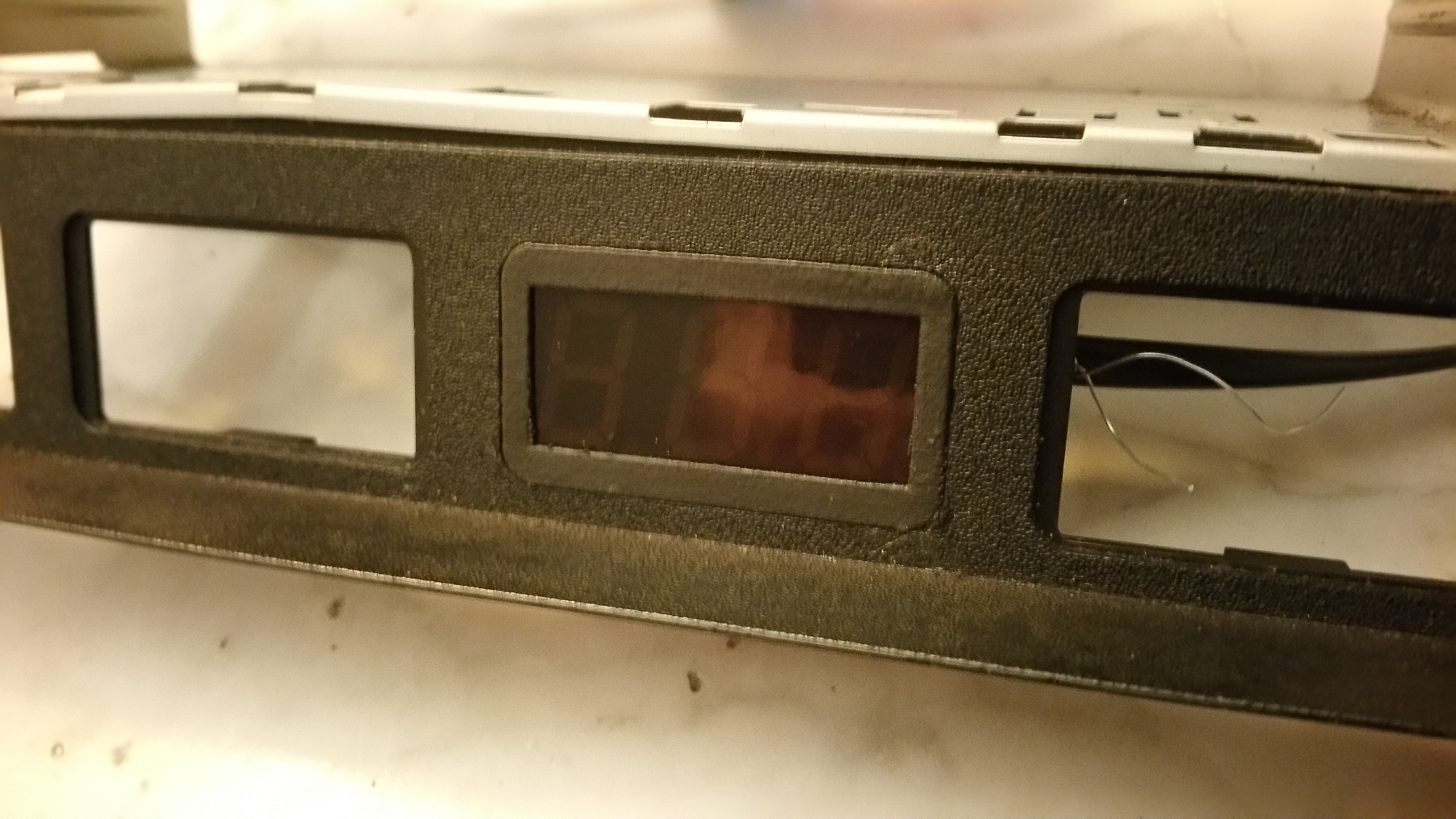

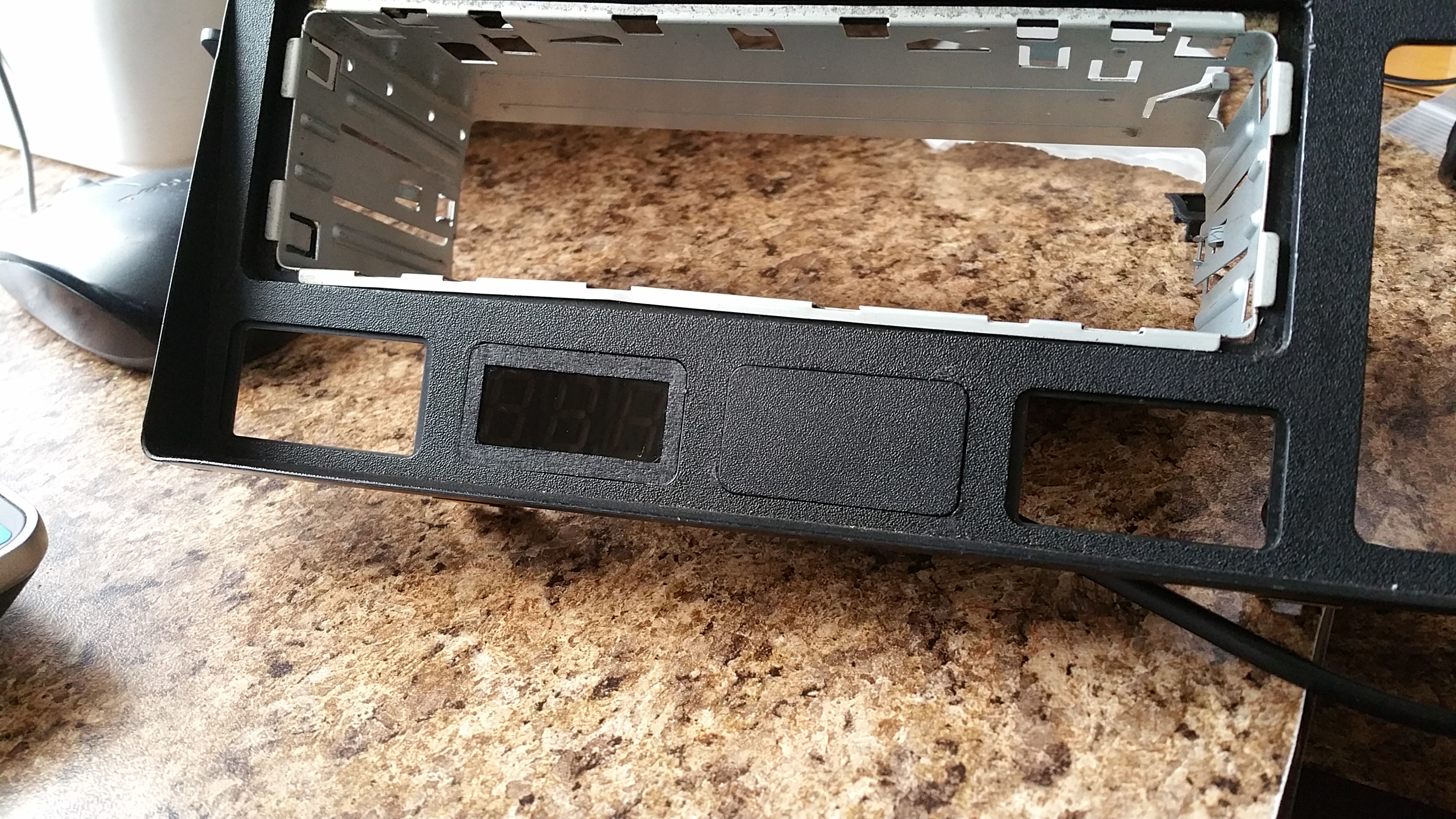

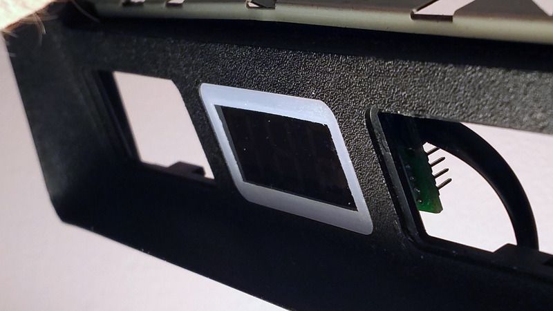

I've finally finished up that wideband gauge project I set out on last year. The only thing keeping it from working was more accurate 3d printing capabilities, so I finally but the bullet and had solid concepts print it out for me. It ended up costing waaaaaaay too much, but sometimes that what it takes to get a good prototype. It isn't perfect, but it's the best I've seen from this technology yet.
I applied a film to the front of the gauge, inserted, and all was in order
Now to install it in the car next time I'm in FL (I was just there over the weekend, darn!)

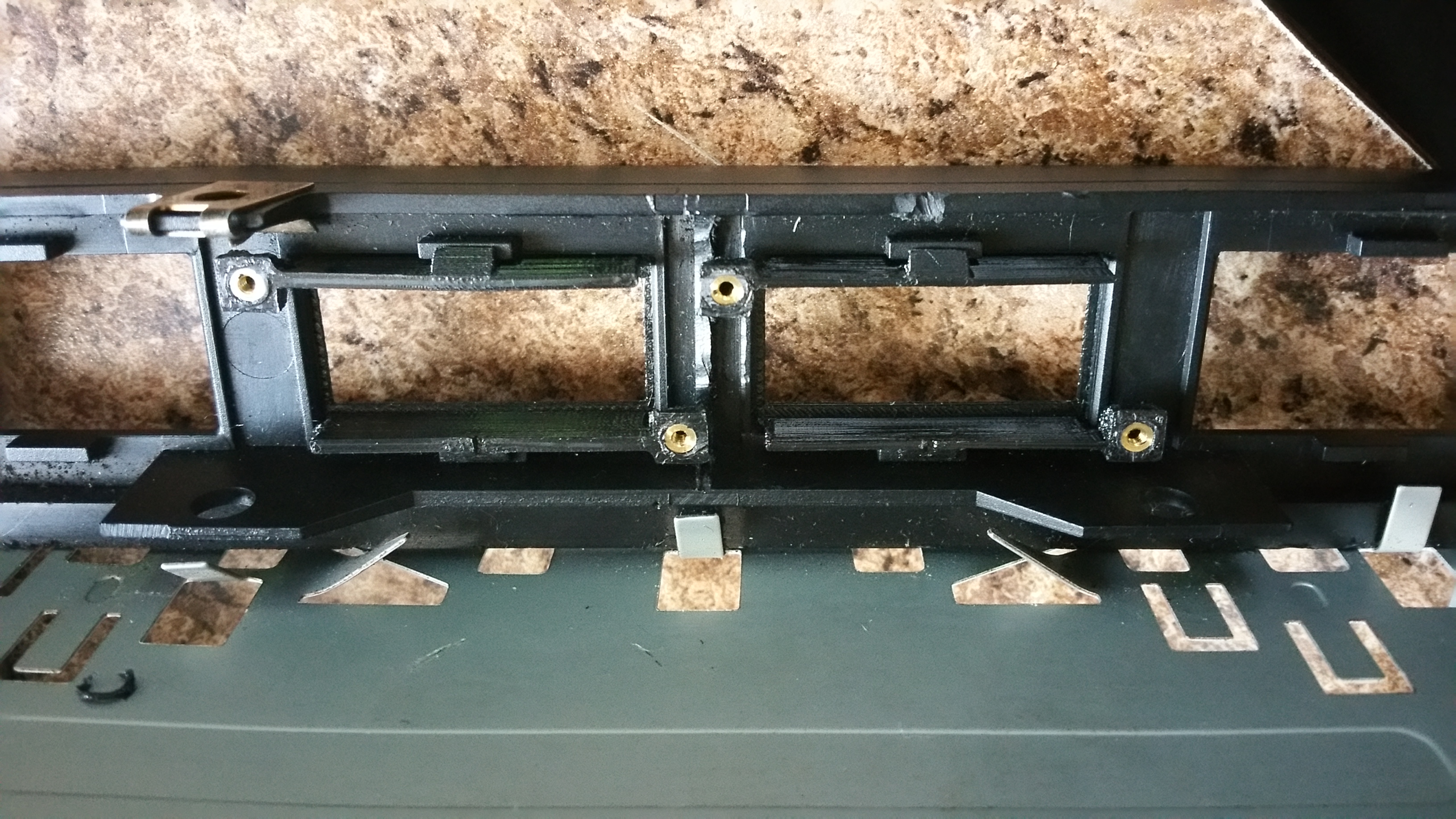

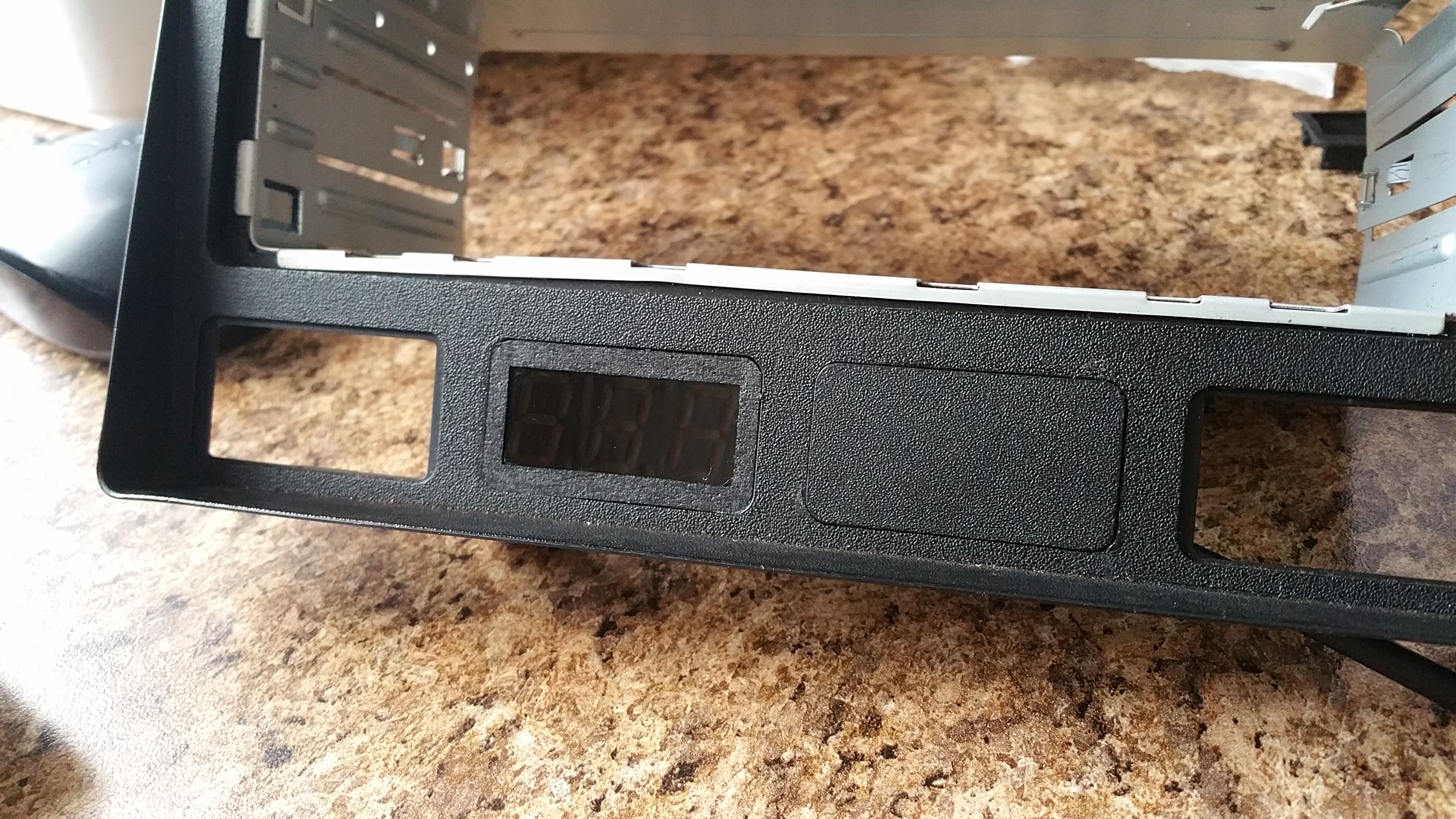

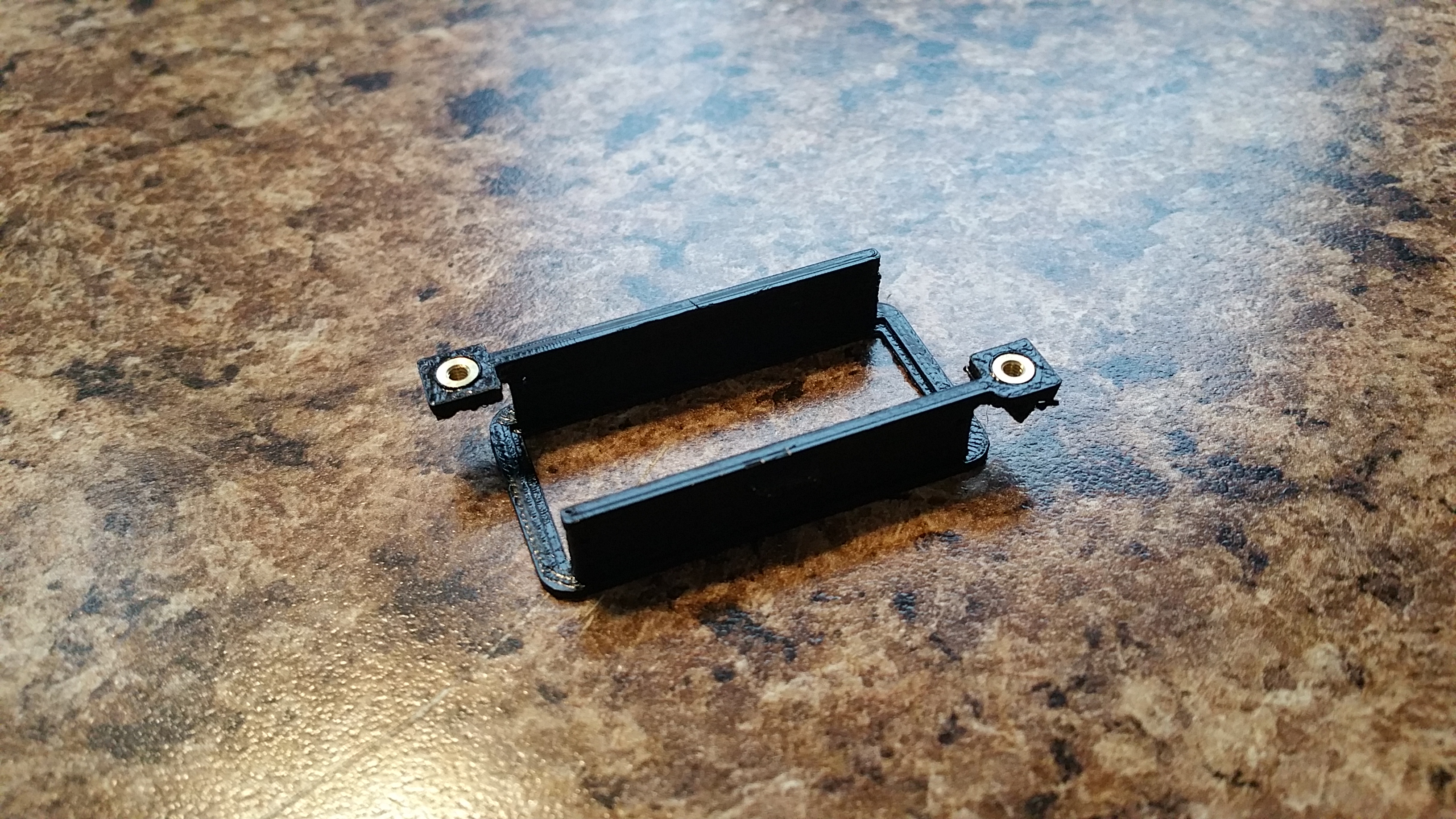

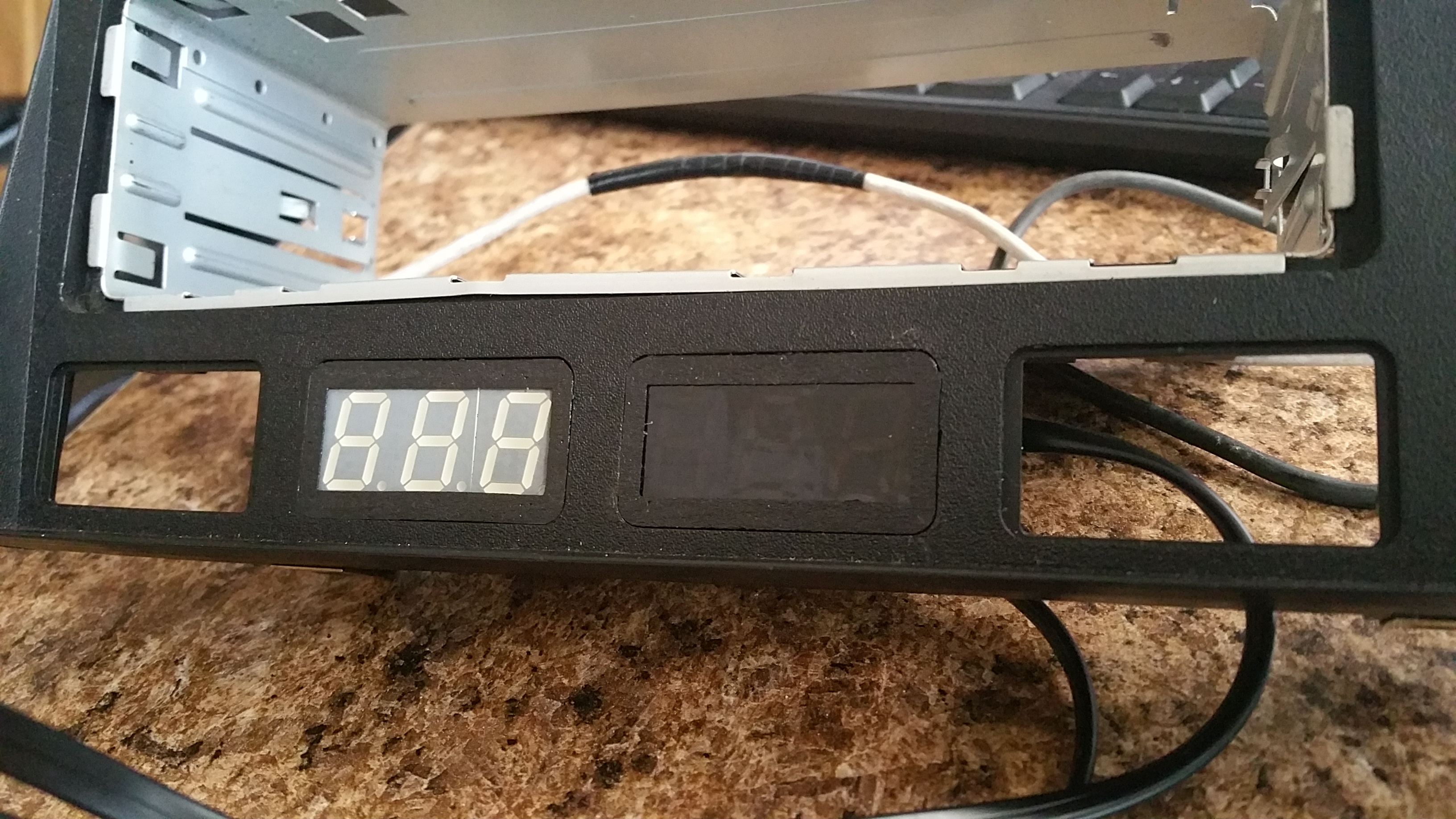

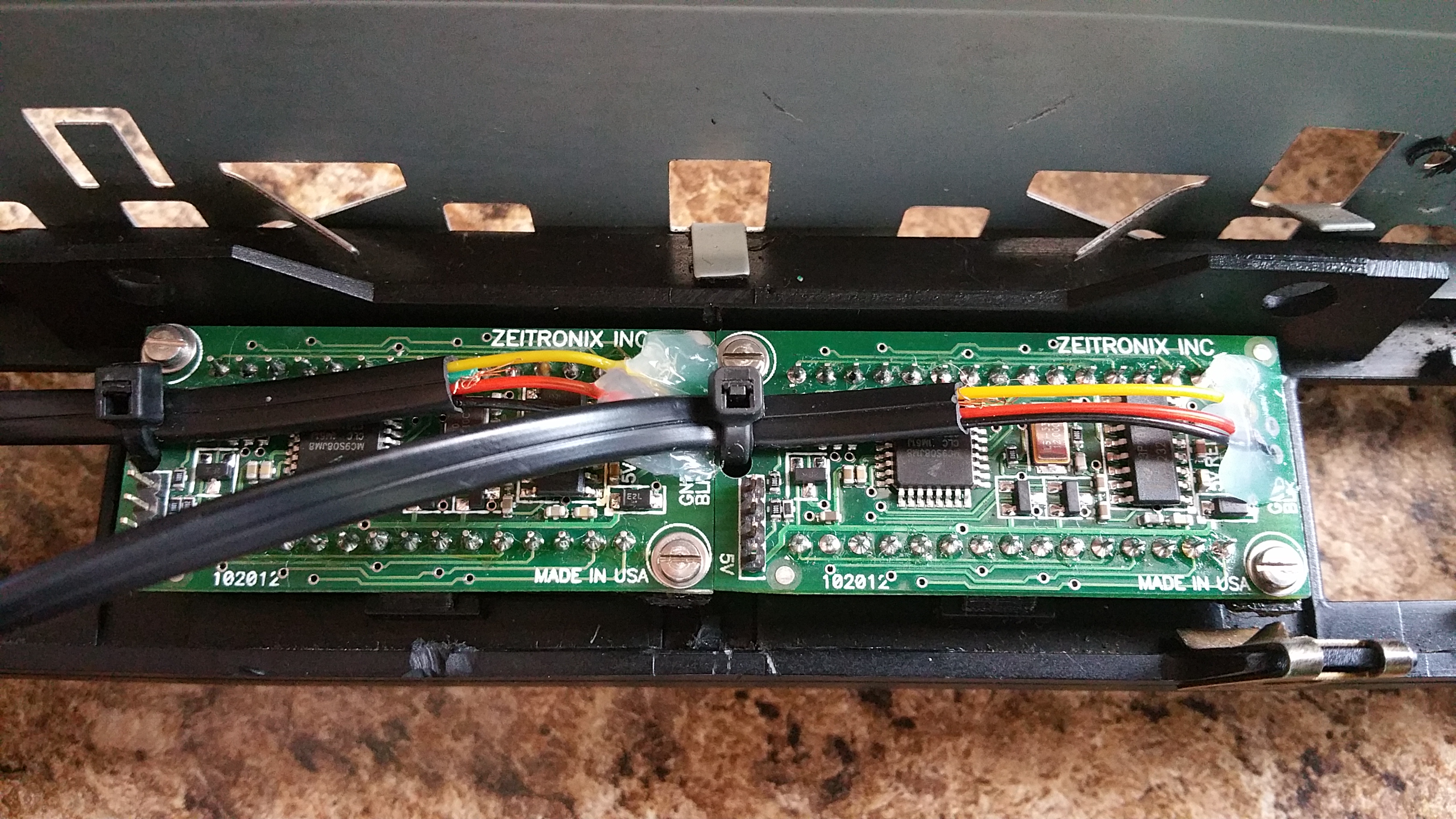

Just wanted to show the finished product of my zeitronix wideband panel blanks for 80s and 90s BMWs. I'm not sure exactly which cars has panels like this in them, but I know they work with e30s and e24s at least which probably means they work in e28s and early 7 series as well. Maybe there are others too.
I was compromising in some areas before, but now I've got a design that I really like and don't feel needs any changes. The panel itself mounts in the dash with two clips. Then the display mounts to the panel blank with screws and brass inserts. When the number display is inserted into the panel, it makes the panel impossible to remove providing for very secure mounting.
Mounting is flush and with fitment comparable to the stock panel blanks. The finish is textured. It isn't exactly the same as stock texture, but it is as close as I can get with this method of manufacturing currently and at the price I can produce them for and it still looks pretty good. It is only noticeably different in how it reflects light at certain angles of incidence. The blank panel next to it is OEM.

Is that for the hacker display? Very cool
Re: Chris' BMW Projects
Yep! If you have an idea for somewhere you want to put one of those let me know and I can probably help you out with a design and make some for you.

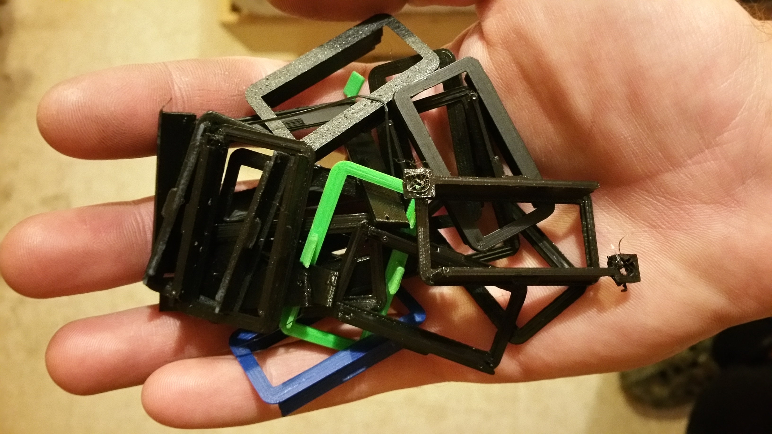

Here are a few more pictures
Failures lol
Failures lol
