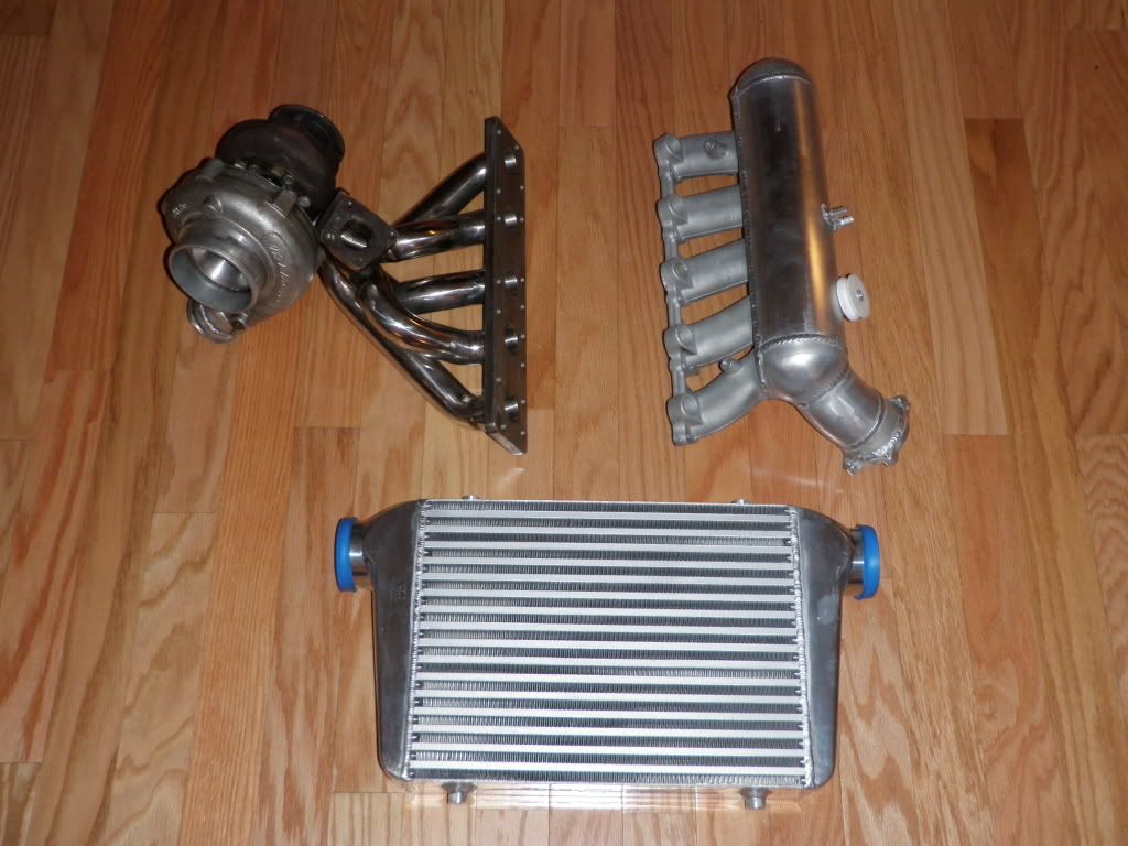

FS: $4,500 Casey's 200 20v

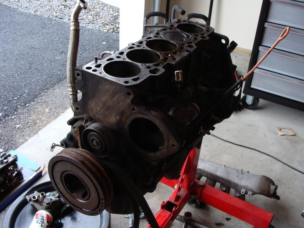

Block looks like it's still got factory paint on it?
yodasfro wrote:Block looks like it's still got factory paint on it?
on the driver's side of it yea

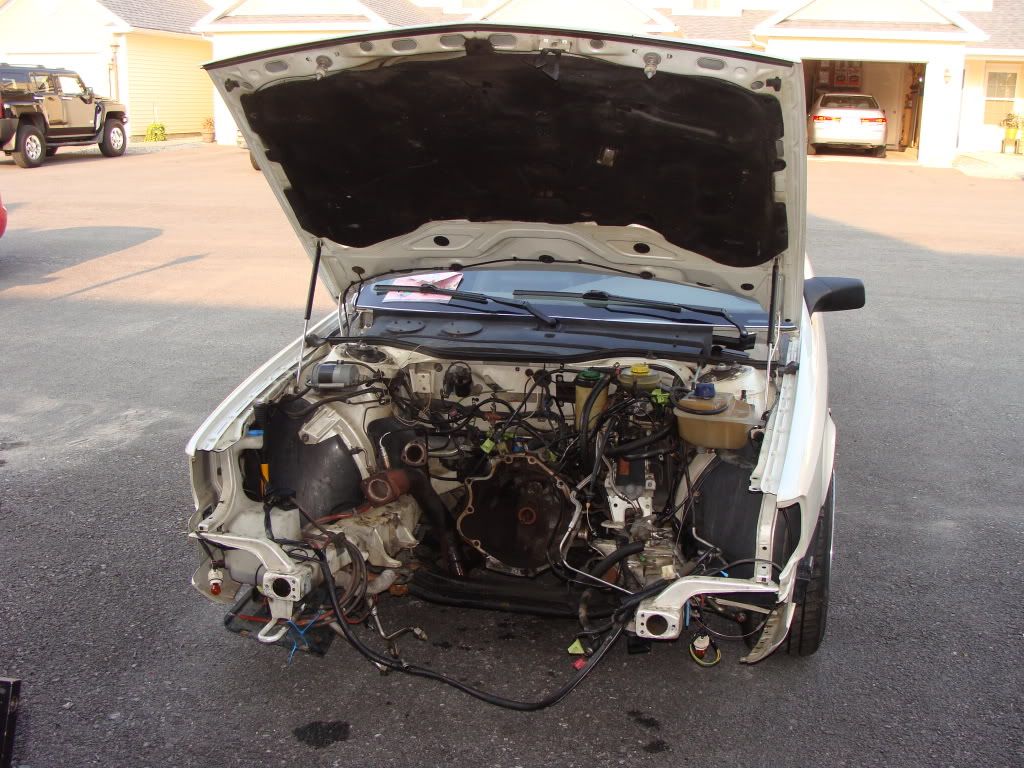

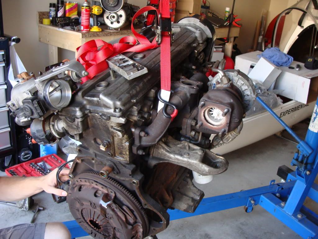

Well I finally found an engine hoist to borrow, so out came the motor!!

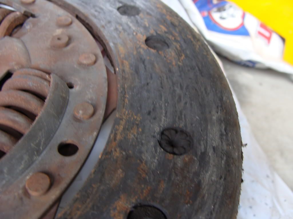

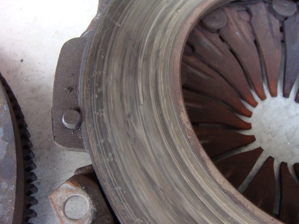

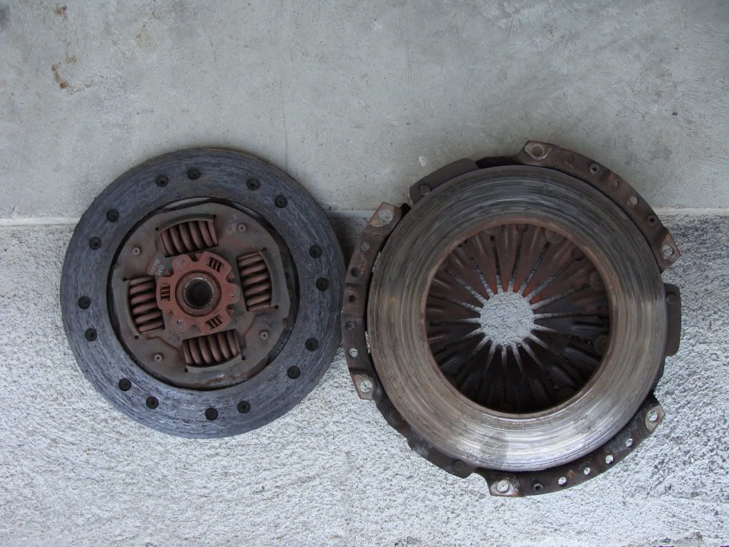

Clutch was definitely toast...

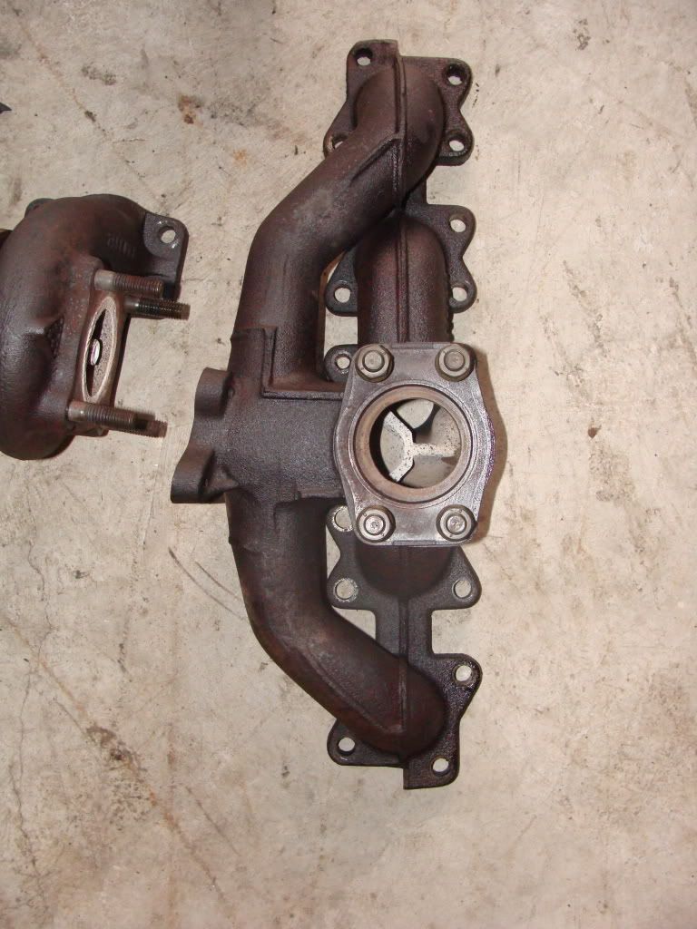

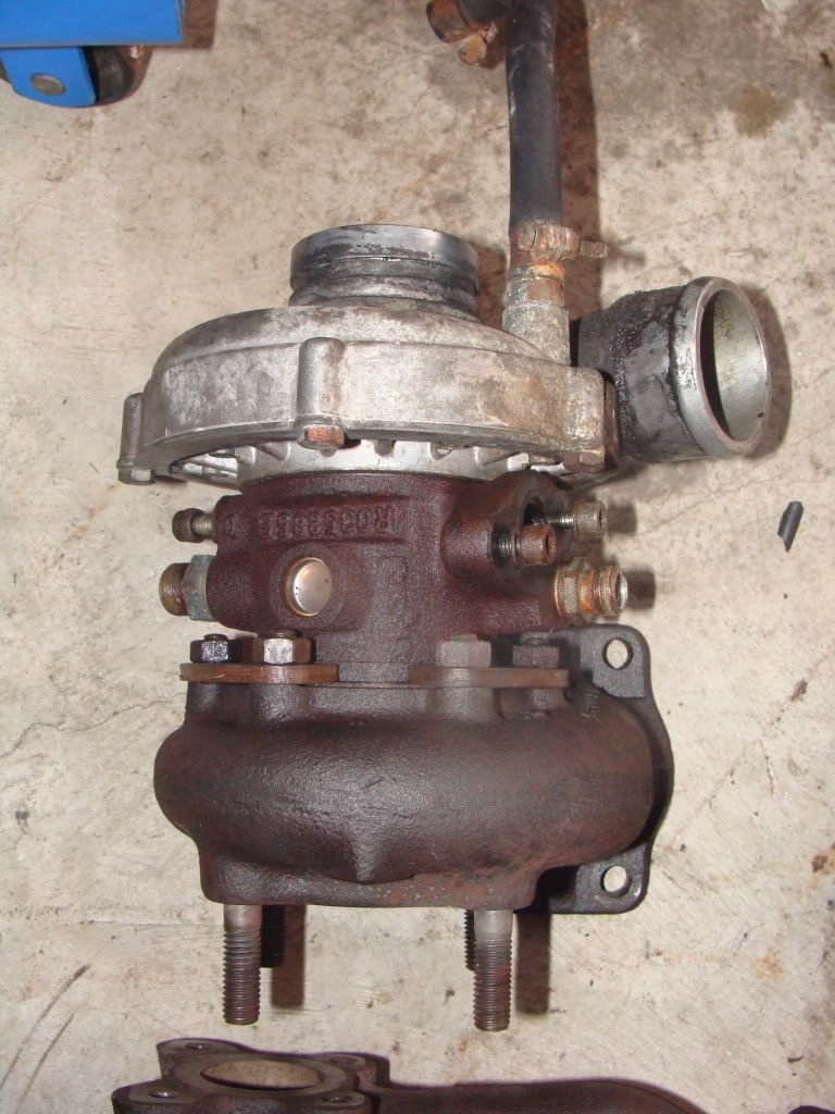

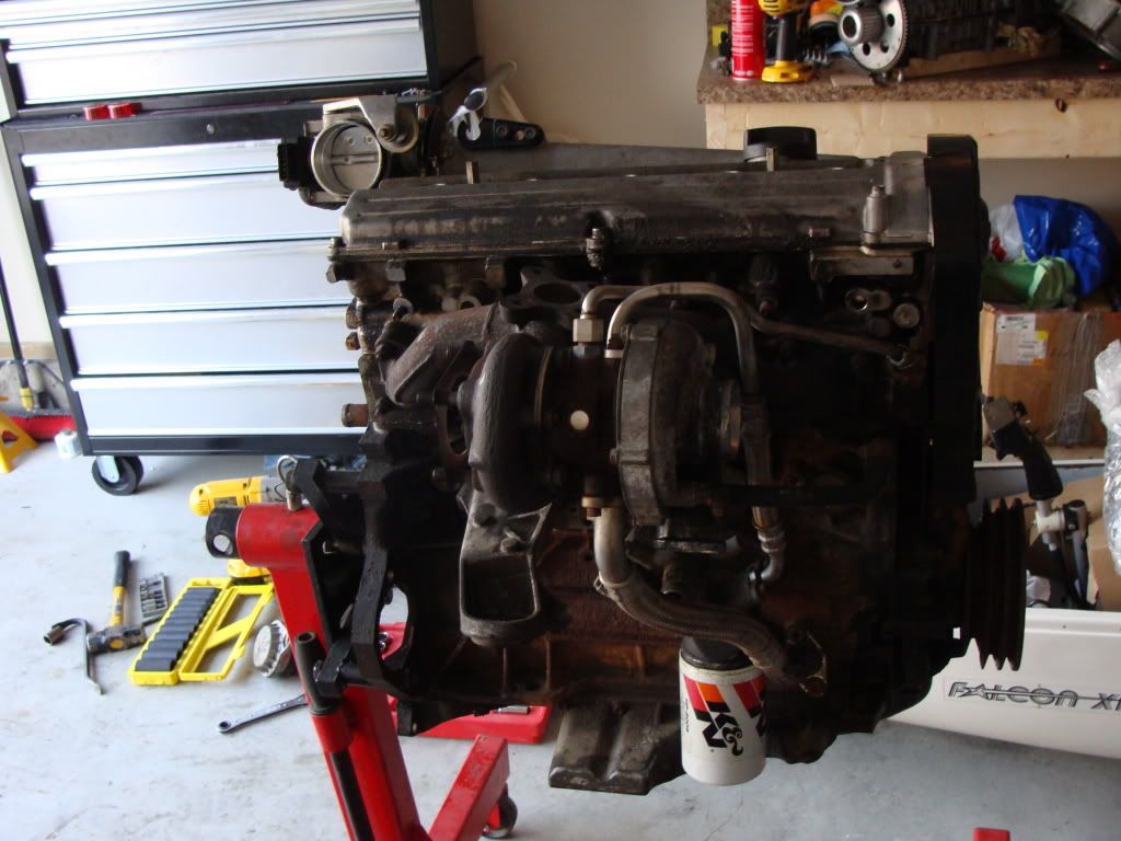

And some random shots

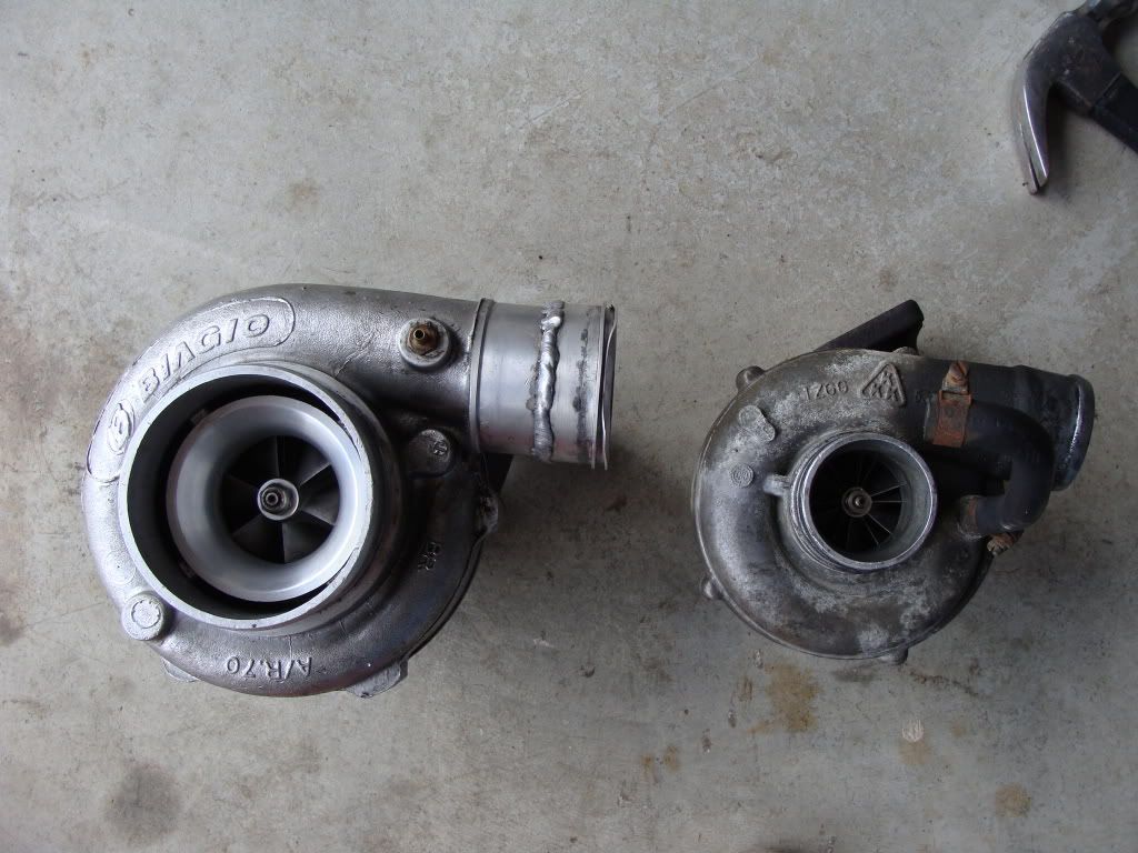

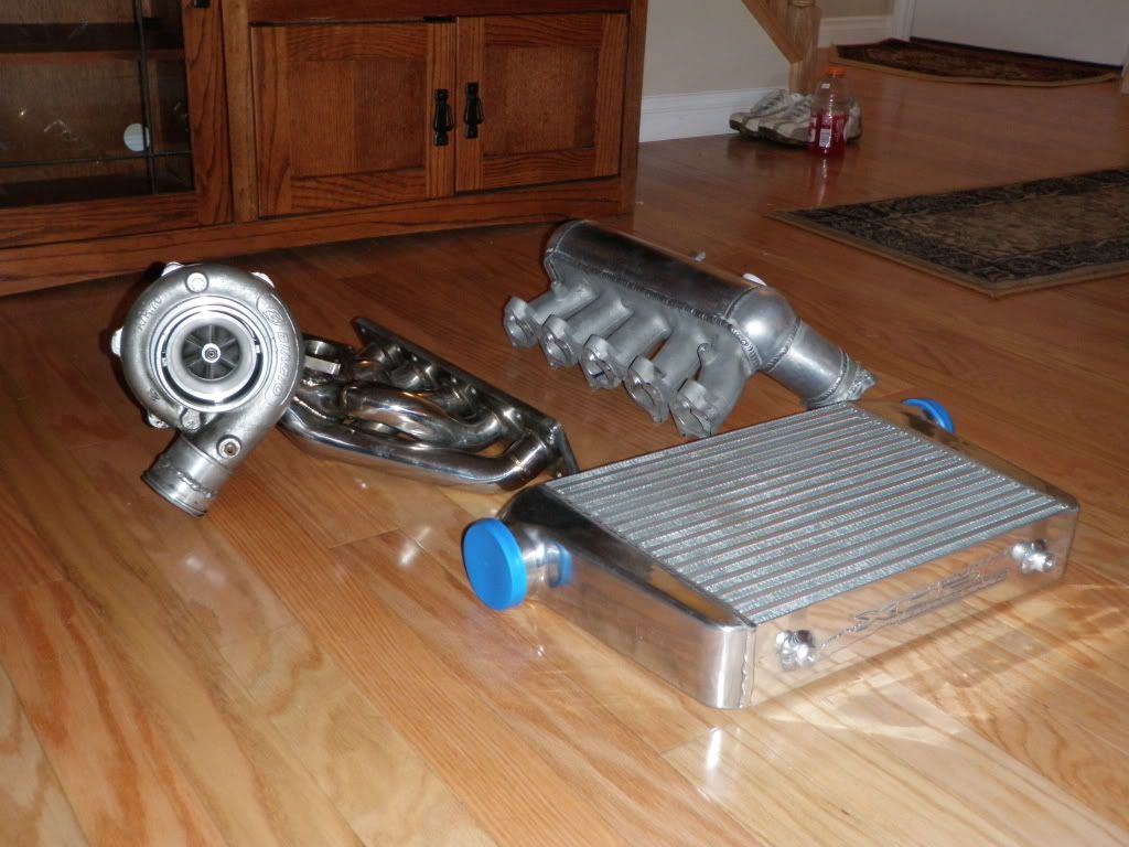

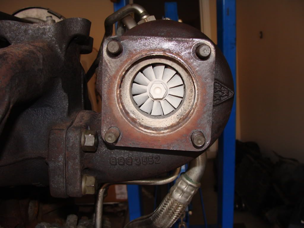

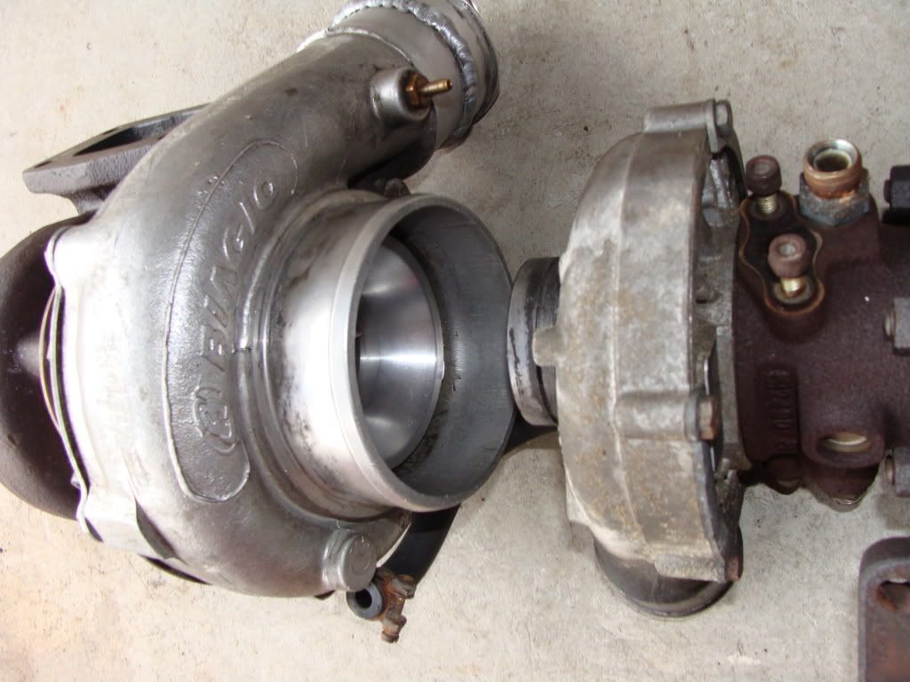

BIIIIG turbo
OM NOM NOM!!!

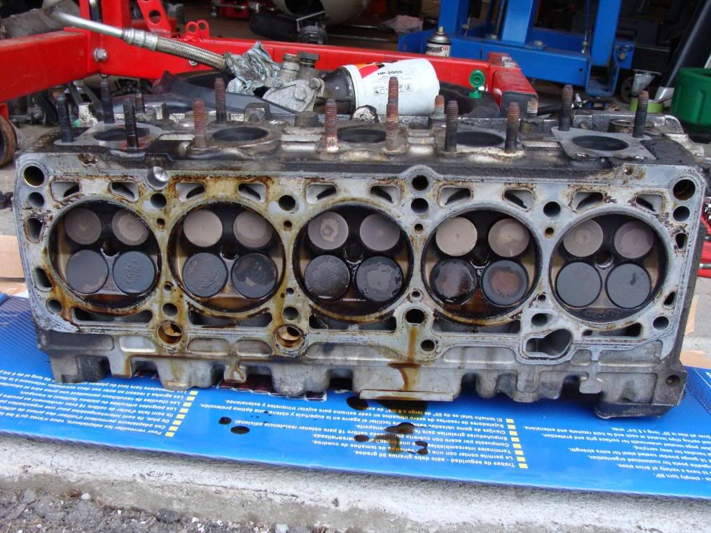

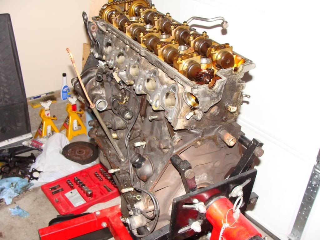

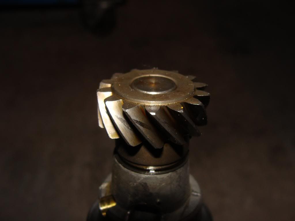

Took some more time today to get the top end of the motor apart - here's what it looks like!
Firstly, metal distributor gear FTW!

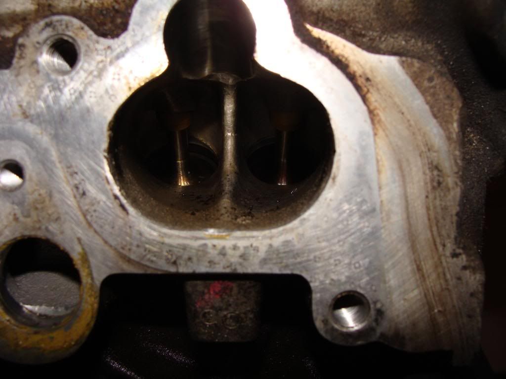

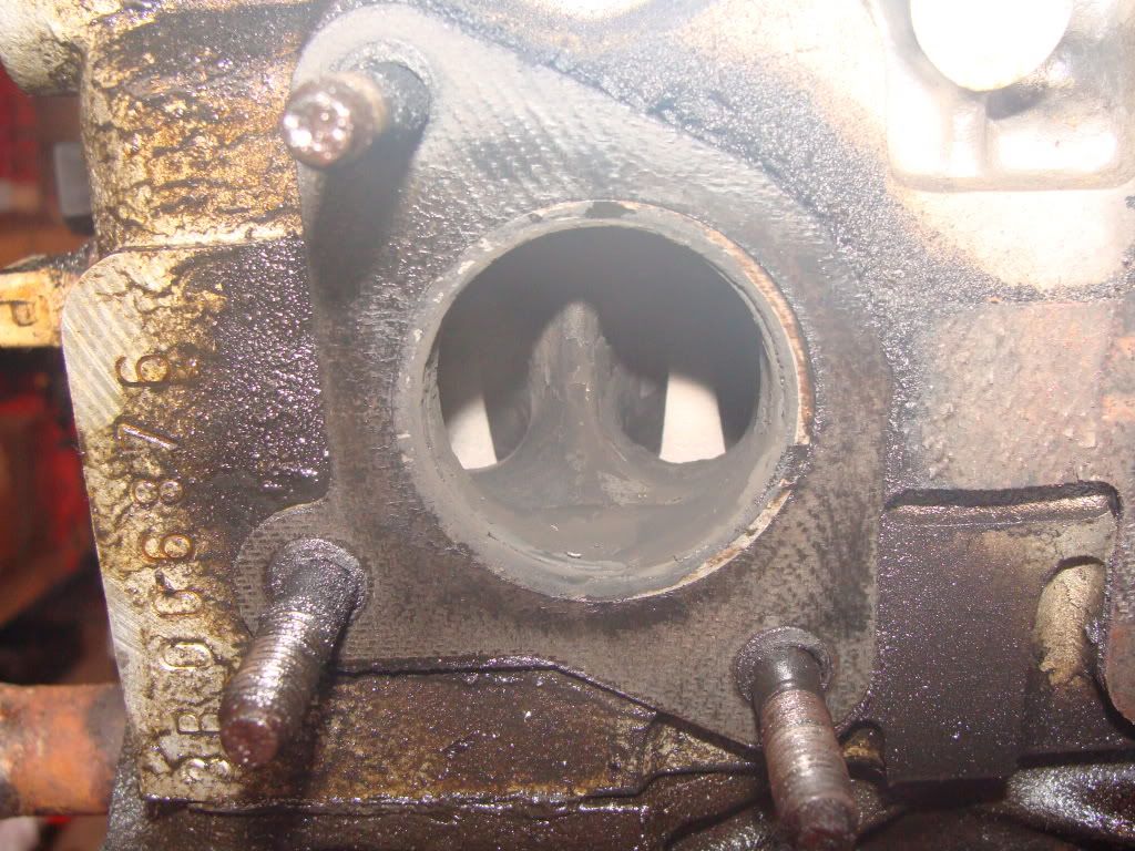

Clean intake tract

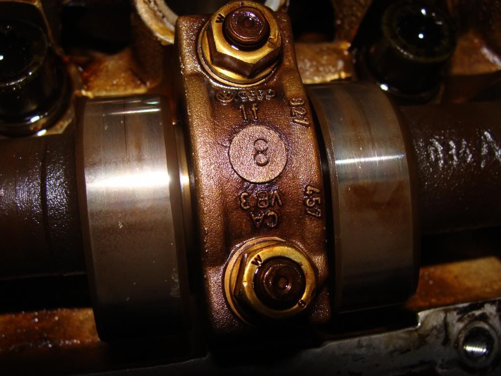

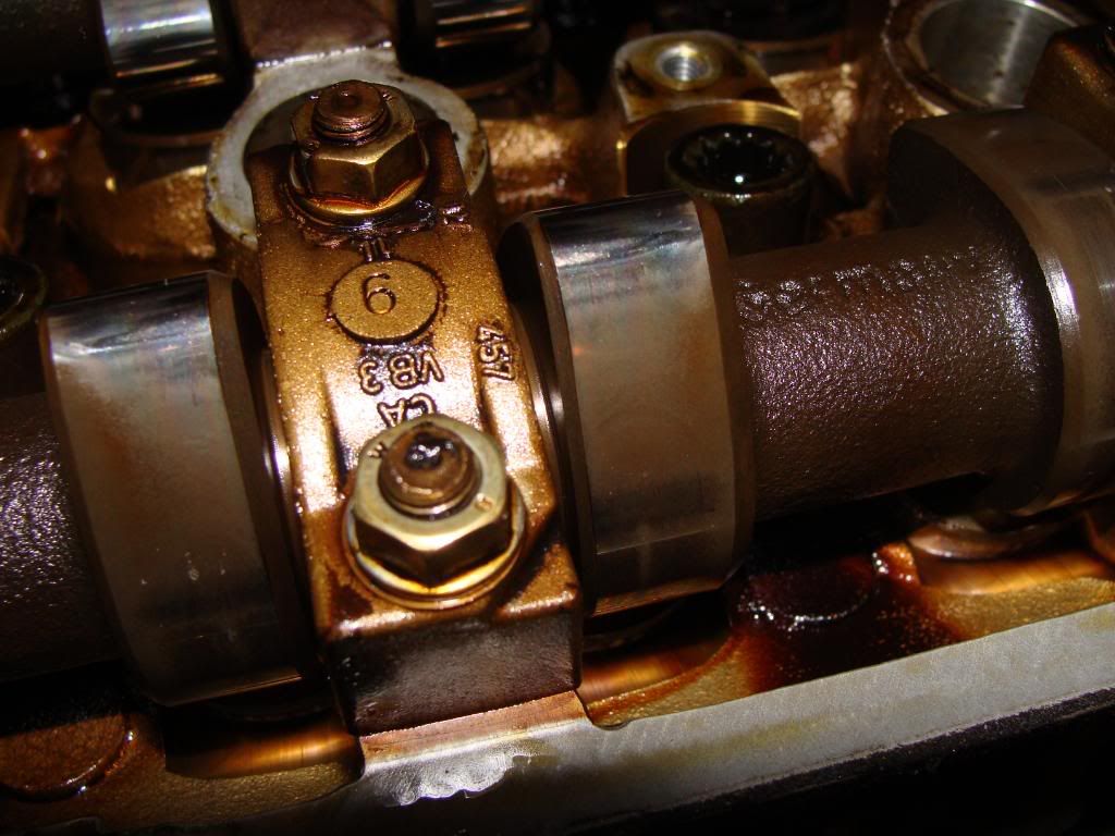

Cams do these look a bit rough? - thinking some 7A's will find their way in
So far so good...

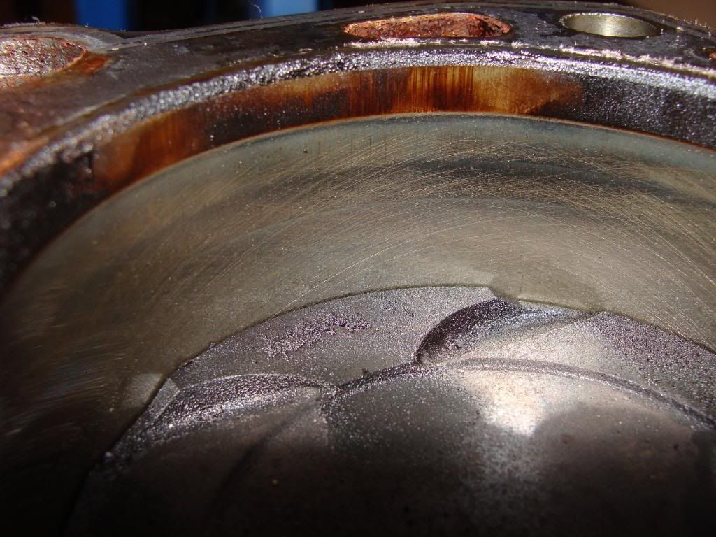

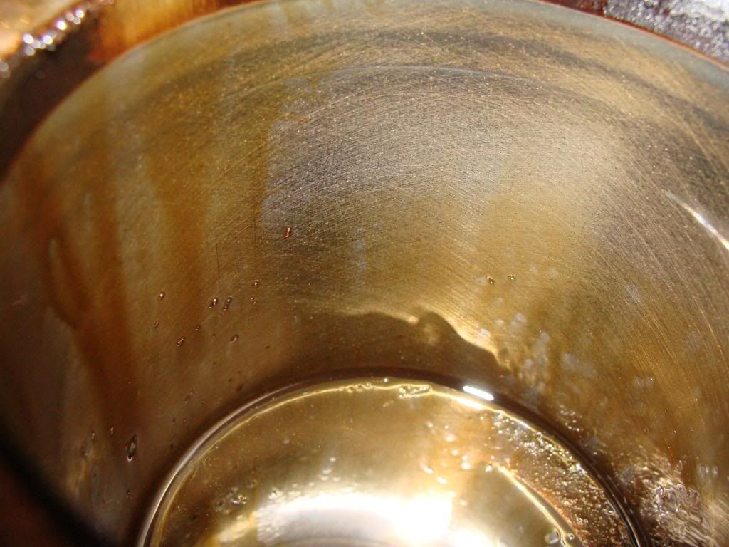

Here's how the bores look - oil is from removing the spark plugs with a failed valve cover gasket
254k miles!
Posts: 2144
Those bores are in amazing shape!
