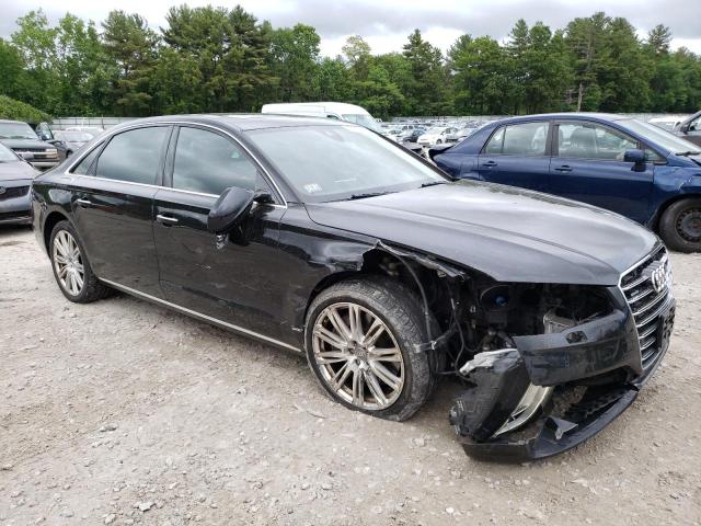

Just picked up a c5 RS6 motor for the car. Going to pull the motor and swap to factory me7 (we tune these all the time). Turbos will likely change while I’m at it from what’s in there now.
Kinda excited to revive this thing. Needs a thorough interior cleanup and probably a vinyl wrap.

Re: Marc's 1990 4.2L V8 Twin Turbo Coupe Quattro
got the nose pulled this weekend. Cooling system is going to get a major re-work. not enough fan area so i'm likely to add an additional auxillary radiator to the passenger fender area.
looking over the c5 motor my primary area of concern is clearance to the brake booster. the c5 has a lot going on back there in terms of coolant lines and EGR piping that will need dealing with. turbos i'm likely to get lazy and just use my existing manifolds with some better turbos. i just have to confirm the manifold flange is the same.
I tripped, fell, and decided a 4.0t was a better plan. Shorter better packaging and more efficient
What year 4.0t did you grab it from (does it matter all that much?) curious on the dimensions, that is going to be a wild package in a CQ!! Hope to see some build pics.
themagellan wrote:What year 4.0t did you grab it from (does it matter all that much?) curious on the dimensions, that is going to be a wild package in a CQ!! Hope to see some build pics.
2015 A8 from copart. wreck didn't even break the cooling system.
- donor 2015 a8
