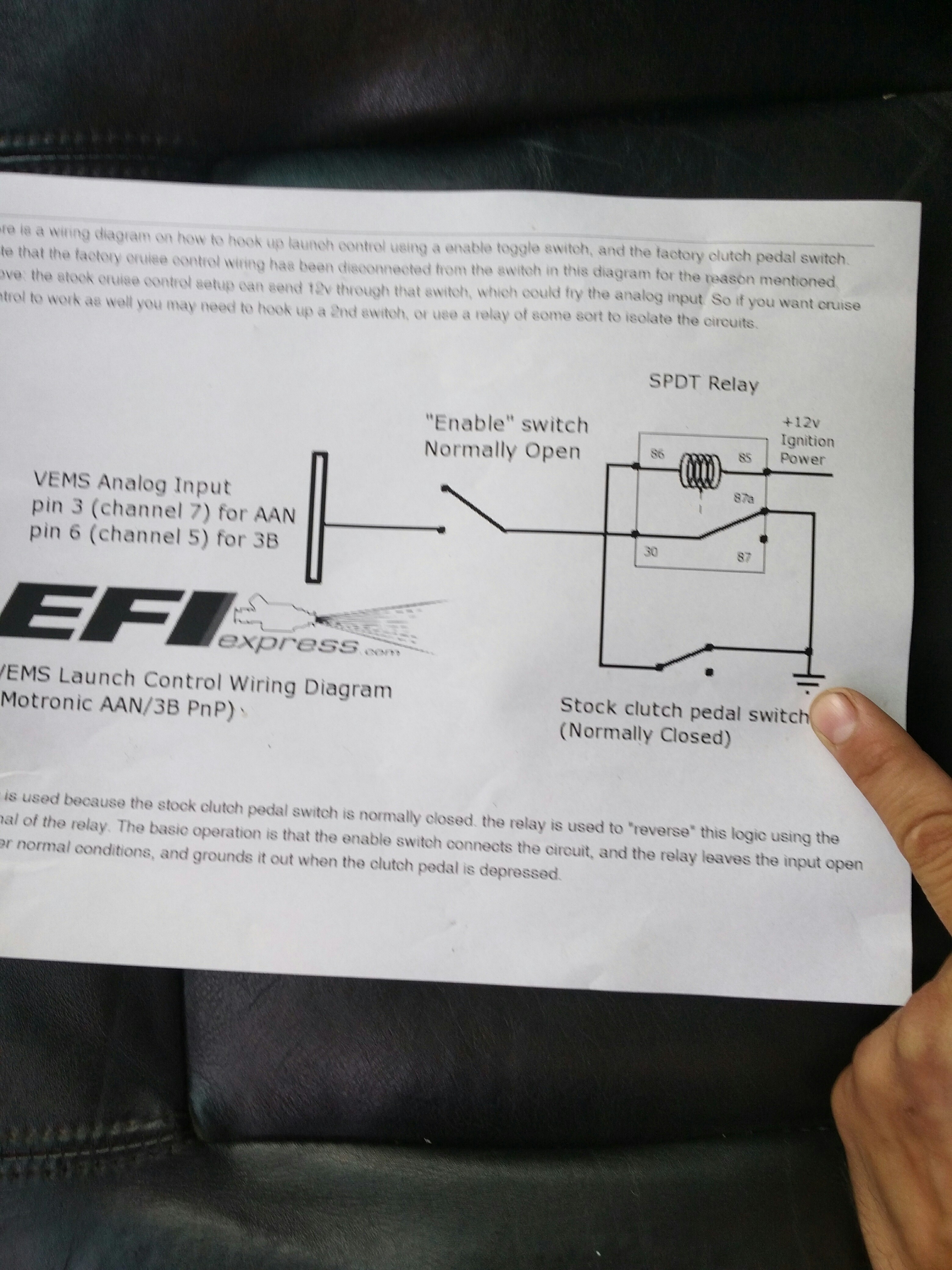

Hey Marc, just a quick question. Is it safe to use this spot I'm pointing to in the main ground of the LC circuit to actuate a regular relay that will interrupt another separate circuit when in use?
