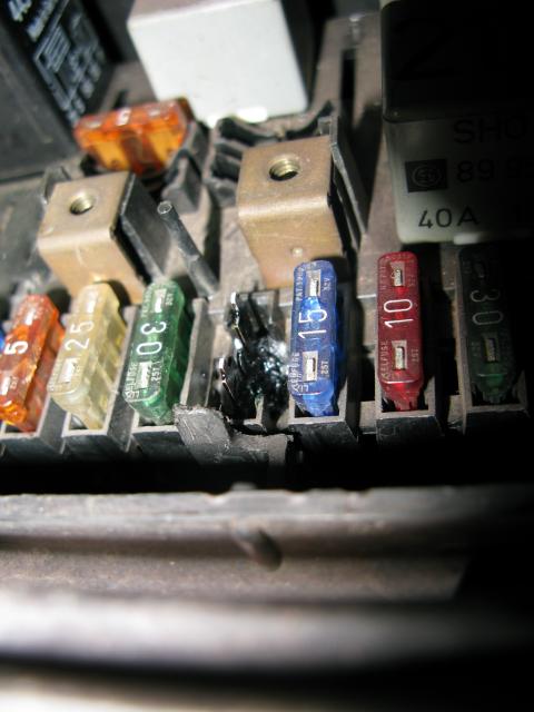

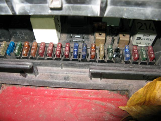

while I was at it, I also wanted to figure out why my HVAC blower switch stopped working completely. All the connections were good so I checked the fusebox. Hmm, #17, lets see, can anybody spot it?
hmm, somethings not quite right there
PSA: its ok to buy tools from harbor freight, but refrain from buying things like fuse kits. mkay?
Nope...it looks like it is gone, as in up in smoke. LOL Did it actually melt the plastic or did you break the plastic trying to get the fuse out?

quattro87 wrote:Did it actually melt the plastic or did you break the plastic trying to get the fuse out?
I am pretty sure I see a pool of plastic (black?) at the base of the fuse. I'm glad I have oodles of good, used VW fuses on hand.

Harbor Freight fuse kits are extremely dangerous! I've seen 10amp fuses support 30+ amps before popping.

marc, you're number 17 fuse looks like my #5 holder on my beater 4000Q. In order to get the fuse to work, I have to bend the tabs of the fuse so they touch whats left of the metal in the fuse block, good stuff :bashtard: I really would like a ride in this beast at Carlisle this spring, or, perhaps if you have a beer or too, I could pilot it :D

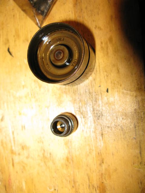

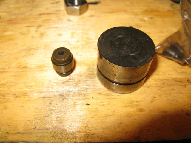

started putting the heads back together tonight but I've got a problem. there is a part in the bags I put together when I stripped them down last year that I dont recognize!! Cant find it in etka either. Looks like a mini-lifter but for the life of me I dont remember removing it. Bueller? (lifter for scale)

Just one of them Mark, not 2? (I have no Idea what that is BTW, but if only one not 2 probably means something ;)
Posts: 1587
I just checked. one. and it was in the bag marked for the passenger side head.
naudi80quattro
Post by naudi80quattro »
looks kinda like a cap that would sit under a cam that is if the top was shiny. :?
Posts: 1587
naudi80quattro wrote:looks kinda like a cap that would sit under a cam that is if the top was shiny. :?
top is shiny. definitely looks like a mini-lifter in that regard, so it likely sits under a cam but there is no hole for it that I can find.
yodasfro
Post by yodasfro »
Look like the center to a lifter but not a v8 lifter.
Toxcheap
Post by Toxcheap »
looks like the oil squirter jet for the head
In my head 20v it actually blew out once and got cut in half by the cam, I found it in my oil pan after searching for loss of oil pressure. it was easy to replace.

Center of 5 cyl. lifter for reference :wink:

Yoda, I think you hit the nail on the head. I did take apart a pair of junk lifters that Janis gave to me for the flow bench rig used to set the valve lift points. maybe it fell into my bag of parts? that pic looks just like it. Thanks!
yodasfro
Post by yodasfro »
That's exactly what I hypothesized when going back a few pages in the thread. :-D
my mistake i mixed up the 2 parts
MikkiJayne
Post by MikkiJayne »
It doesn't look like anything I've ever taken out of a 16V head, so I'd concur on the 'part of a lifter' hypothesis :thumbup:
