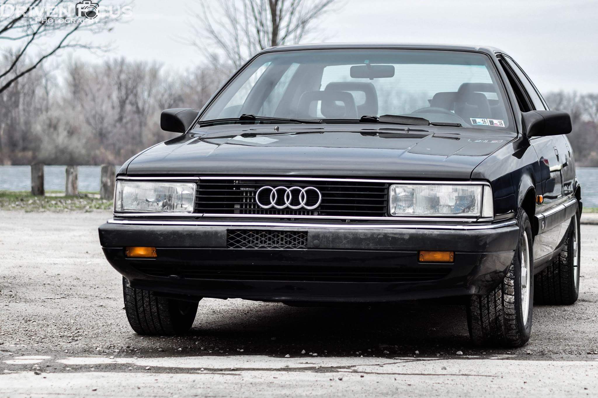

Look what I did! PID varies the max between 260 and 270 kPa. Between 13 and 14 degrees really punches me in the d##k in an enjoyable manner.
I've upped my meth % seeing as my injectors or fuel pump are running out :wah:
This pic is courtesy of my new friend Mike D. the photographer with a 1000 hp CL600.
His video is worth a watch that documents the cruise. There's even a nice pass with audio (instead of tunes) of my car at :45. My brother has the tuned red m3 convertible. Give it a look:
https://youtu.be/g71yyxjGRsU

OMG finally a nice picture! More please.
Why did I go larger? I don't know, I guess I'm just power hungry? I think the ideal setup for my car as a daily driver/toy would have been like Matt Sgambelluri's car. That's a retarded setup for the street. But, I had dreams of 10k RPM and a turbo that wouldn't choke up there, so here I am :)
Posted: Mon May 02, 2016 9:01 pm
Ride height doe...
Posted: Mon May 02, 2016 9:34 pm
by 88a5tq
I enjoy pulling to 8300. That's pretty nice. 10k is hard to imagine lol.
I could've driven OVER some of those cars hah. That shot is from the erie Peninsula where alot of people like to drive while smoking pot. Hell I was one of them about 10 yrs ago :) Anyway, there's 2 massive speed bumps coming onto the PI that they all had to swerve and go diagonal over while stopping traffic. I practically ramped over that shot lol. "Stilts stance" baby!
Posted: Mon May 02, 2016 9:37 pm
lol ground clearance does have its merits.
You have more balls than me to be revving to 8300 on a stock head. 8k is my personal limit until valve springs at least.
Posted: Tue May 03, 2016 12:04 am
by Aktapod
Looking good! I think these cars wear dark colors best. Excepting pearl white, of course! I have daydreams about painting one these in a shade somewhere between santorin and sepang blue. Anyways, I agree with Chris; more pics!
Don't forget, the cruise ship suspension has the added benefit of pointing the nose at the moon, so it feels even faster!

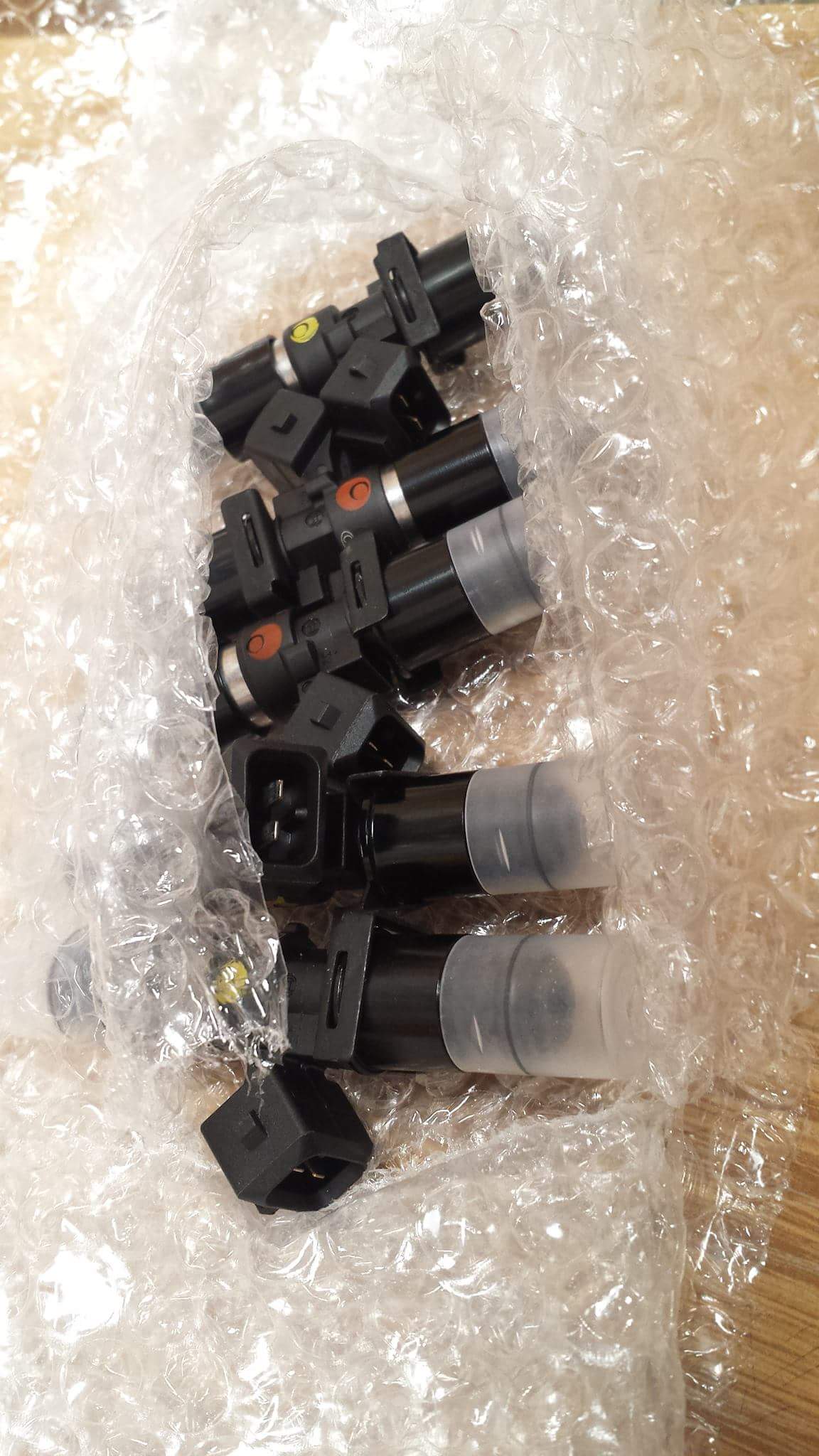

Guess what I DID! Chris helped too!!
THANK YOU CHRIS! Awesome deal man. They're in and I'm driving with the auto-tune going after I changed the e tire VE table to as close as possible judging by idle. Wooo! 1200cc FID injectors
