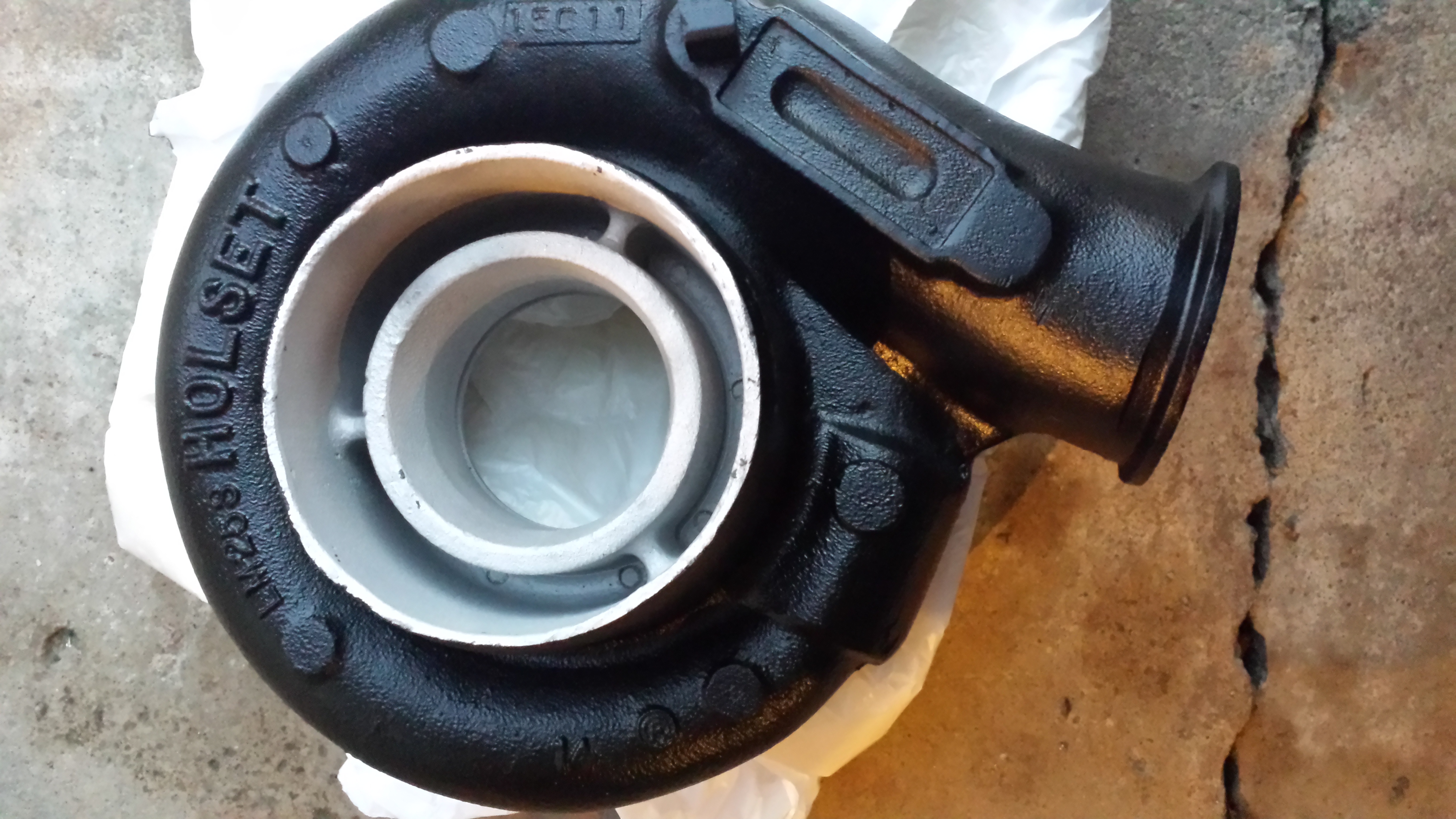

I haven't checked fitment yet. Should I be concerned that the OD of the smooth portion of the discharge pipe is only 2.5" OD vs the 3.5" OD of my current housing?
Posted: Fri Apr 01, 2016 7:29 pm
by 88a5tq
Am I crazy or did they sell me a 56 mm housing instead of a feckin 54 like he said he would? That's a big gap! :bangshead:
It only fits with the huge oring on the housing to prevent clearance issues with the compressor wheel

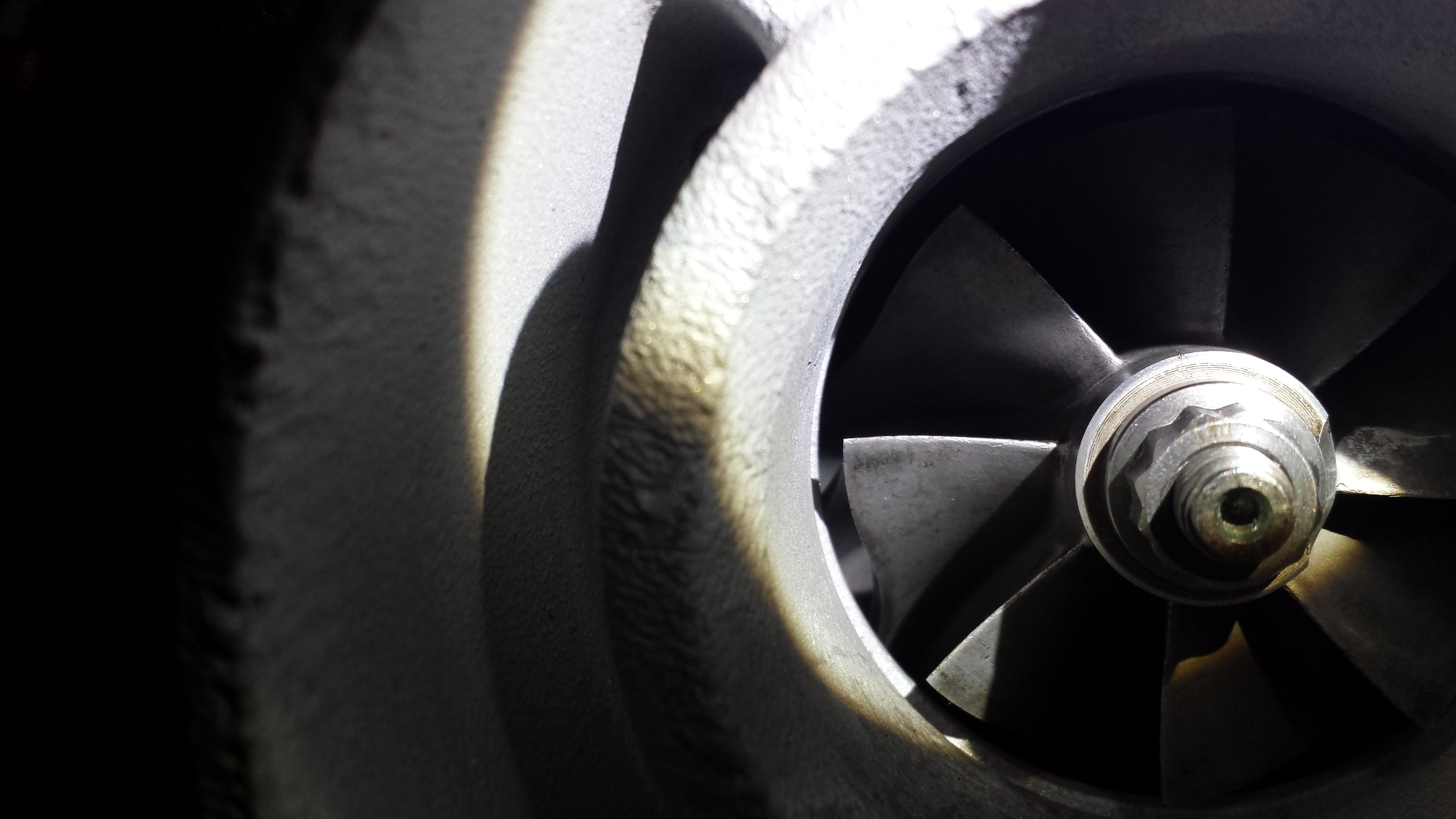

Whoa wtf?!
1.971 inches =
50.063 mm
That's my inducer blades measurement. Tiny?

WTH is this mutant turbo?
I don't get it. I never read anything about an HX35 being this small :nuts: Now I'm wondering if I should keep the compressor housing so that I can upgrade the compressor wheel to fit it. I have no idea if that's possible tho as there's no info easily found about modifying this small hx.
Anyone have any knowledge to bestow?

Kudos to goldfarb. Sending me the correct housing for shipping alone. "I thought it was the smaller wheel (54), not the SMALLEST one." It's official, everyone. My turbo has micro-penis. FECK!
I feel like I just wasted alot of time and money rebuilding a turbo that is the most undesirable one available! If I put in a 54 mm the DP would probably connect too far forward or backward.. looks like I'm sitting tight on this one.
The incoming housing has the groove/webbing with the same dims as this one they're letting me keep. Can't say I'm excited but at least this turbo won't run out of breath and is a full 1/4" larger inducer than the hybrid. Feel like G&A duped me tho

What I find strange is I'm pretty sure that 50mm hx35 has a 7 blade wheel instead of 8 as I have

Now I have a quality refinished 54 cm housing FS ;)
Assuming we were talking about 2 totally different turbos initially, Chris you think 27 or 28 PSI would somewhat close the gap between the 54 and 50 cm holsets?
