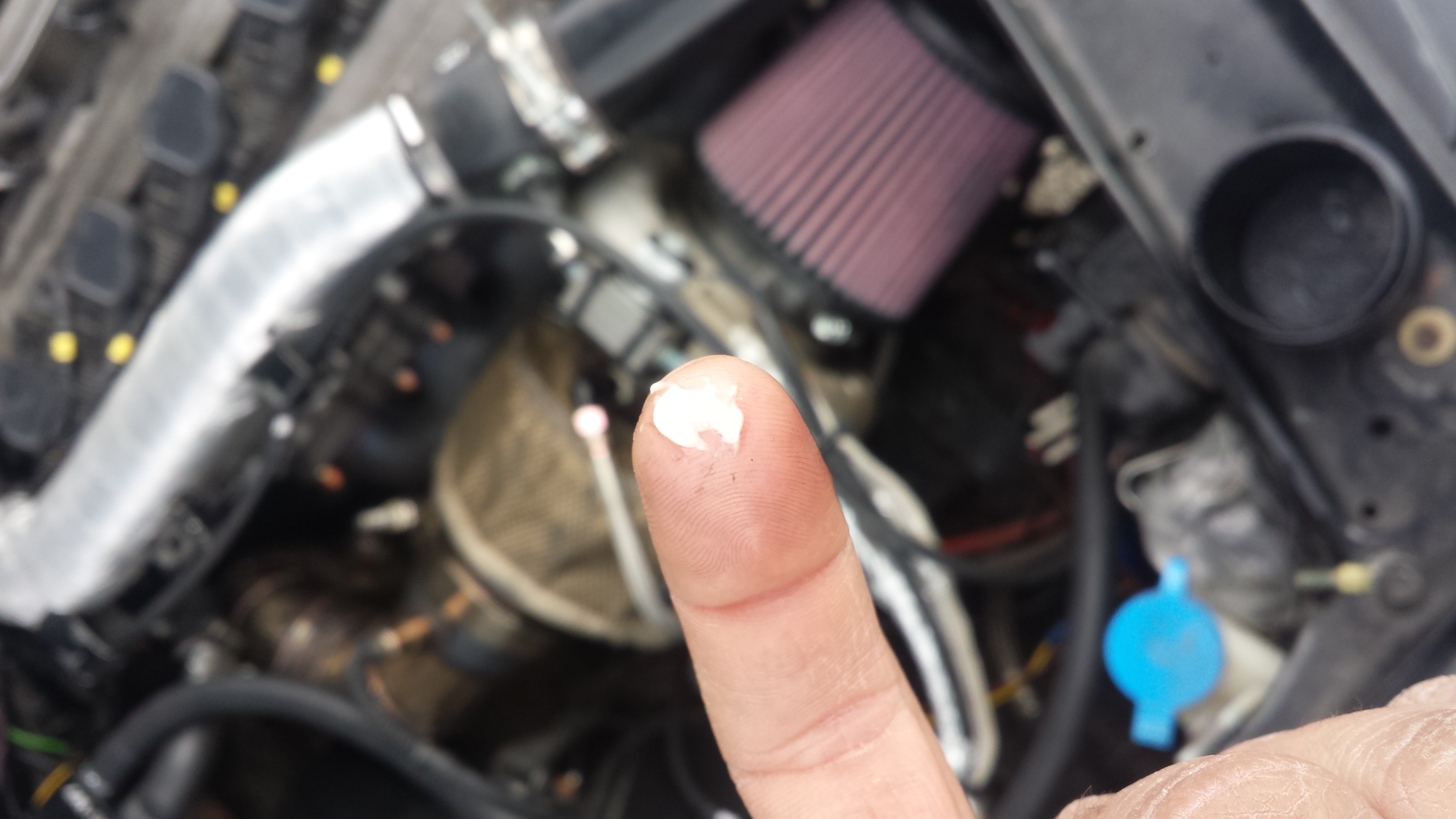

Also I found chicken fat in my CC :lol:

It's just moisture. Not worried about it. I added SS wool to the CC to keep it down in the can and out of the air stream. It's really more of a mayonnaise and there's not a ton of it. Good lookin out tho!

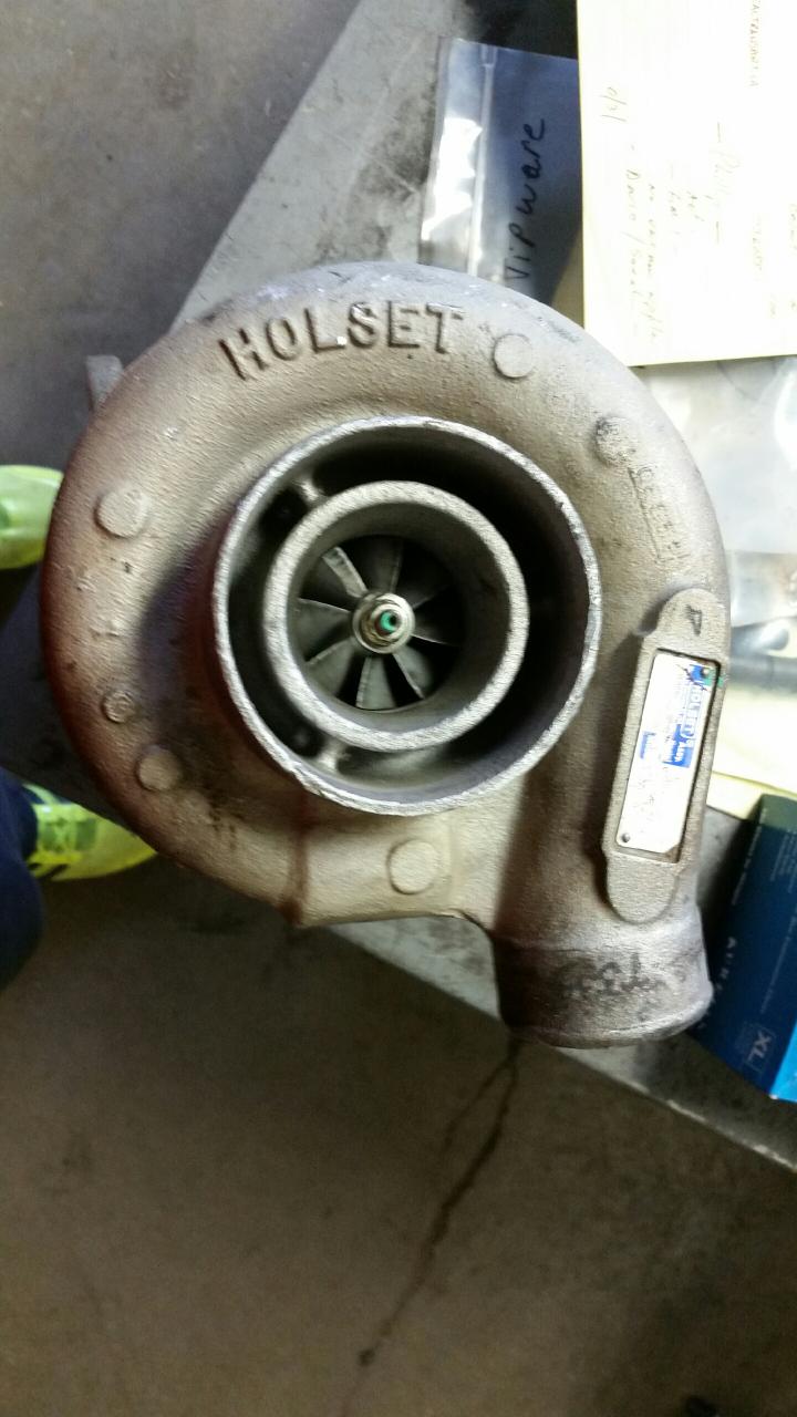

Sucks that it isn't loud. I imagine it has the anti surge groove cut out (some have the ports but not the groove).

Ok so I have the ports but they don't go through the front of the compressor housing. It's like a ricer attempt at an anti surge housing. "Functionless"
I did hear something sounding like surge earlier when the bpv was operating. Sounded badass but idk if it was surge or not. Maybe I wasn't listening hard enough while focusing on the gauges

You sure the groove isn't there? Is like a snap ring groove in the bore of the comp housing.

I will check after work but all I have is this shot of the front of the housing. When I had it off to clean I noticed there were no machined opening on the inside that would lead to the anti surge area on the front.
