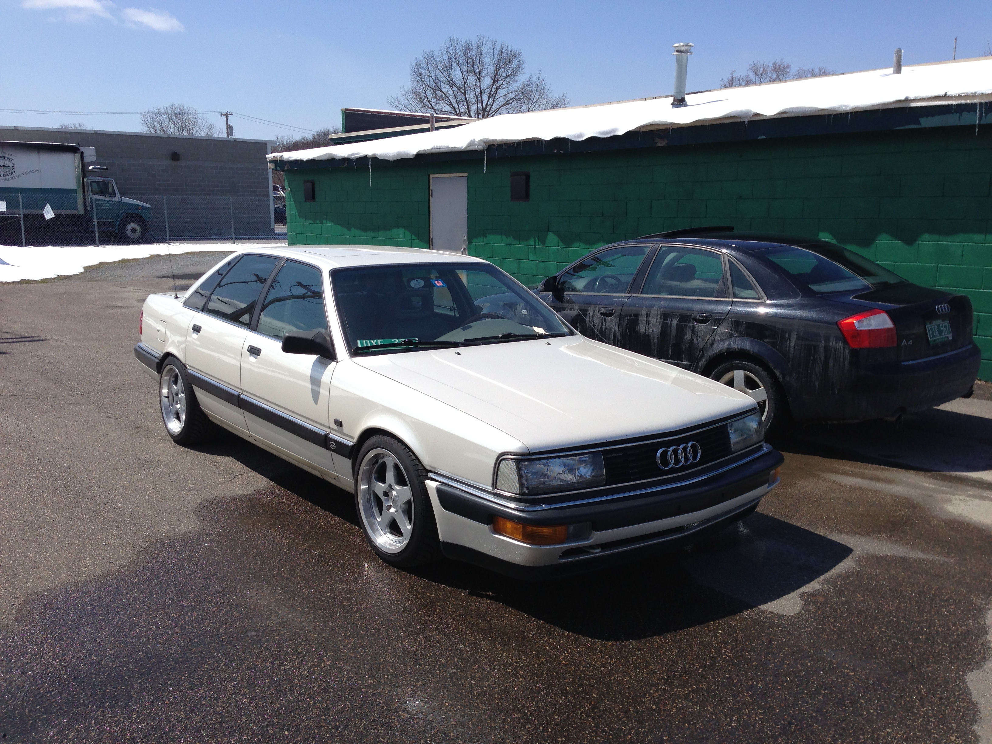

I hope so! Just need to figure out what it needs before the trip.loxxrider wrote:Right in time for Carlisle

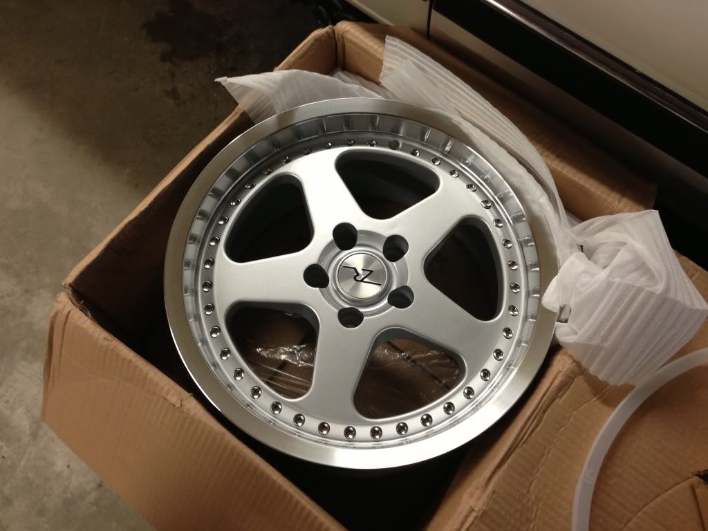

I'm somewhat ashamed to say they are Saleen Motorsport Replica wheels. They are 5x114.3, 17x9 et 24 wearing 225/45 tires.Quattro20v wrote:What wheels are those? Nice car BTW.

Good to hear it's back in action! So um, any idea on how much those weigh? I need to replace a bent wheel and after seeing these I might be buying 4 new ones

My current predicament is choosing between those wheels and some LM Replicas.

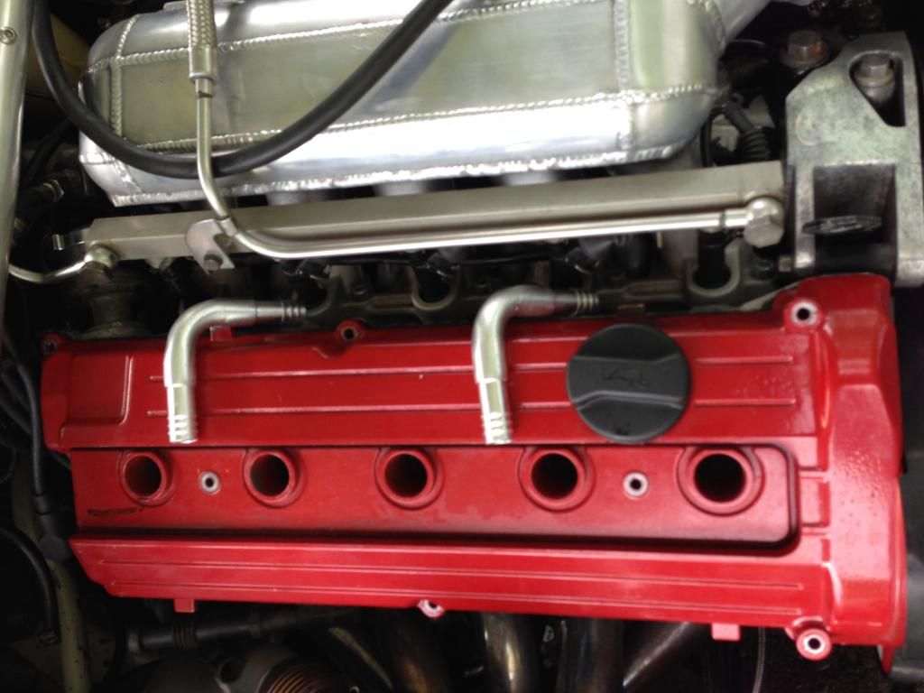

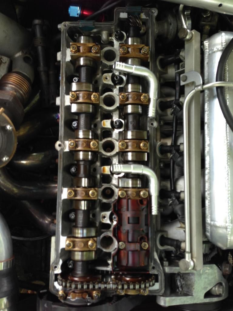

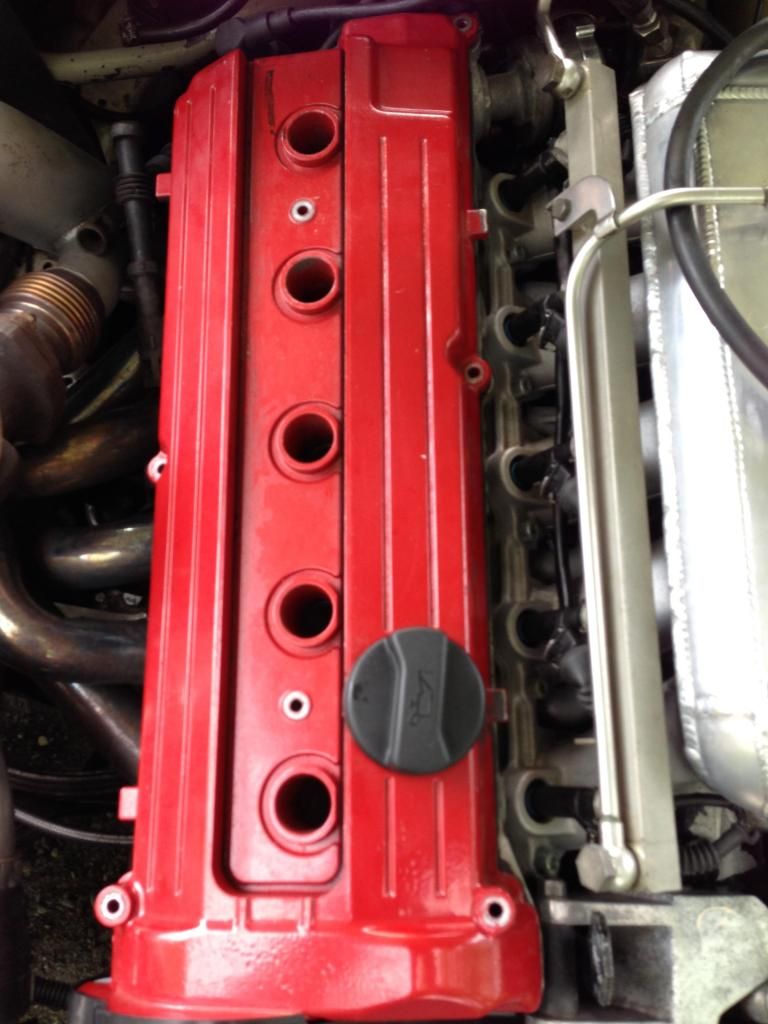

UPDATE!

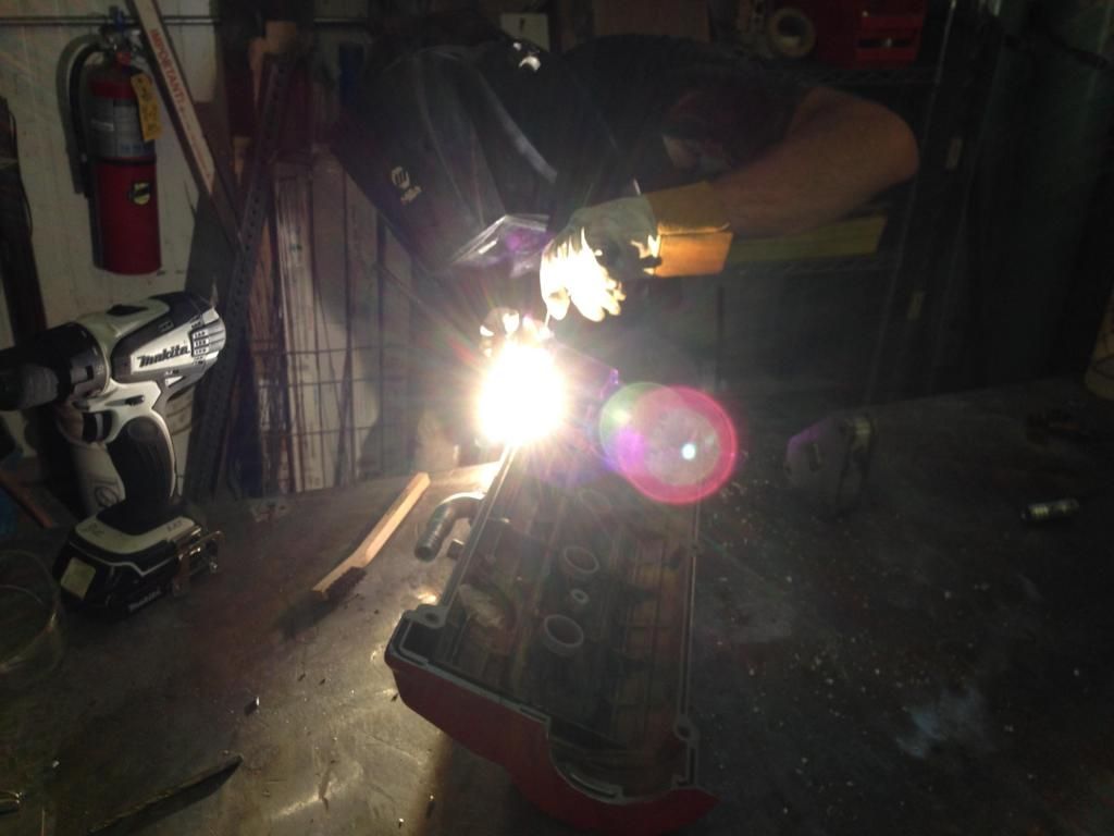

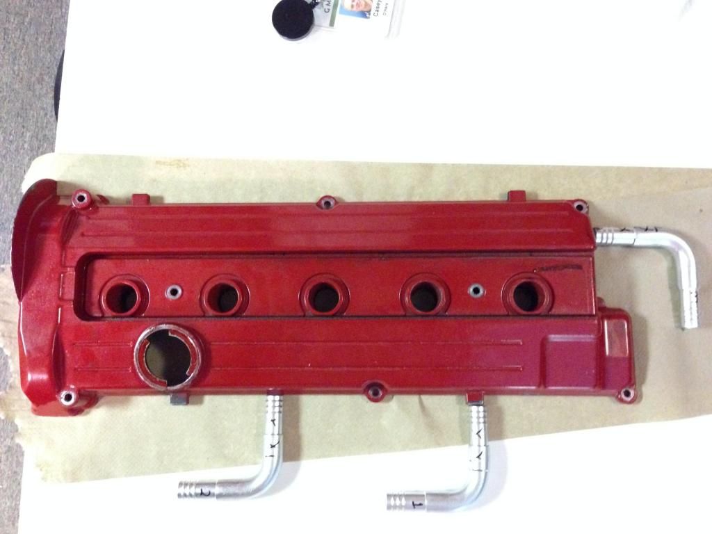

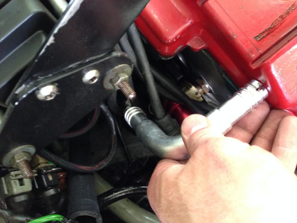

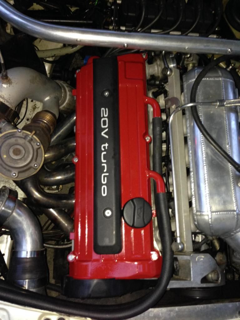

The 200 has been sitting on the sidelines as I have been trying to sort out how to drive the car on boost without ejecting all of the oil out of the crank case vent. Here's what I came up with and it's the best setup I've had so far (still need to do compression/leakdown to check the engine's health)
It's using 3 1/2" ID Aluminum elbows meant for splicing air conditioning systems and I picked them up off of ebay for something like $12 shipped. No expensive AN fittings!
The crank case vent is plumbed into the back of the VC and I'm pulling 2 lines from the opposite side between cam lobes. I have both lines routed to a empty oil quart bottle temporarily so that I could see what kind of blow by I'm dealing with. There is still blowby but for the first time I'm not leaking out of the VC gasket, rear main, or coating my engine bay in oil Drove for ~6 hours this weekend with the car show and had probably a total of 3" accumulation which is still a lot, but I think with a drain I'll be ok.
The concept
Rotated the injectors to make space for the new plumbing
Then it was time for some welding
Some paint
Installed
The concept
Some paint
Installed

Nice. I have the same vc and I've been thinking about ccv. Interesting routing for the cc vent into the vc. I never thought of that.
My setup is one 1" line from ccv to 034 catch can and a drain back to the pan, without the drain the catch can would fill up not because of pressure and oil basically covering the ccv and shooting into it. It would blow out the top of the catch can! Ideally when I take the vc off to repaint I think I'll do it the way you have, kind of
ccv into back of head and two big lines coming off the vc into the catch can with the drain back.

Yea I need to pull my pan off or just the extension and put a drain in. I have the metal breather pipe on the crank vent and then a 3/4" hose from that pipe to the valve cover. those are 5/8" ID hoses to the catch can. I wanted dual 3/4" to the can, but I didn't check that these 3/4" elbows were 3/4" OD or ID. Turns out its OD :(

Nice job at wolfsgart. And very slick work with the vc venting. I'll have to address PCV stuff soon seeing as mine is not up to snuff and I see seepage at the VC often.
Re: Casey's 200 20v: Back in Action!!
Nice VC solution. No problems with oil on the "low" side of the engine where you have that crank case vent routed into the vc?
