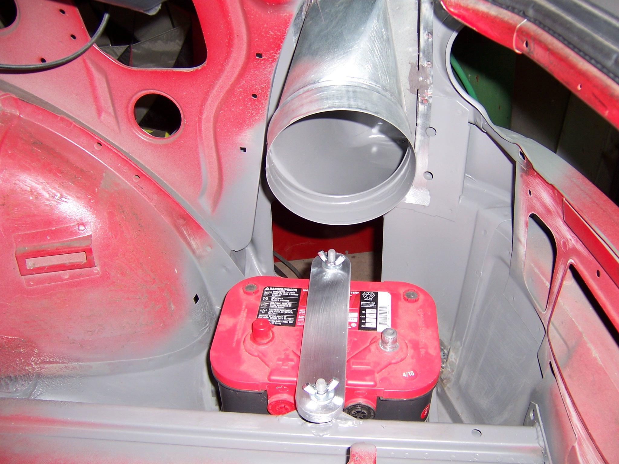

Get out of my head please. Other than "More boost solves any weight gain" my thought exactly: There is no way to get 50:50 but I am gunning for 47-48:50. Moving battery is worth 1 to 1.5% my rad. plus the water it holds is maybe another .5% so hopefully I be looking at 2%.

Thanks Mcstiff , that site I was not familiar with, lots of cool stuff.

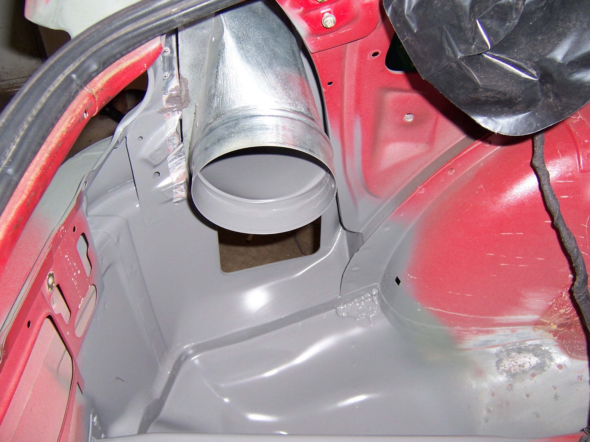

Small update:

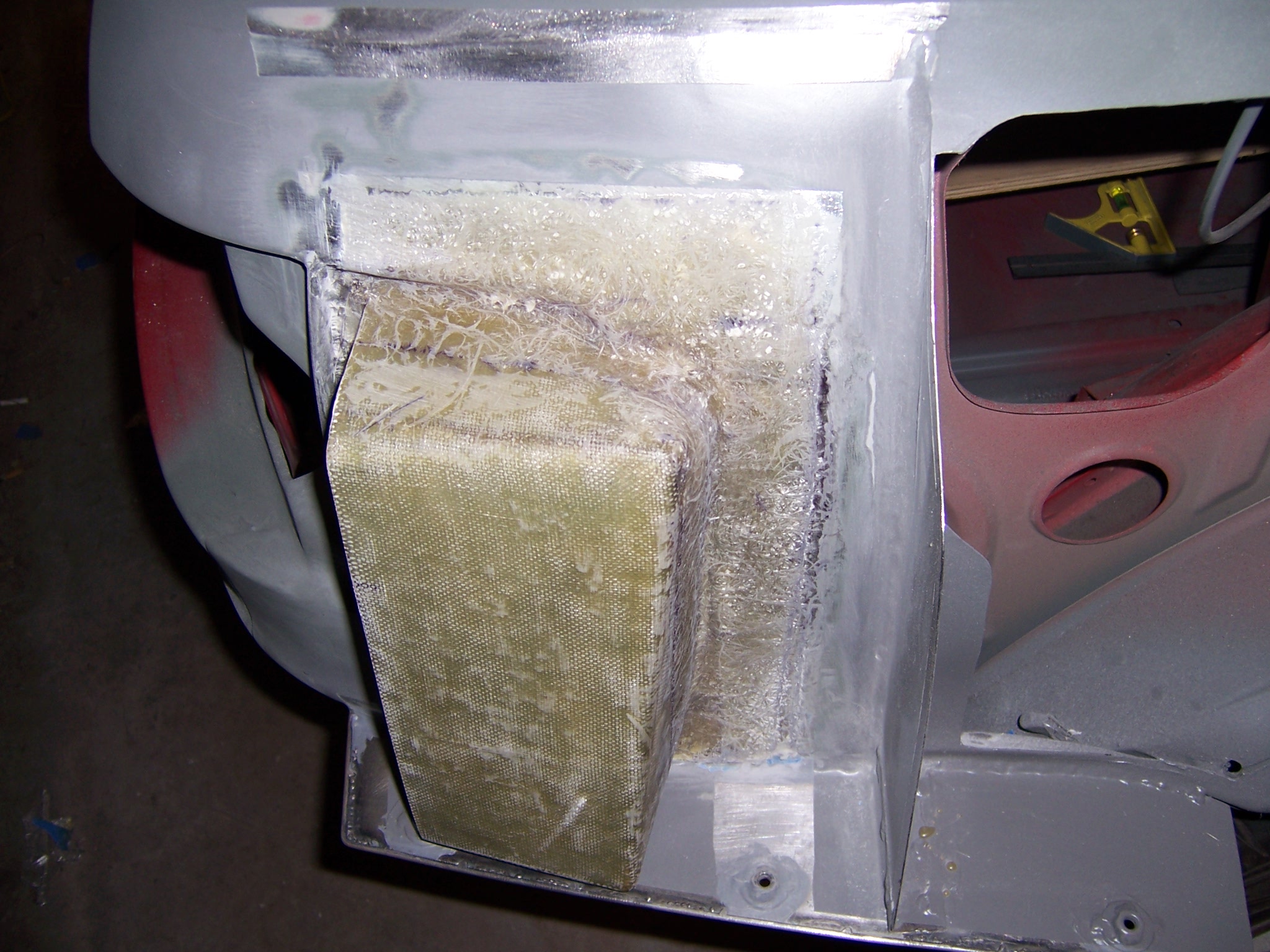

Side rad outlets are glued in place, needing to be fiber glassed.
Other side with batt hold down complete
Look from outside
More pics as I get more done!!!!!!!!!!

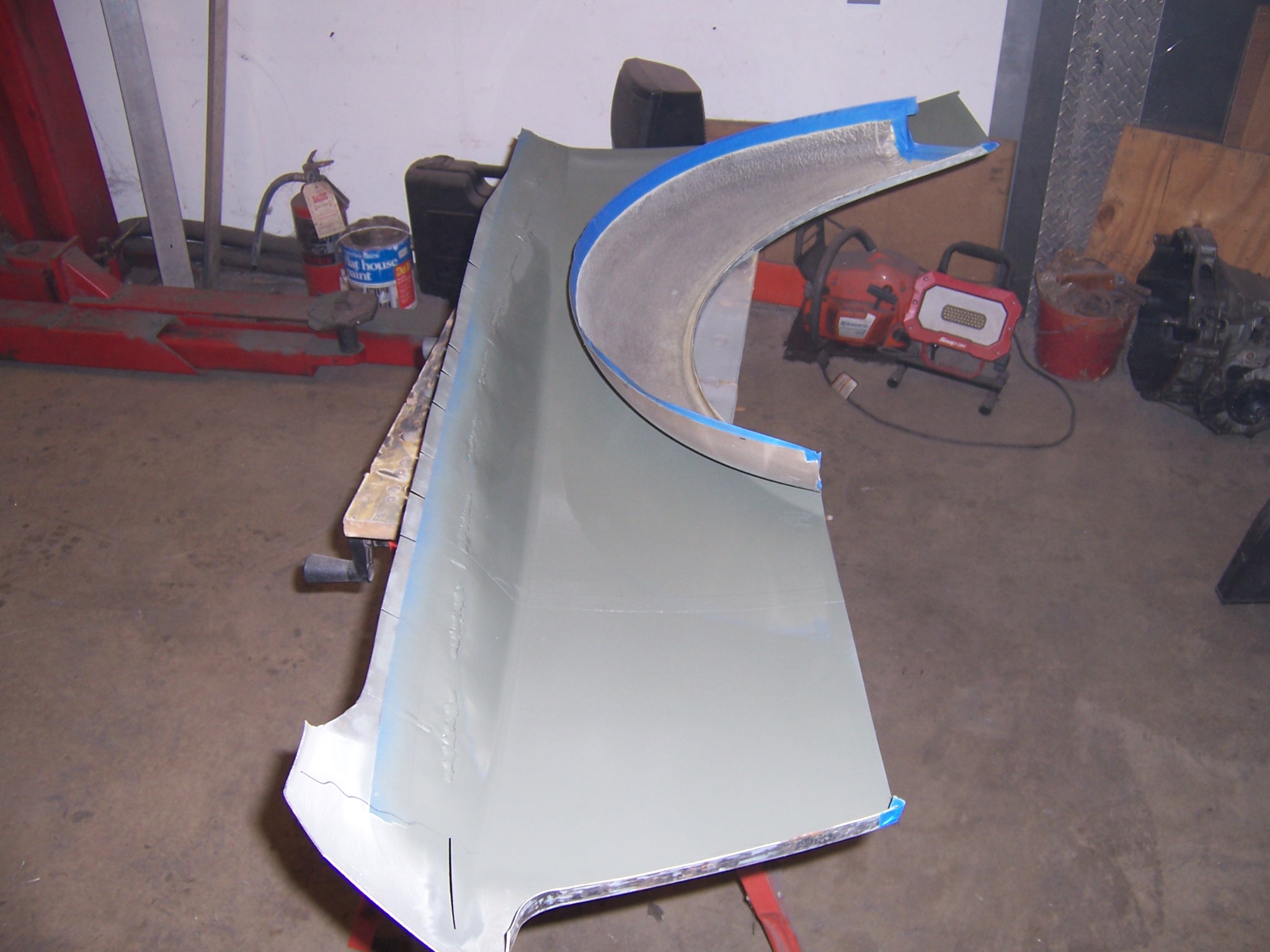

Fiber glassing almost done ,need one more coat of resin and then prime and paint.
I did learn a lot doing fiber glassing for the first time. Also been prepping the rear quarters for prime ,paint and welding. More paint drying torture in my future. :zzz:

Seam sealed and one coat of primer.
Rear fenders are getting primed on the inside as well.
More prime and paint ,a couple of test fits and the rear of my car will no longer have Gaping Holes. Well of course they still need welding to the car.

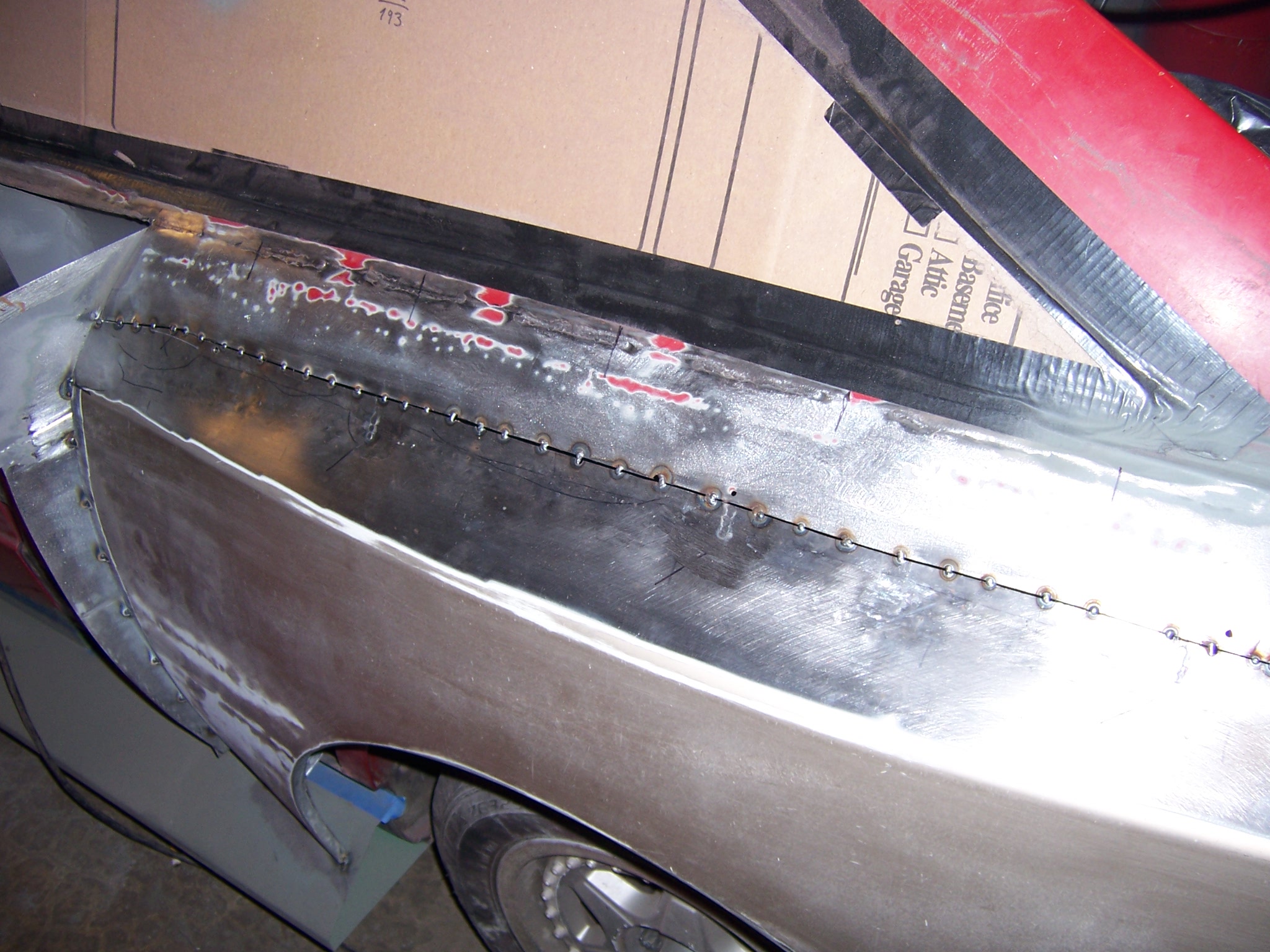

After watching paint dry again. :bangshead: ( at 50 degrees in the garage ) Lined up the fenders.
Then cutting and stitching . FENDERS ON. Both sides are tacked in place with just a little patch panel left to fab and then final welding.

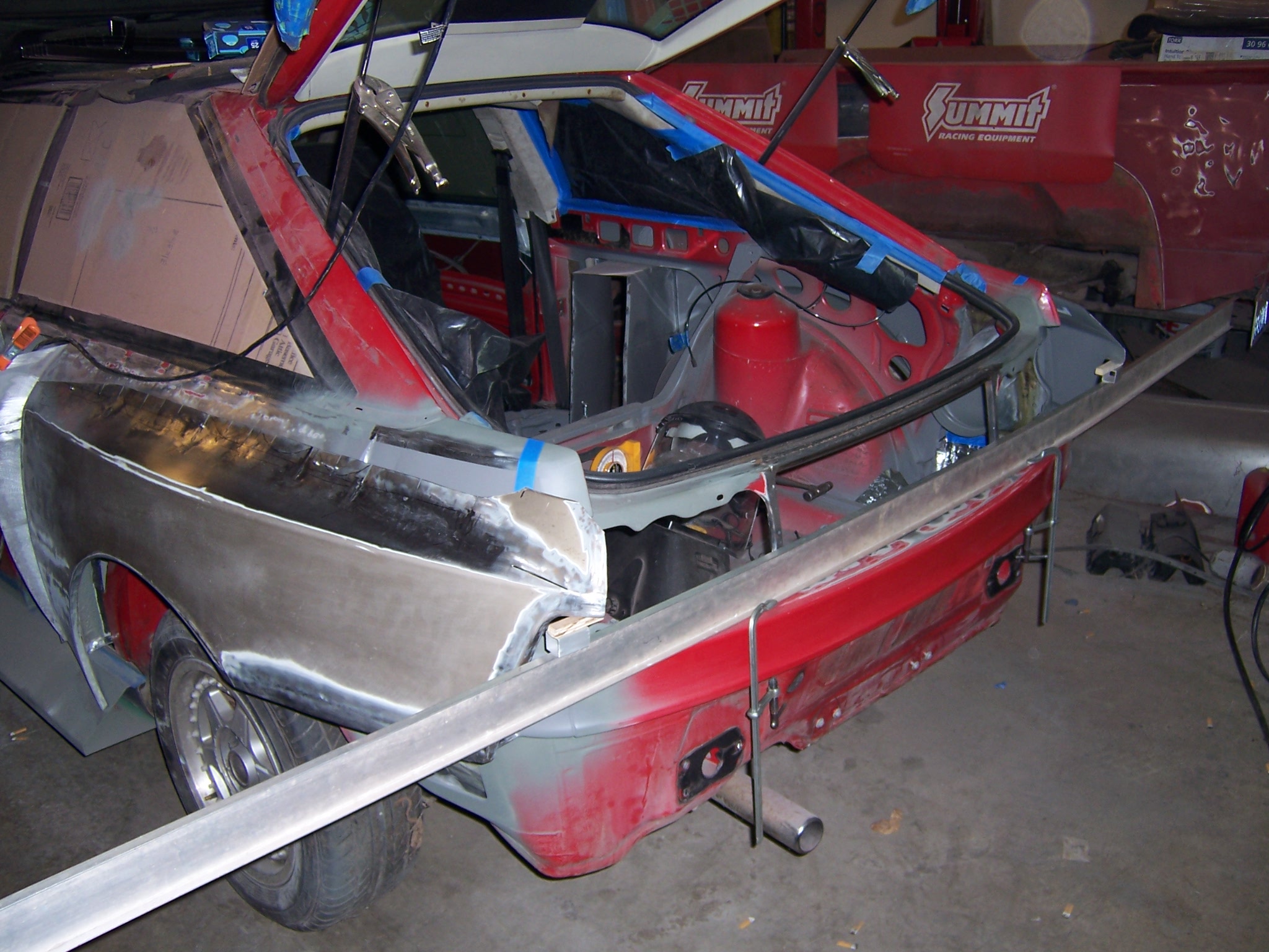

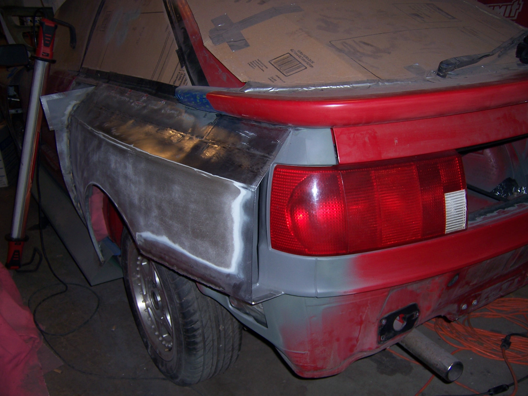

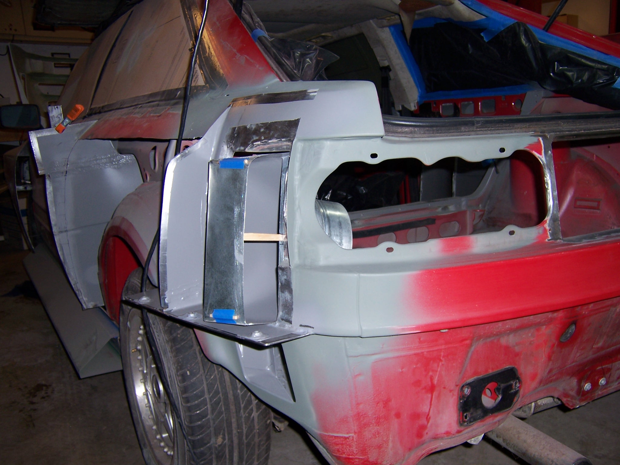

More stuff got done.
Rear fender RAD outlets cut in after welding fenders to the car.
Rear view.
Side.
Wire frames for the outlets are already made. They just need to get placed and welded in.
Tire off to bed.

Have been shaping these for a while.
Funny, my original thought/design of returning the rear fender to the body with a grill would look better than the scoop.
But I keep telling myself " Function over Form " :idunno:
Mike

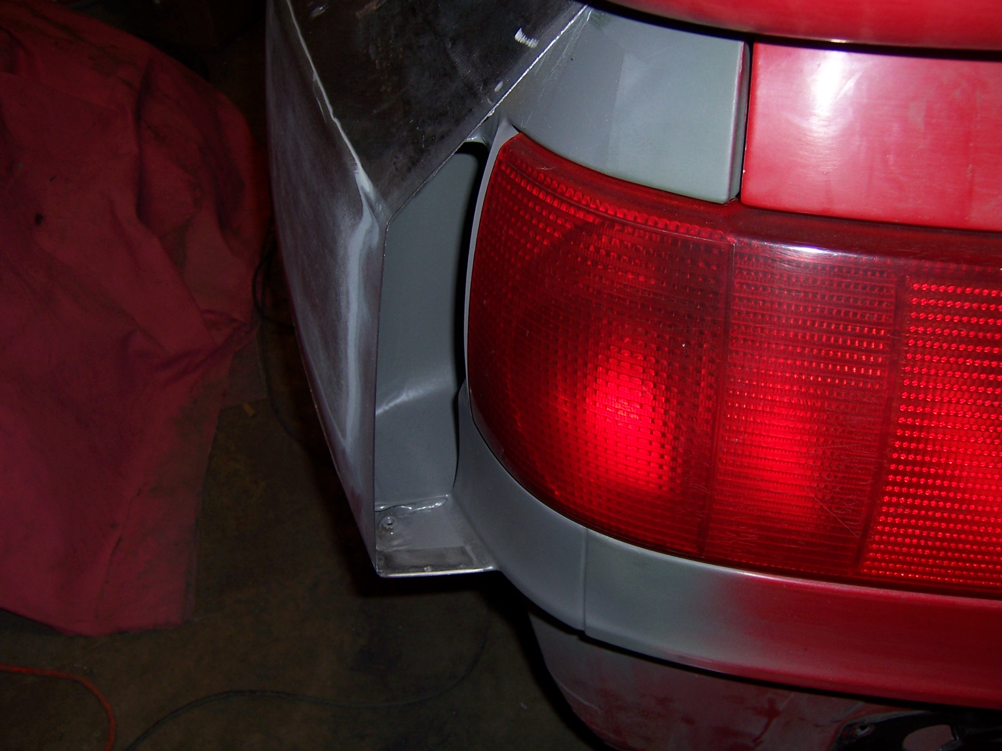

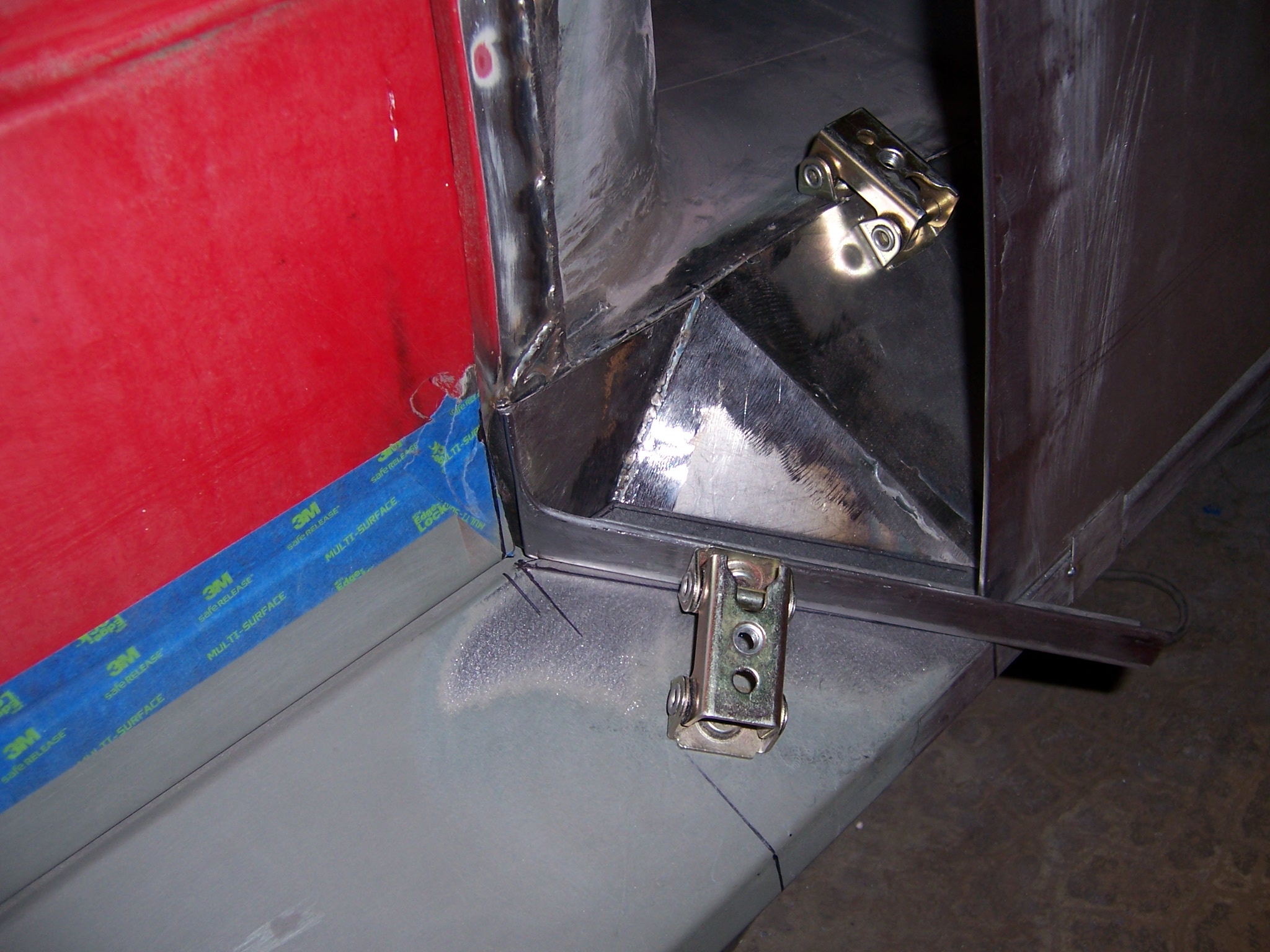

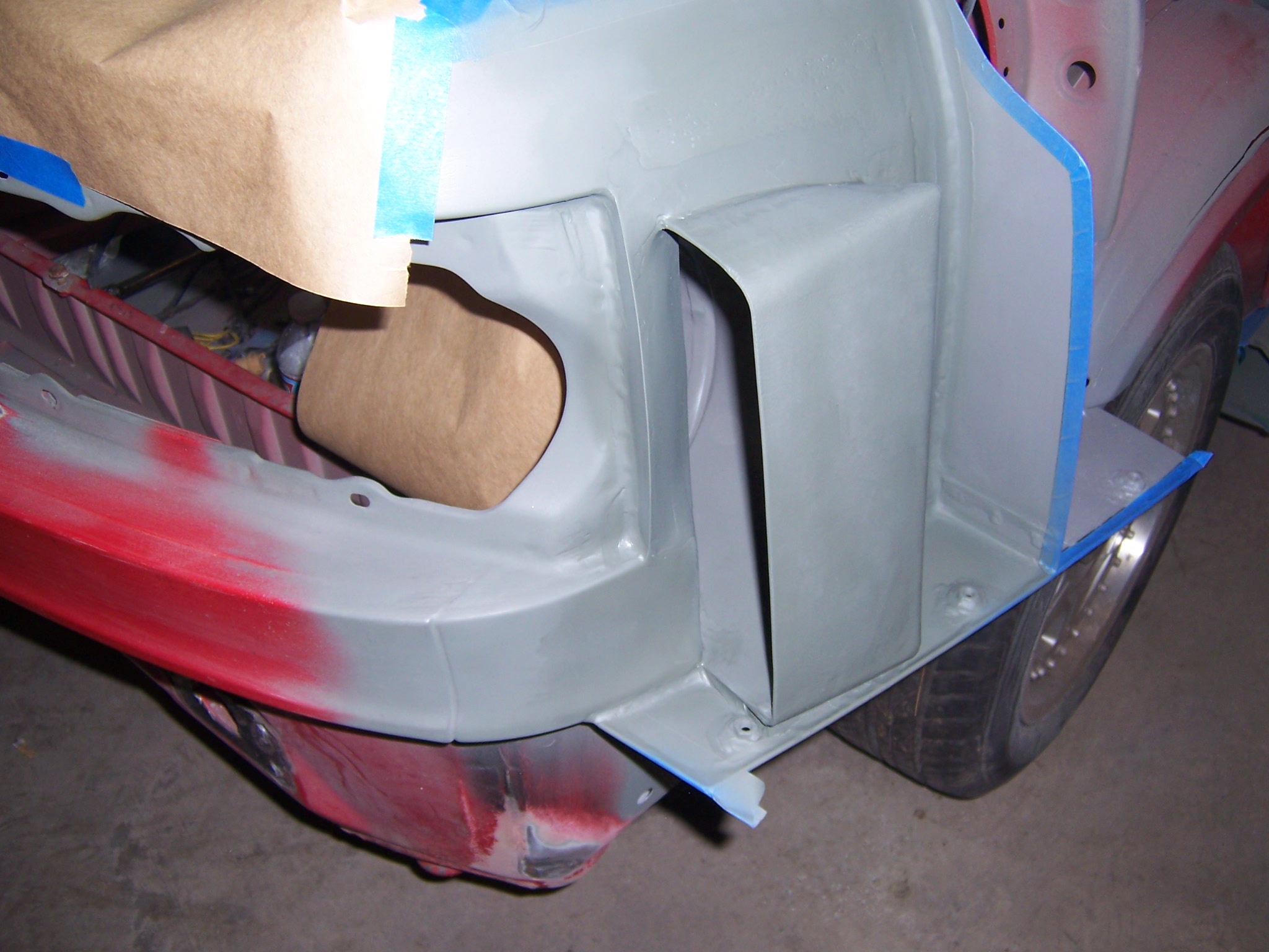

So the front of the Rad air intake needed a transition (see pic. above). Made one of these for each side. (Still needs to get cut flush with the rocker)
Side panel on pass. side cut and fit. Have to do the other side yet and then prime/paint and then weld the panels permanently.
Getting there......
Mike

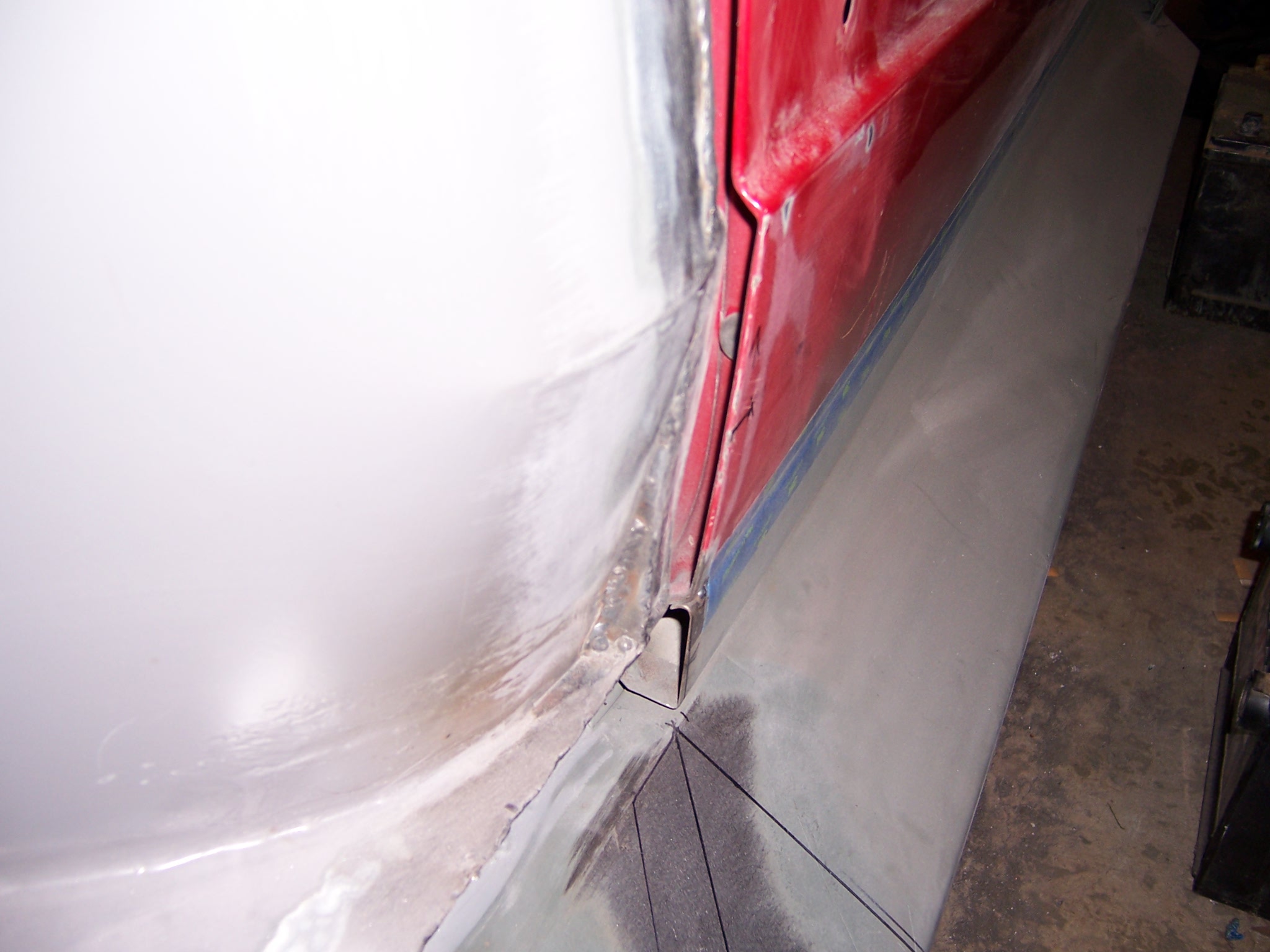

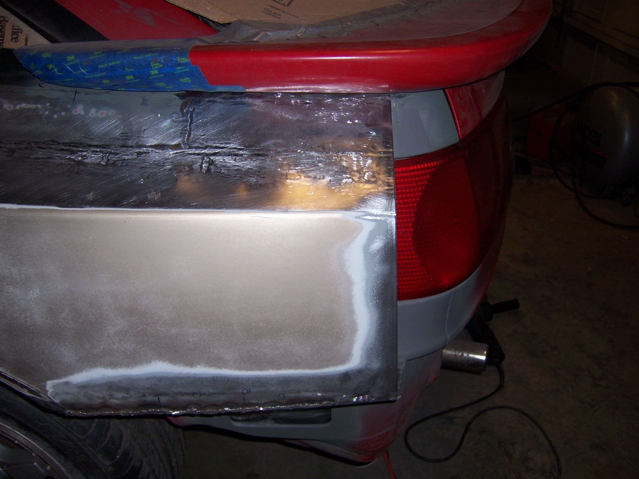

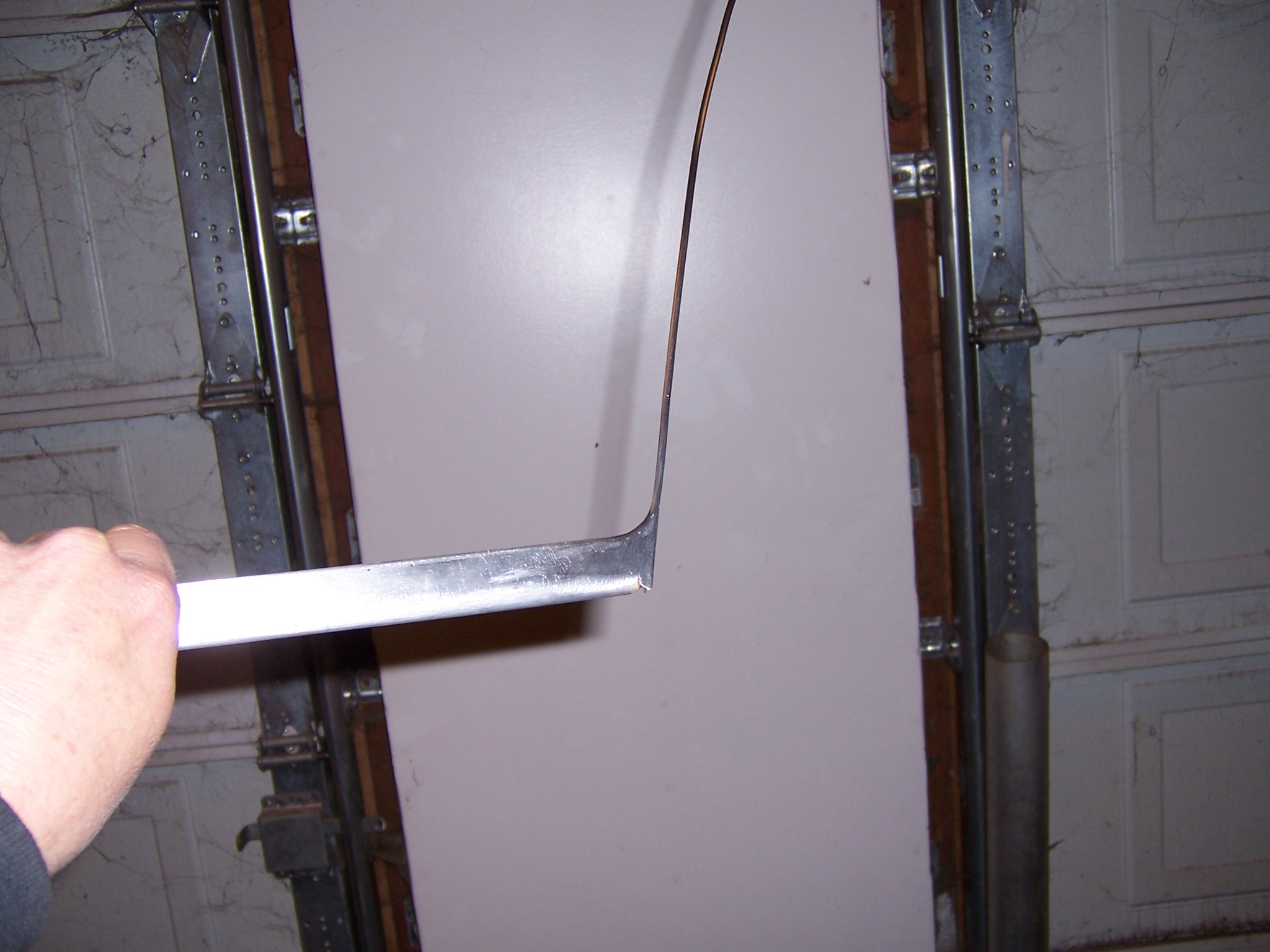

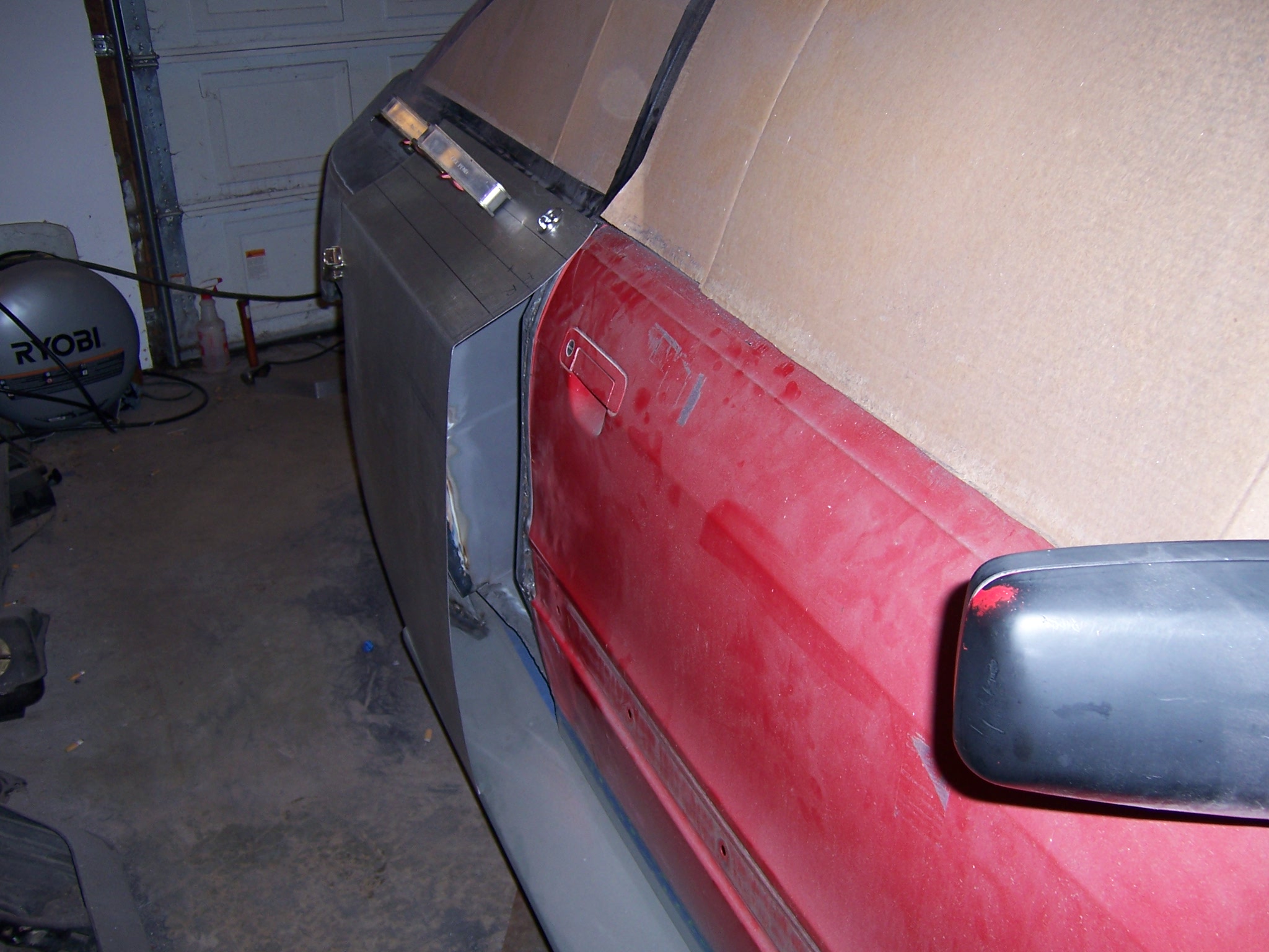

Bottom of Rad intake closure pieces are made and have radius on uphill side. Still need radius on downhill side. This piece is for the passenger side and the wire is longer than the other, as the pass. side was hit in that area and the wire reestablishes the body line.
Area that was hit. So one part was pushed in and the door edge was pushed out, that required some brutal hammer blows to straighten. You can see the area that needs a new bodyline.
Other side mocked up. On this side the wire is quite a bit shorter as all the sheet metal meets nicely.
Still have two more transition pieces to make for the side of the Rad intake. Need to get those done before paint and final welding.
